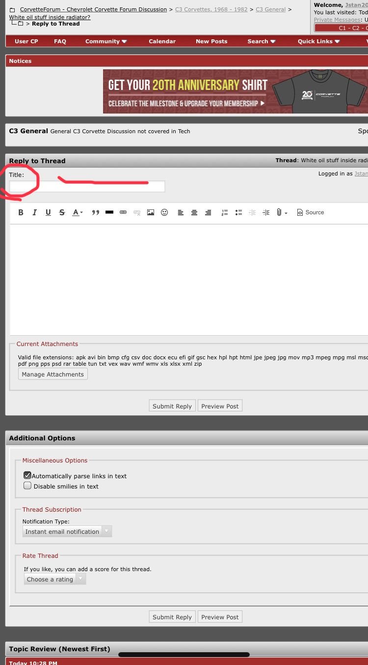

Ed, the title to your thread is a thread title. It describes what topic you wish to discuss or the topic in which you need help. See photo highlighted in red for the location.
You have “ed willians” in the title block.
