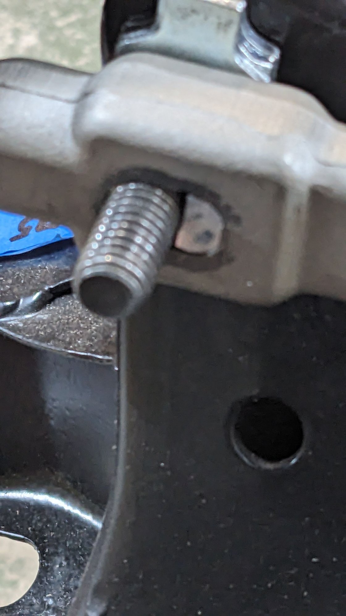

I did some fabricating yesterday also.

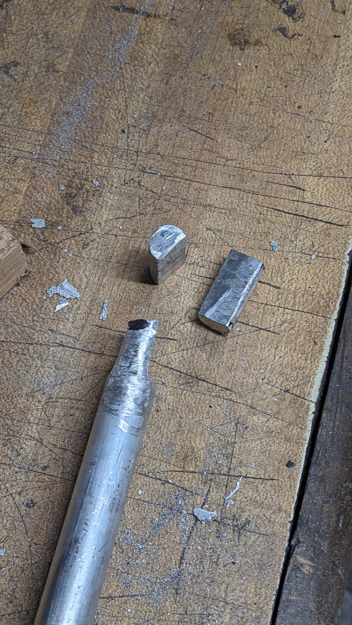

Very productive day. I did not want my front caster changing because of the 1/4" slots I made in my control arms. Now that I know the alignment works the way I want, I 'locked" in the caster setting on the rearward shifted stock a-arms by making some aluminum spacers. Saw something similar on some circle track stuff. Now the stud can't shift in the slot or move the 5 degree caster setting.
Here is the slot in my a-arm shaft. The slug fits pretty snug in there, and the nut will hold it in. The a-arm moved once 2 mm while I was measuring without these, and I did not know it until I went back in to measure for these. Who knows what would happen without them on some bumps.
Spent some time on the grinder. 0.5" aluminum rod. Now 10.8mm round then a 6.8mm flat. 20 mm deep. I made four of these.
