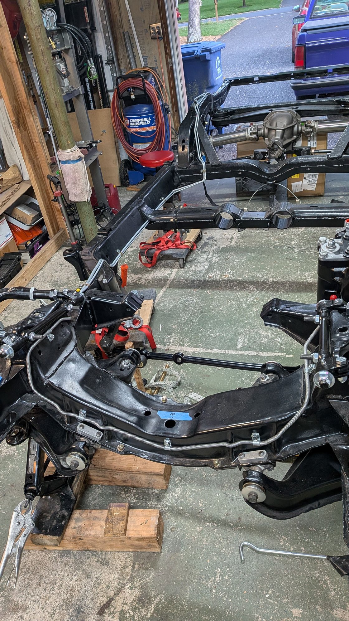

In the meantime I did get some of the fuel lines run.
Bending them straight again was quite a challenge.
One had 3 u-turns to fit into the box.
Tag suggestion to unbend "this section" on a straight surface turned out to work well and get 90% of it un-bent.

The lines look really nice.
I also panicked a bit when mine arrived and I saw those 180 degree bends in the box.
Thank goodness for videos and instructions.
