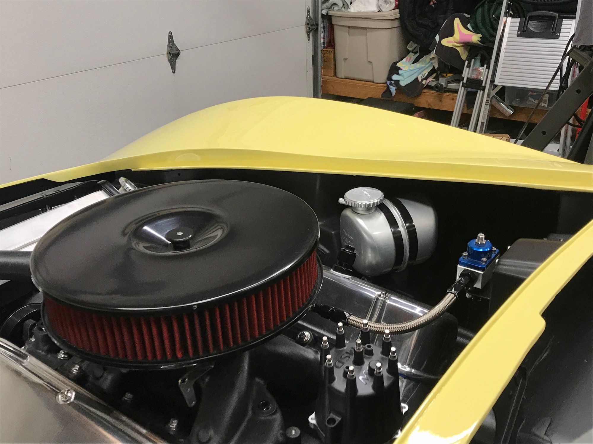

The 73 model year Corvettes had a radiator cap on the radiator and so do the DeWitts 73 and later model year radiators.
73’ Corvettes had a plastic non pressurized overflow reservoir which I replaced with a DeWitts early model year Corvette expansion tank.
DeWitts custom made it per my request and they offer them as a custom order that isn’t shown on their website.
The radiator cap on my radiator is pressurized however my DeWitts overflow reservoir has a non pressurized cap on it and has no pressure.
My reservoir looks exactly like an early model expansion tank but functions like a non pressurized overflow reservoir.
Heres a couple pictures.

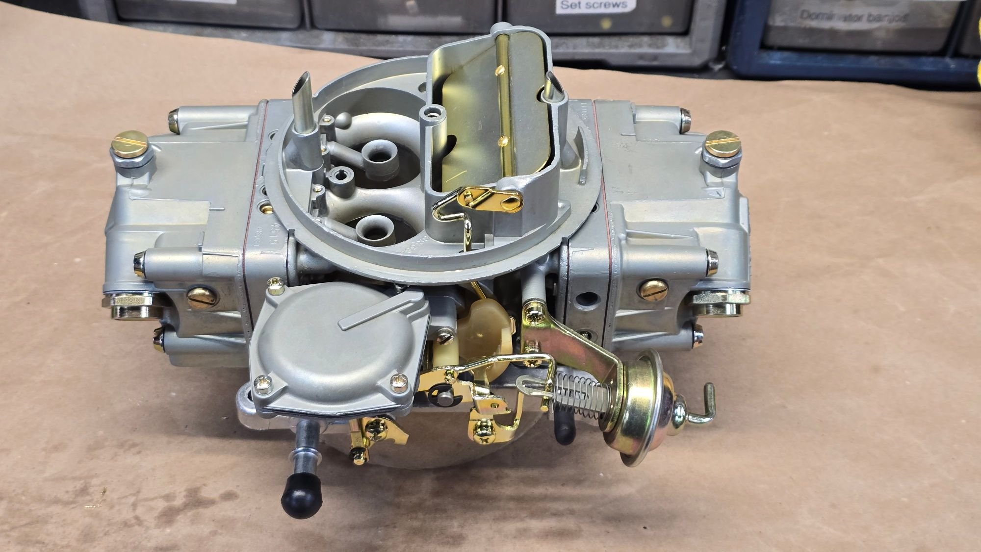

I picked up some more jewelry for the car this week:
Now it works better and looks better!
All replated and dipped...looks much better than before.
This is the "before" cosmetics. Just as it came off the engine after the dyno run...ran very well...but old & ugly
Can you see the tuning mod I had added? Adjustable air bleeds...but nearly invisible.
An adjustable air bleed, very small hex screws, nearly invisible. Unless you look really close.
Here is my tuning kit. Darius measured all the original bleeds, and duplicated them in the screw in versions, then gave me a couple steps rich & lean for each bleed.
Darius at T4 Carbs hooked me up
https://t4carburetors.com/
This is an original LS6 Holley, but an 1978 OTC one, not a rare original. For a LS6 crate motor.
I chose it because all the linkage and the jetting hooks up as stock with no fuss.
Starting with this carb got me a lot closer to ideal than starting with an out of the box Holley.
But now it is infinitely tuneable.
My dyno man said the AFR, on the Dyno, was one of the best & flattest curves he had ever seen on a Holley. At W.O.T.
But at cruise it was still a little rich, and it would really suck down some gas at cruise.
So now it has fully adjustable screw-in air bleeds, idle fuel restrictors, and power valve restrictors.
The WOT was tuned on the dyno, and I will tune the part throttle on the highway with an LM1 wideband AFR meter.
With my TKX 5spd, 70 mph cruise will be a low 2000rpm. The carb should still be on the idle transition circuit, not the main jets.
Now I can lean that idle transition circuit out a little. They were 13.2 AFR on the dyno at light load. I will be looking for at least 14.7 at cruise or even 15.5, if it will do it, without stuttering-misfiring.
That's 17% less fuel, and likely 2-3 more mpg, just from leaning it out at cruise.
This part throttle tuning can not be done on a static dyno. Maybe a drive-on version, but it would be a slow and expensive process with a carb.
I'll do it on the street.
I will not need to touch the rest of the WOT jetting. That was done on the dyno. I may need to touch up some transitions.
My ultimate goal is to get it up to at least 15, maybe 18mpg, so it is at least tolerable on a 1000 mile road trip.

Very nice looking and set up carb!

VERY PRETTY....................sad, just give it 30 days of use & it will look like it did prior in no time !!!
Should be Cadmium / dichromate coating, curious why is it silver ? Especially the diaphragm cover that sticks out & is most visible ?

Leigh that is awesome. I did that to my tripower setup and it makes a world a difference when you have an AFR gauge to help tune. I hope you hit your 15 to 18 mpg goal. My best was 16 mpg with my Holley Qjet. That was my simpler carburation days
