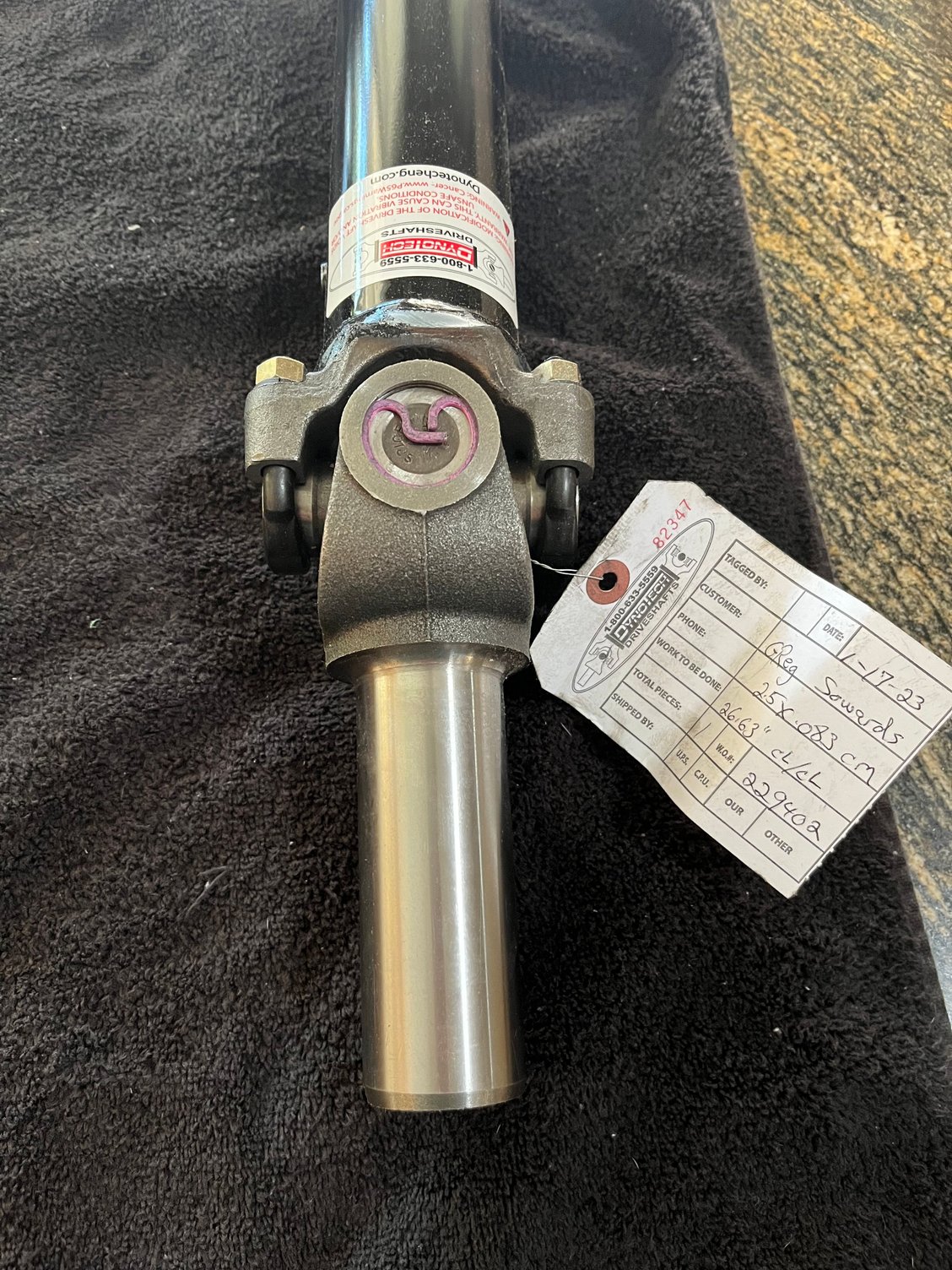

I have a current thread going right now titled “Transmission Tunnel Mods for 1330 U Joints”, which has some good discussions you may want to read.
I also just ordered a new DynoTech, balanced chrome moly driveshaft built with a 1350 transmission slip yoke and Spicer solid u joints and 1330 differential solid Spicer u joints. $595.00
It adds some strength to the drivetrain and cheap insurance that nothing will come apart when I’m out on a nice weekend drive with the wife.

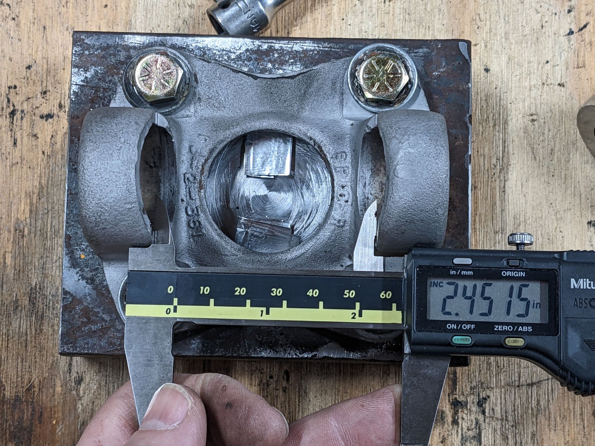

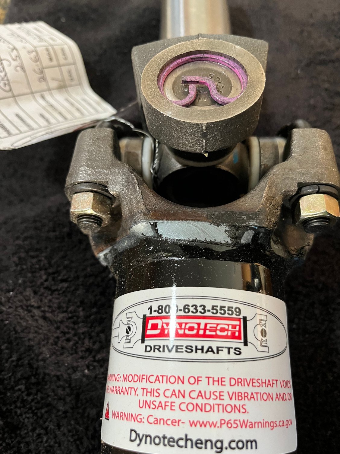

Just to finish up on the u-joint install, in case anyone needs some tips:
My 2 bent flanges measured 2.390" at the yellow arrows vs 2.450" for all the other flanges at the other 10 joints, and did not rotate smoothly. Because the flange bent "inwards" I knew it happened during installation of the u-joint caps. This inward bending is what convinced me I needed to use the flange tool.
The flange is very thin where the red arrow is. There is also a protrusion, that is why the flange tool needs a recess. The red arrow is where the flange MUST be supported during cap installation or it will bend again.
Here is a close up of the flange mounting tool. It needs a recess in the center. You already have this same shape on the axle shafts, and it is possible you could use that. But the tool is available on-line for only $40
This is how I installed the u-joints:
I placed everything in the vise like this.
Th caps must be removed to install. I prefer to install them horizontally like this to make absolutely sure the needles remain in place. The caps push in this far by thumb power. I made sure the u-joint crossbar slid in/out of the cap easliy.
So with the correct size socket (21mm) it only took some LIGHT TAPS from my brass hammer to set them far enough into the flange. But as light as those taps were, I would not be surprised if they would bend the flange if they were done WITHOUT the flange support.
The c-clips go in with needle nose pliers. Make sure the c-clips are inside the groove in 3 spots or they will come out. And then give a gentle tap from both sides to make sure the caps are centered & settled against the c-clips. The c-clips need to look the same on both sides. They actually protrude just slightly in the center when they are under pressure.
I would NEVER use a press on these things because they bend so easy. And my machine shop always uses a press and said they hate working on painted parts because they always get scratched.
So you can ABSOLUTELY do a better job at home, with hand tools, than the machine wants to bother with.
The remaining joint caps get lightly tapped in on a flat table, no special tools required except a 21mm socket and a hammer. The joints are snug but move with strong thumb pressure.
DONE!

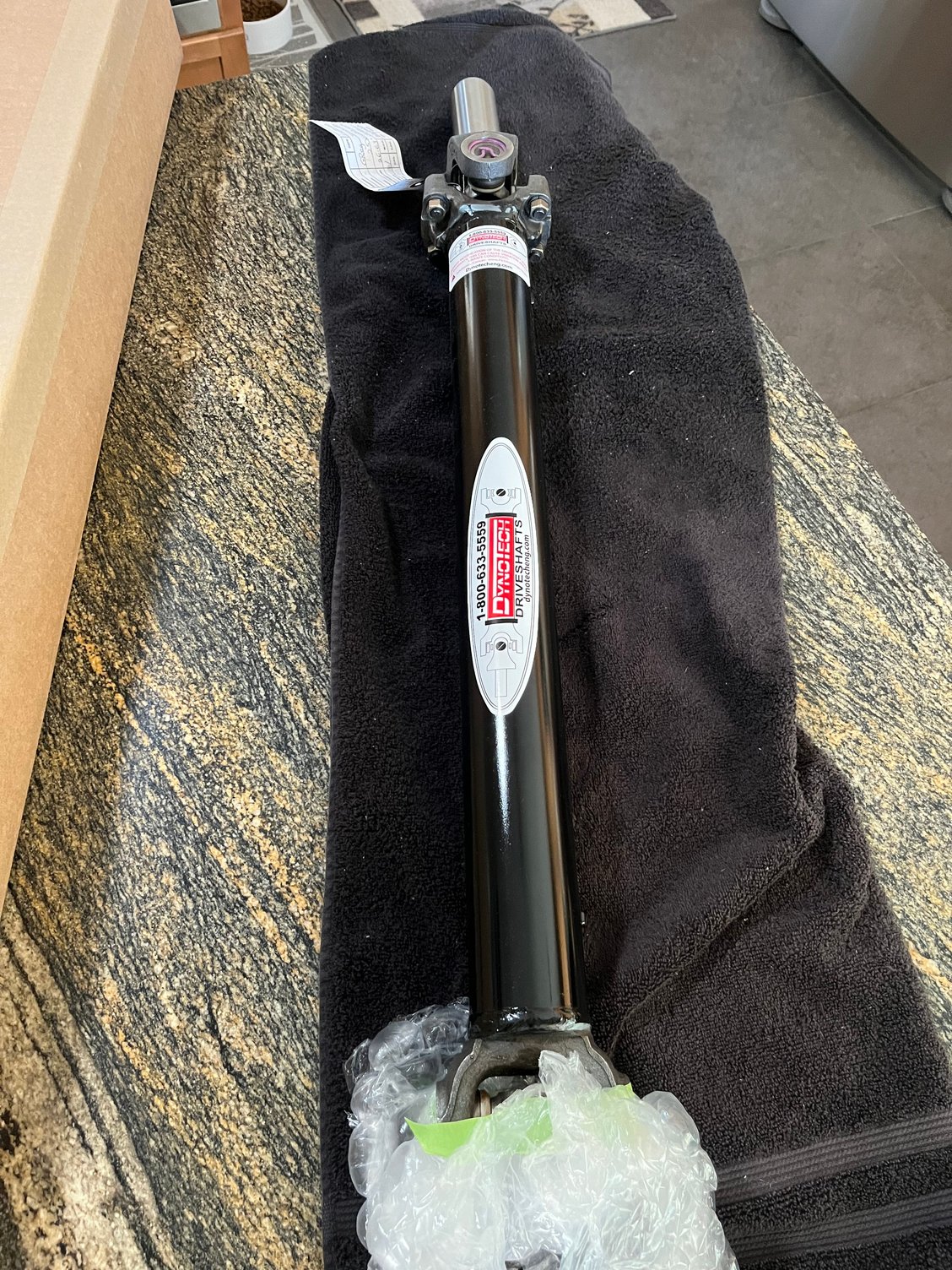

My new driveshaft should be delivered by FedEx today.
I’ll post you up a picture.

Just as I finished typing my last post, our pups started going off at the front door.
Very nice!

That looks great!
I am still trying to catch him on the phone to order a duplicate of that. Resorting to e-mail now. That means you got ahead of me!
Hmmm... but my motor and frame are already done and waiting. We'll see who's first! LOL
Let me know how it fits!

Oh boy!
It's like Christmas again today!
It looks so good.
And fresh leather smells so good also.
Leather wrap courtesy of Chuck Pelton online here.
He added a little padding too, it is 1.1" to 1.2" in grip diameter.
And it feels great!

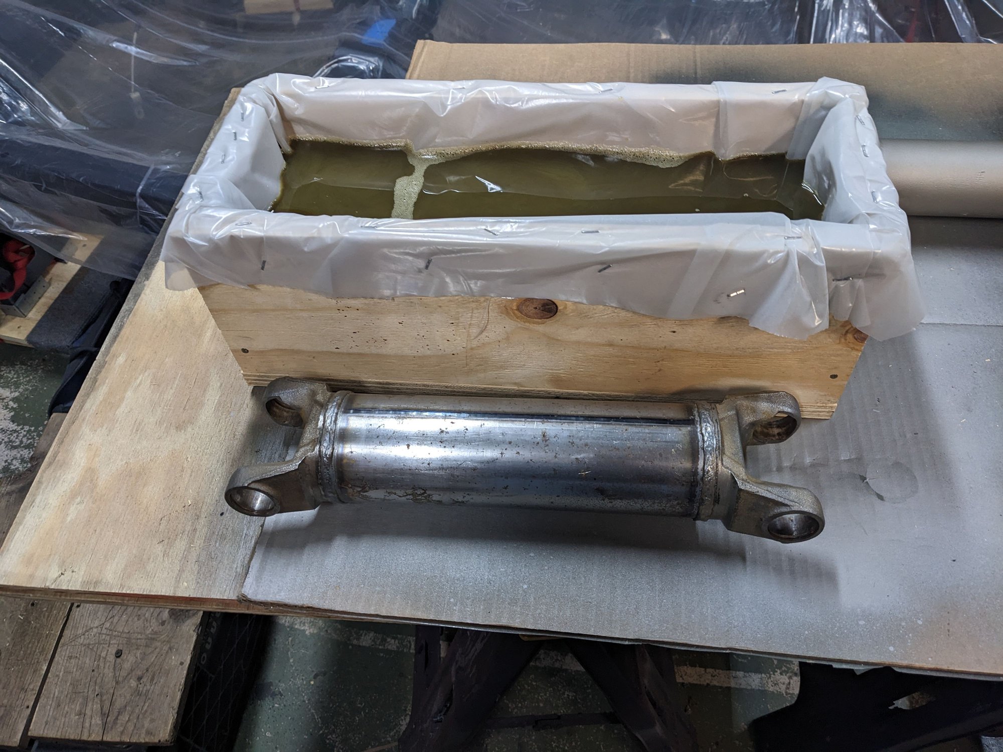

I will keep the 3" half shafts for my car.
That awful looking yellow paint was really tough and it would not even sandblast off, so I had to chemically strip them.
Well after that messy job, they came out looking almost brand new! That was some tough paint!
They only had a small amount of rust on them. But there are hardly any scratches in the shiney steel.
So that gave me another idea.
If I can get the last bit of rust off I think they would look just beautiful clear coated.
I had to build a little wood box to hold them submerged in 1-1/2 gallons of Evaporust.
What do you think?
