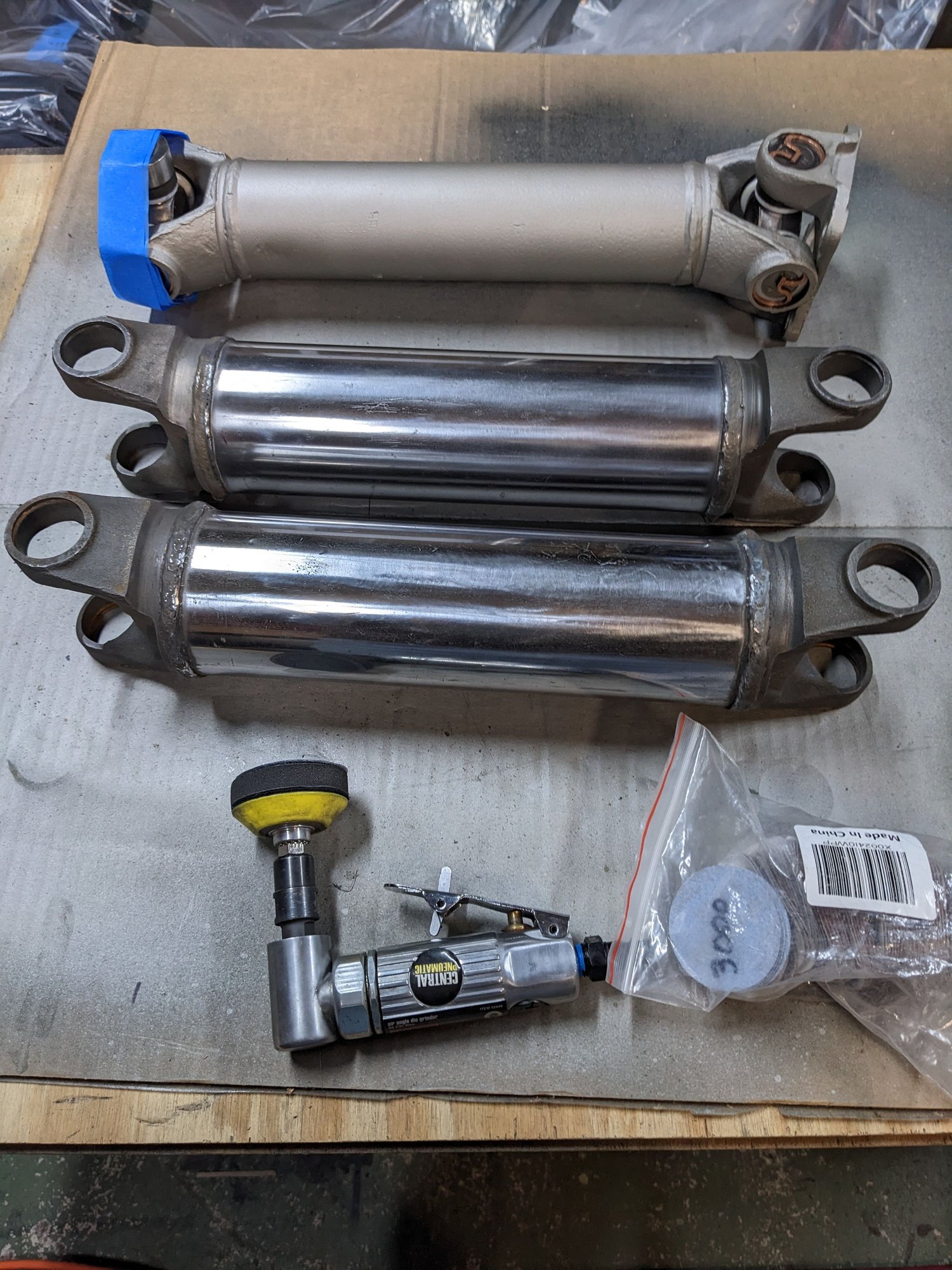

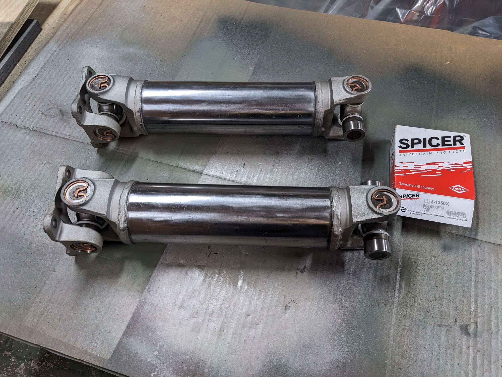

So after a couple of starts & delays, I finally got the half-shafts polished the way I want them to look.
  • I de-rusted them with evapo-rust, but that dulled the shiny surface
  • Tried Eastwood polishing compound, worked but very messy and hard to clean up clay like remains
  • Mini air tool sander worked the best. 1000/2000/3000 grit paper
Painted one vs polished. Painting ends and clear coating has commenced.

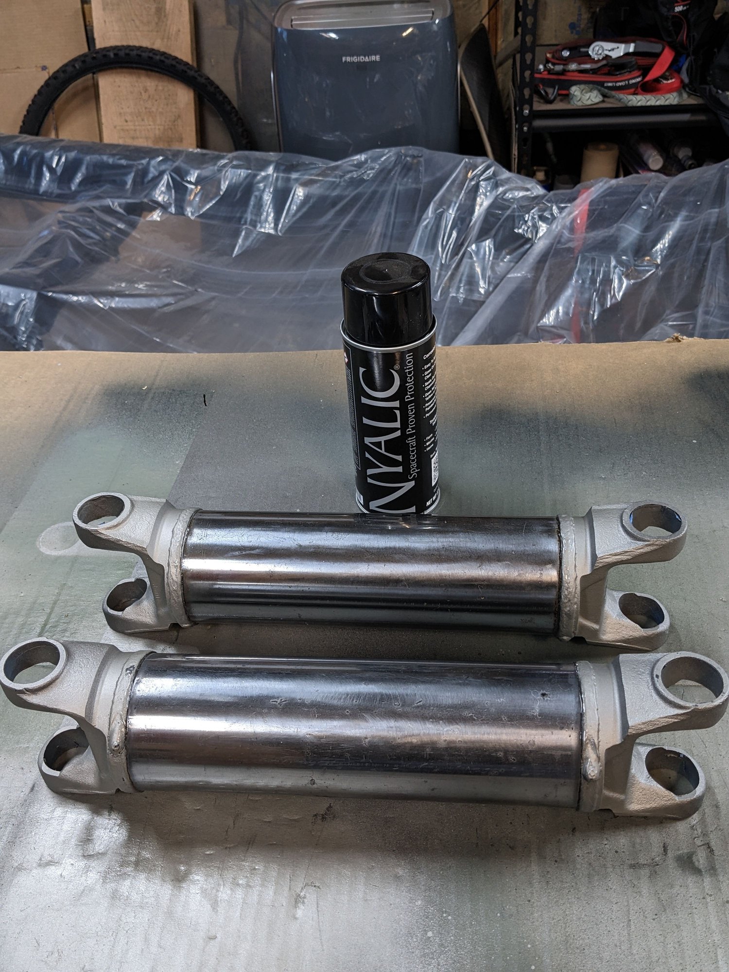

Here is how I coated the bare polished steel half-shafts. NYALIC.
I do not know if anyone else has ever tried this stuff, but it is not a clear coat paint. It is some kind of resin. Developed for NASA for corrosion protection. You get zero corrosion on bare steel. I used it on my polished BBS wheels 30+ years ago and my LT-1 aluminum valve covers after polishing them. I had no corrosion / dulling after 27 years, and they were never touched again. The spray comes out as a very fine mist, it doesn't even smell, and says it only needs one coat. It has no gloss, and you can hardly see it after it is applied.
After checking their site, I may use it on some other bare parts, like the intake. Says 350 degrees is OK.
They even have some C3 corvette parts pictured on their site LOL:
https://www.nyalic.com/Automobiles_c...ml#prettyPhoto
Hmm.. I had a couple of bare bolts get surface rust already just sitting in my garage, guess I know how to fix that now too.

Thanks for the Nyalic tip. I've have an application for that stuff. Hope it works.

Love the polished steel!!
