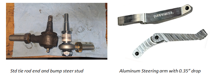

Breaking News!
Parts are being designed!
Dan at Van Steel has agreed to work with me on developing these two parts to make this work.
He already makes some outstanding products and is more than willing to add to his selection, based on my testing results.
*****5 Stars for a great Corvette Vendor!*****
The currently available bump studs allow for fine adjustment of the tie rod end height. But it needs to be lengthened some more. He has the CAD program, and the skill in house to get that done. Just look at his recent high end aluminum front suspension offerings. His current bump studs are made to his specifications, in chrome moly, and he has the CAD design in house. He has agreed to design a new one a little longer for more adjustment range.
Plus he already has aluminum steering arms made for his recently added C7 bearing/aluminum hub conversion kits. He has the ability to make an arm for the stock hubs, which will replace the stock forged arm, with the increased drop we think is effective. Having some of the rod end drop handled by the steering arm, means less has to be handled by the bump stud. So the bump stud can be shorter and everything will flex less.
The tie rod joint is currently 1.25" below the arm. It needs to drop as far as 2" with some alignment settings. That is about 0.75" more than stock. Basically the two of us think splitting that drop 50/50 between a new arm, and the bump stud, makes the entire system less flex prone.
  • The research stage is done.
  • This is the product design stage.
  • Next is prototype part production.
  • After that is cost analysis, then production.
Keep your fingers crossed for good luck!
