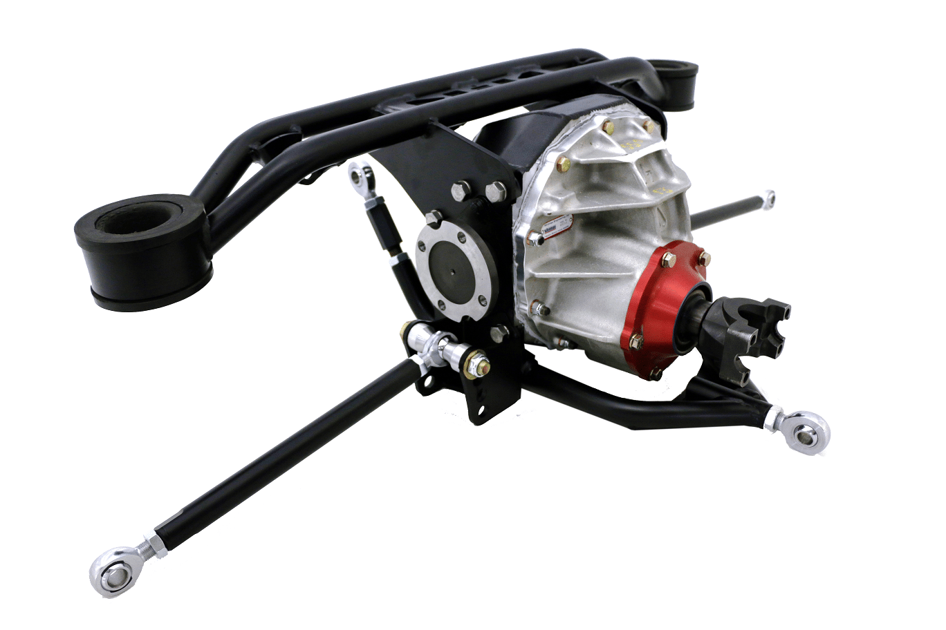

Have you looked at this from Ridetech?
I am using the Detroit Speed Hammerhead. It is 12 bolt GM.

That does look really sweet......Im thinking something more along the lines of a DIY kit...buy it one piece at a time so its affordable. But ya, it would like that for sure. I found the 9 inch that is set up for IRS but I would have to make a support similar to ridetechs to mount it up and luckily I have friends with access to shop equipement to help out and probably make one for themselves
