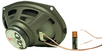

Get a double A battery to use as a test-
For each speaker-just touch (briefly) the wires to the battery (polarity doesn't matter) and you should hear a pop. No pops at all? Then you might have a hidden amp somewhere?
If all of the(or most of them) speakers pop- then turn on the radio and try connecting one speaker at a time- a speaker that has a rubbing voice coil and grounded to the car will cause the radio to protect it self and go into a protection mode.
Let us know what you find.
Thanks for the info. The speakers are fine. I've tested each one outside the vehicle when doing the "bench test". As mentioned I have pulled new wire to each speaker so I would think if there was a hidden amp somewhere when I straight wired each speaker that would have taken any external amp out of the equation. Each speaker does pop / static when the radio is powered on and in the car. I have tried them collectively and individually with the same result in the car - they pop / static but no audio. Take them out of the car and connect to the head and they work fine - again both individually and collectively.
Tried your test - thanks for the suggestion, I've not heard of that one before so thanks again!!!, and each popped in the car. I'm at a loss. Seems like the thing is possessed or something! LOL!
Yes this works great...have used it on my home and car stereos. Also you can use this technique to check the proper phasing of the speakers. If you carefully watch the speaker cone when first applying the battery it will move in one direction due to the DC current from the battery...either in or out. Both left and right speakers should match directions if you keep the battery connections the same at the amplifier (battery plus to speaker wire plus, etc.).
