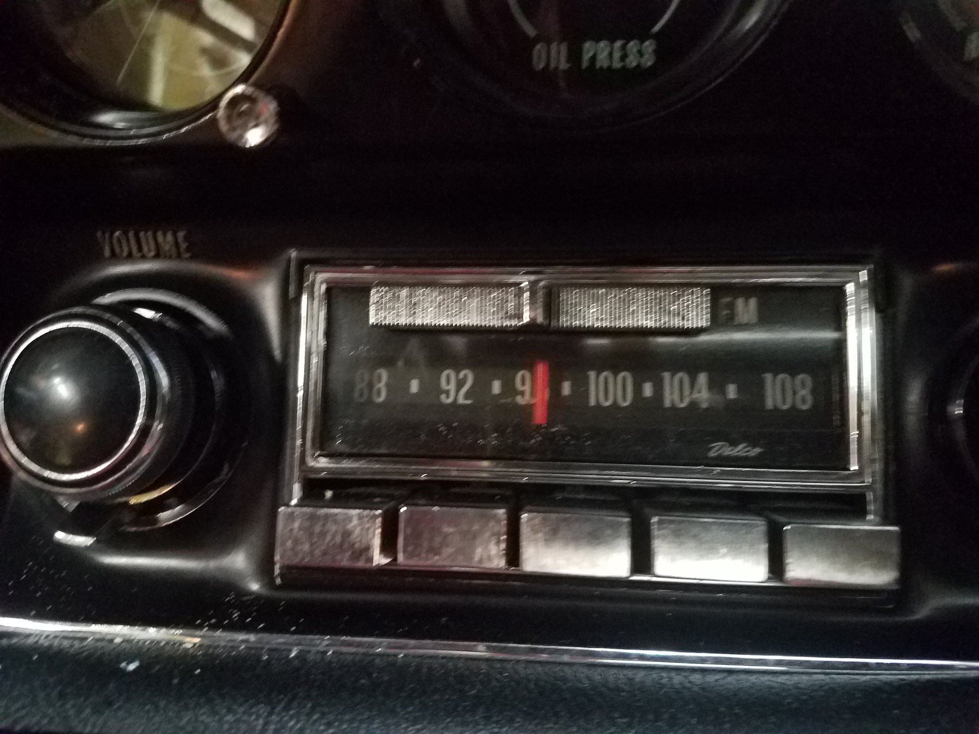

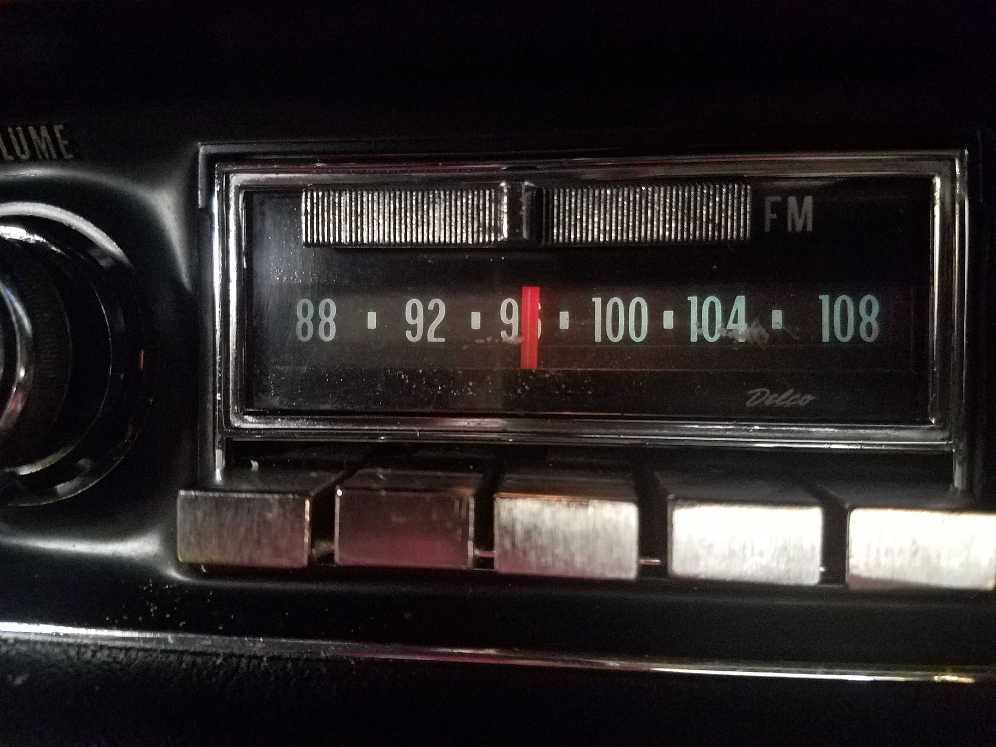

Old Aug 27, 2019 | 01:39 PM
oldyella's Avatar
oldyella
Joined: Jul 2019
Posts: 32
I attempted to post two pictures of the radio that is currently in the car. I was able to see the number on the side of the radio. The number was 7937571. I googled that number and it appears that number is associated with a 1972 corvette.

It is a '72-'77 radio, as it has bright white dial numbers/letters. I think it is a mono radio, as I do not see the stereo light on the faceplate.
If you are going to have that unit rebuilt, you should ask for it to be a stereo system with AM/FM capability and any other features you wish to be installed. They can convert your mono head into a stereo head with no problem. It already has an AM/FM tuner.
