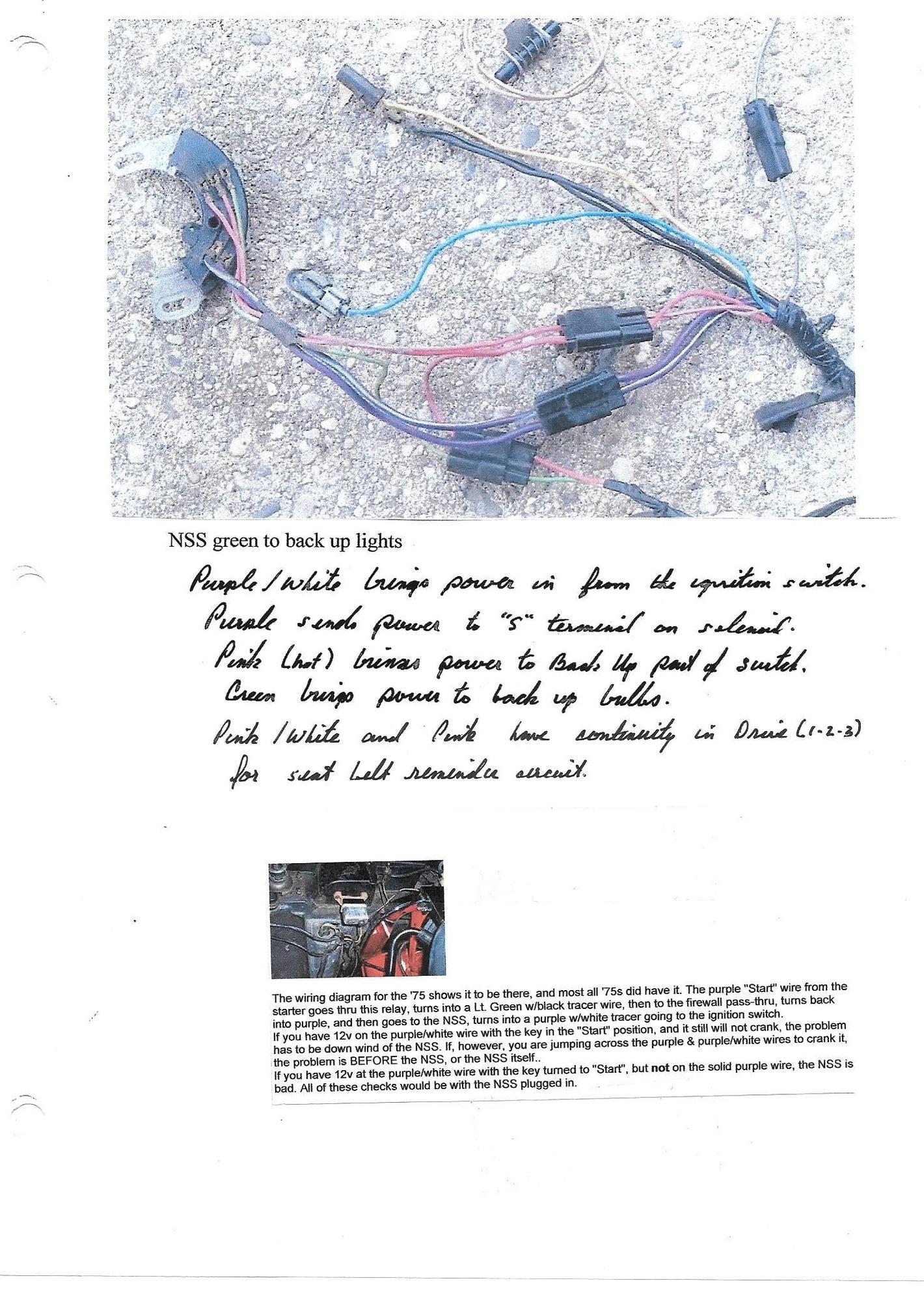

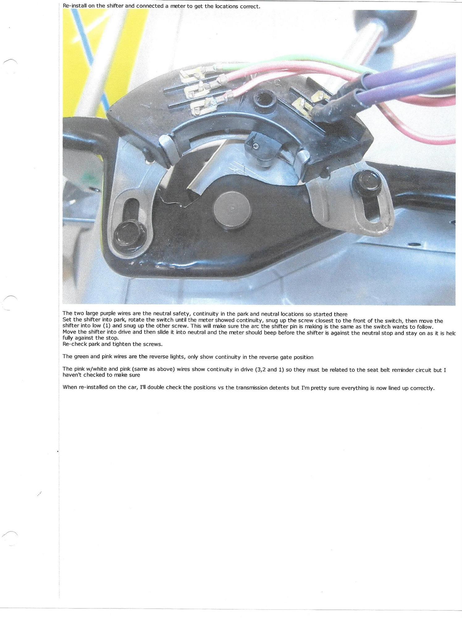

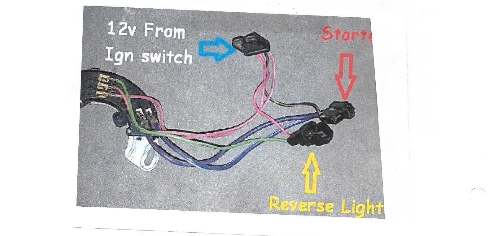

Here's how:

You can leave the neutral switch bypass in place. Connecting the backup light switch as shown will get them to work.
My guess is the neutral switch died, got bypassed and then the backup light switch died. They're both in the same switch, just different sets of contacts.
Personally, I'd hook them up as GM designed them- if someone else drives your car, (rare chance I know), and you neglect to tell them it will start in gear, it could cost you plenty getting things fixed.
