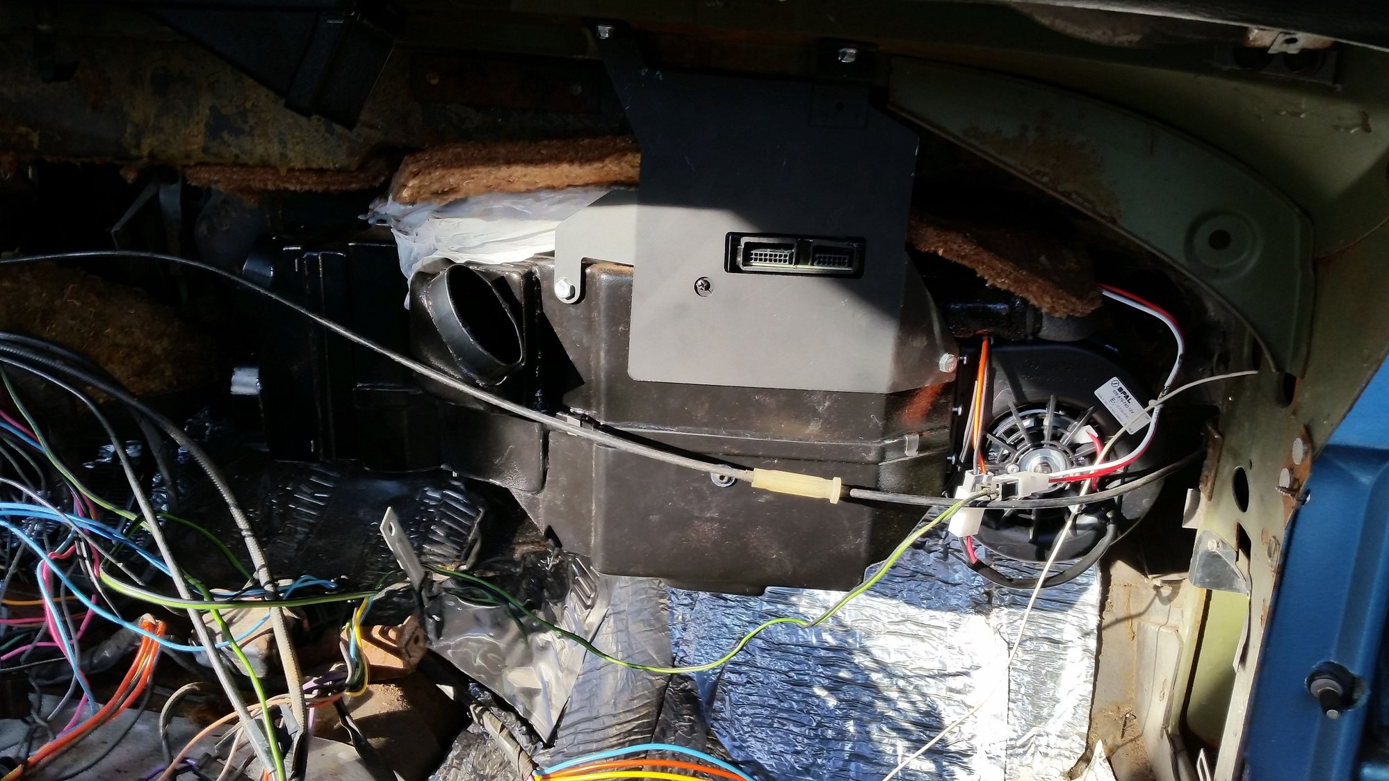

So now I'm tracking three manufacturers for retrofit A/C systems; Vintage Air, Old Air Products and Classic Auto Air.
Does anyone have any pics they can share of the in-car controls from the above companies (Heater Control, Wiper Switch Bezel with A/C vents, etc...)
Do all of the retrofit behind the dash A/C units hang down like the one in the picture? Were the original factory A/C components exposed under the dash like the one in the pic?
Thanks much.
Ted

Vintage Air Controls are the original in-car controls. Vintage air hangs down like the pic above. Nothing original hangs down.

The pic with the circled A/C evaporator/blower is from the Classic Auto Air page, so Vintage Air and Classic Auto Air both hang down.
Anyone have info/pics on what the controls from Old Air Products look like in a C3 and if their A/C evaporator/blower hangs down under the dash?
