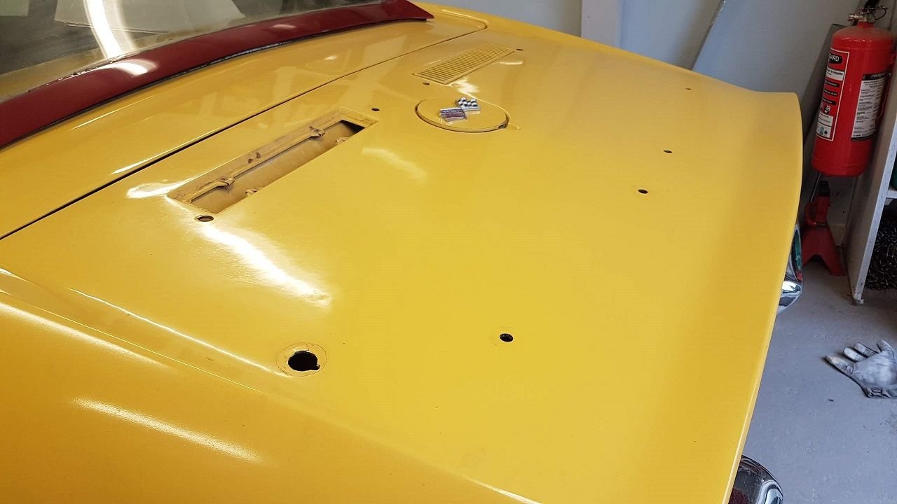

Im removing my cargo rack and antenna for a more clean look.
I'm thinking that i need to repair the antenna hole from both front and back, but the cargo holes I will just adress from the outside.
I.e no fiberglass on back side, just put something there temporary while I do the fiberglass work.
Ok or thoughts?
Another question, is there a connection on the antenna cable somewhere back there? Now the antenna is on the garage floor but still connected...
Had the body off but don't remember. Otherwise I will just cut the cable.

Hi, Years ago I removed the antenna from my '70 roadsters rear deck and mounted it underneath the body on a close by panel, it worked just fine. . My friend that did the actual total respray of the car patched up the hole on both the top and underneath.

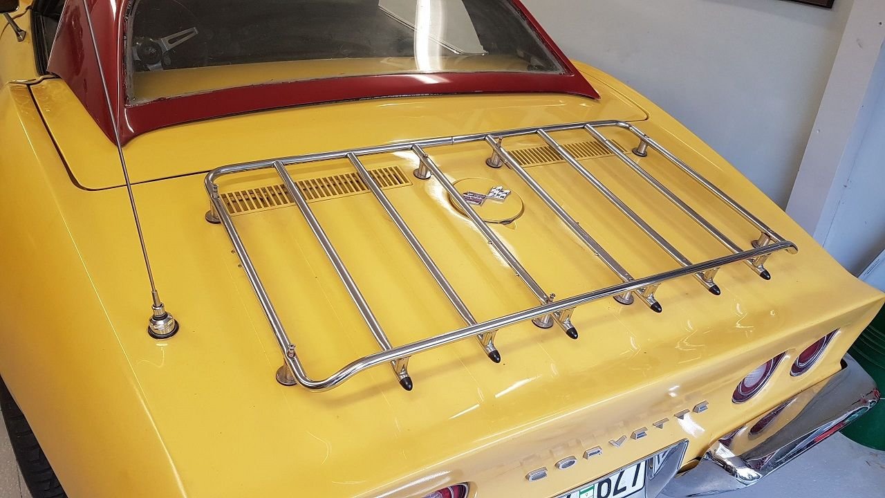

That's a good idea. But I fail to understand how to remove the actual antenna. Theres the big nut that clamps the assembly to the body, and there is a smaller nut above that doesn't make any difference when I remove it...? I guess it's seized after 50 years , but where is the connection?

depending on the antenna, the antenna may be threaded in to the lower assembly. Thats how mine is, the small nut is a lock nut holding the antenna locked into the assembly. Once you get that off the round part is threaded onto the lower assembly. can you post a pick of what you have.

I tried PB Blaster + violence (like with every other bolt on this car) but it wouldn't move at all. Then I pulled lightly in the cable and it disconnected from the metal base, so I guess problem is solved...

On my 75 I removed the antenna and used a flush button head screw and 2 large washers to cover the hole. Everything stainless so it looks pretty nice.
I re-attached the antenna underneath the car and then fabricated mounts for it inside the rear bumper cavity. It works well with my original AM/FM radio in spite of being hidden.
