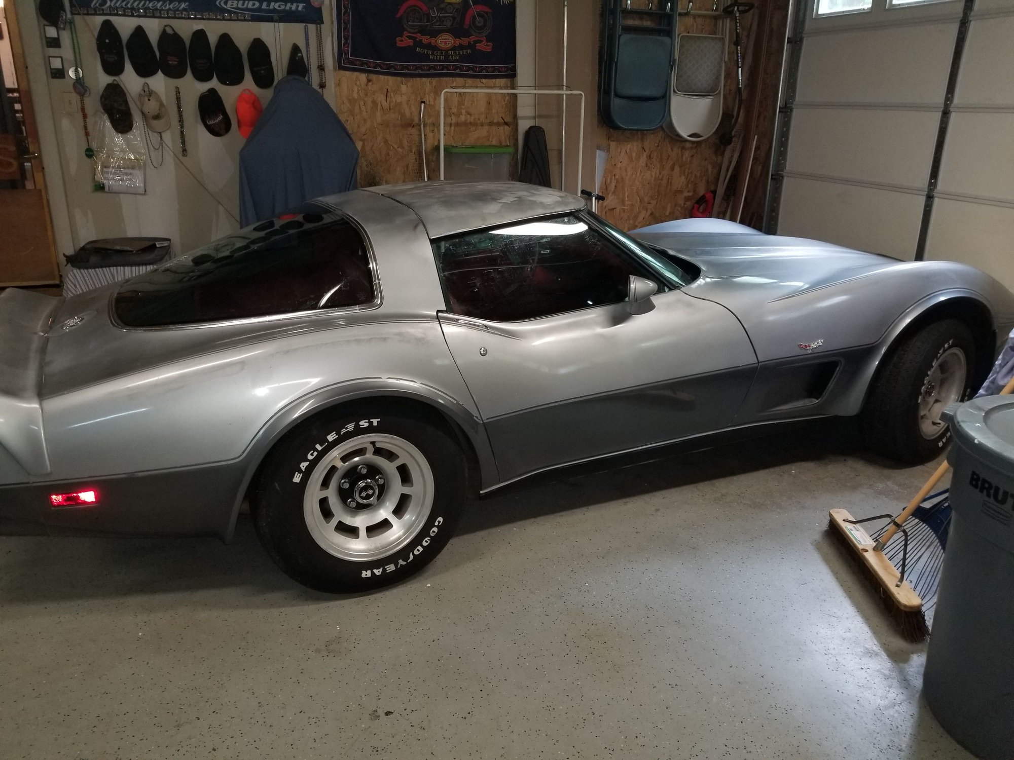

Just uploaded one pic I had available, let me know if you can see the difference.

Omg the rear is way to low. Do you have a pic showing the leaf spring and rear suspension ?

From that photo, it looks as if the front is too high. If you ride over some significant bumps and the rear does not bottom-out, the rear should be fine. The Chevy Chassis Service manual for 1978 will specify the proper ride height as a measured distance from ground level to the underside of the frame, both behind the front wheels and in front of the rear wheels.

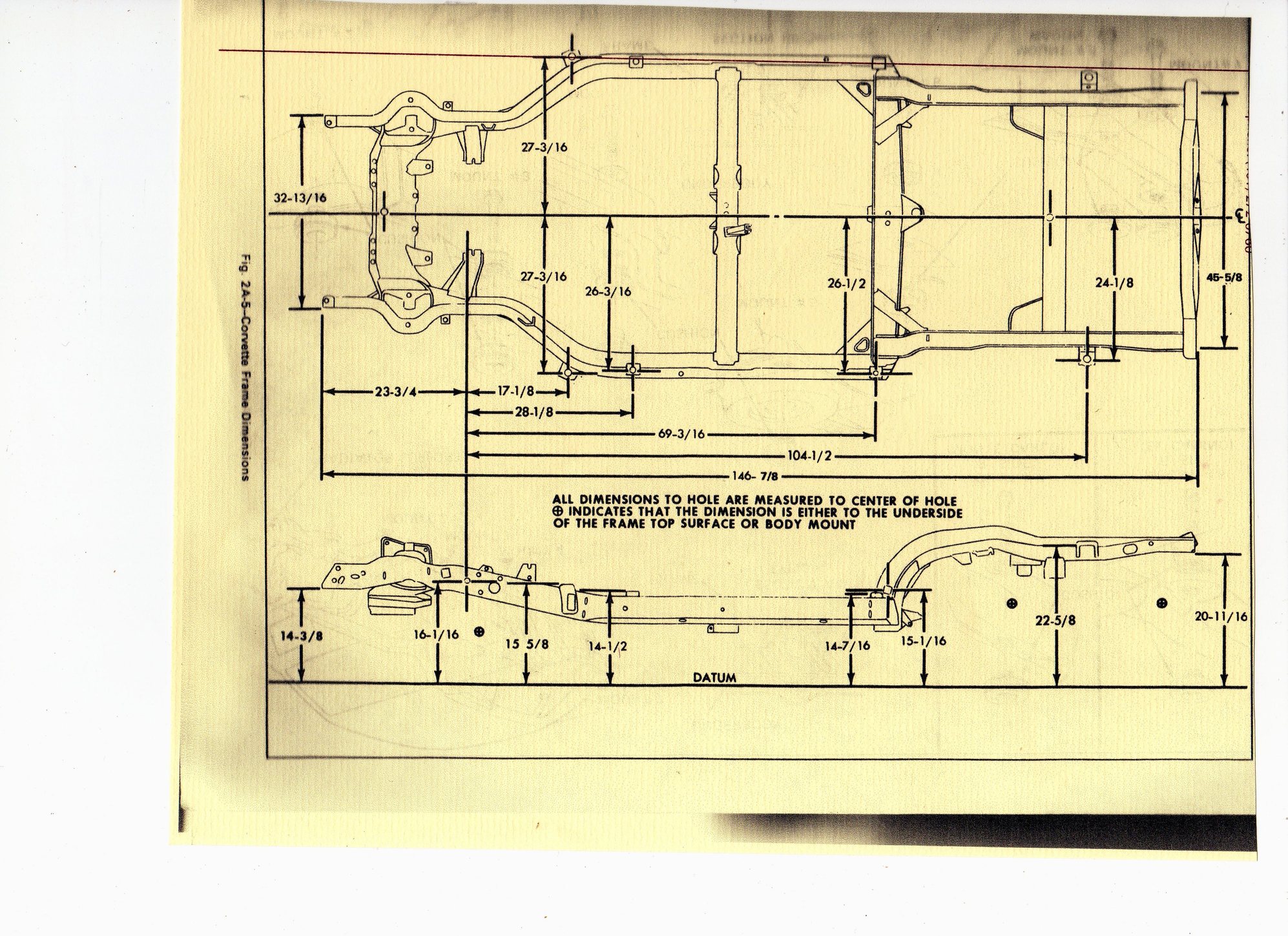

This is out of the service manual. Did the PO use longer spring bolts to lower the rear?. Although 3 inches is quite a bit. Where are you measuring to get this difference? What town in MA?

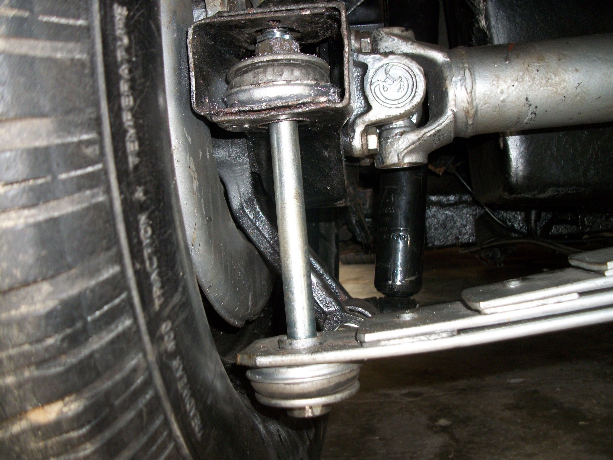

My '68 springpack......all the leafs are fairly flat...you can easily see the end of the main leaf is starting to bend upwards from age....that bend and flat leaves will cause you to lose an inch or more in body height at the rear wheel well. (I installed the bolts upside down for looks)

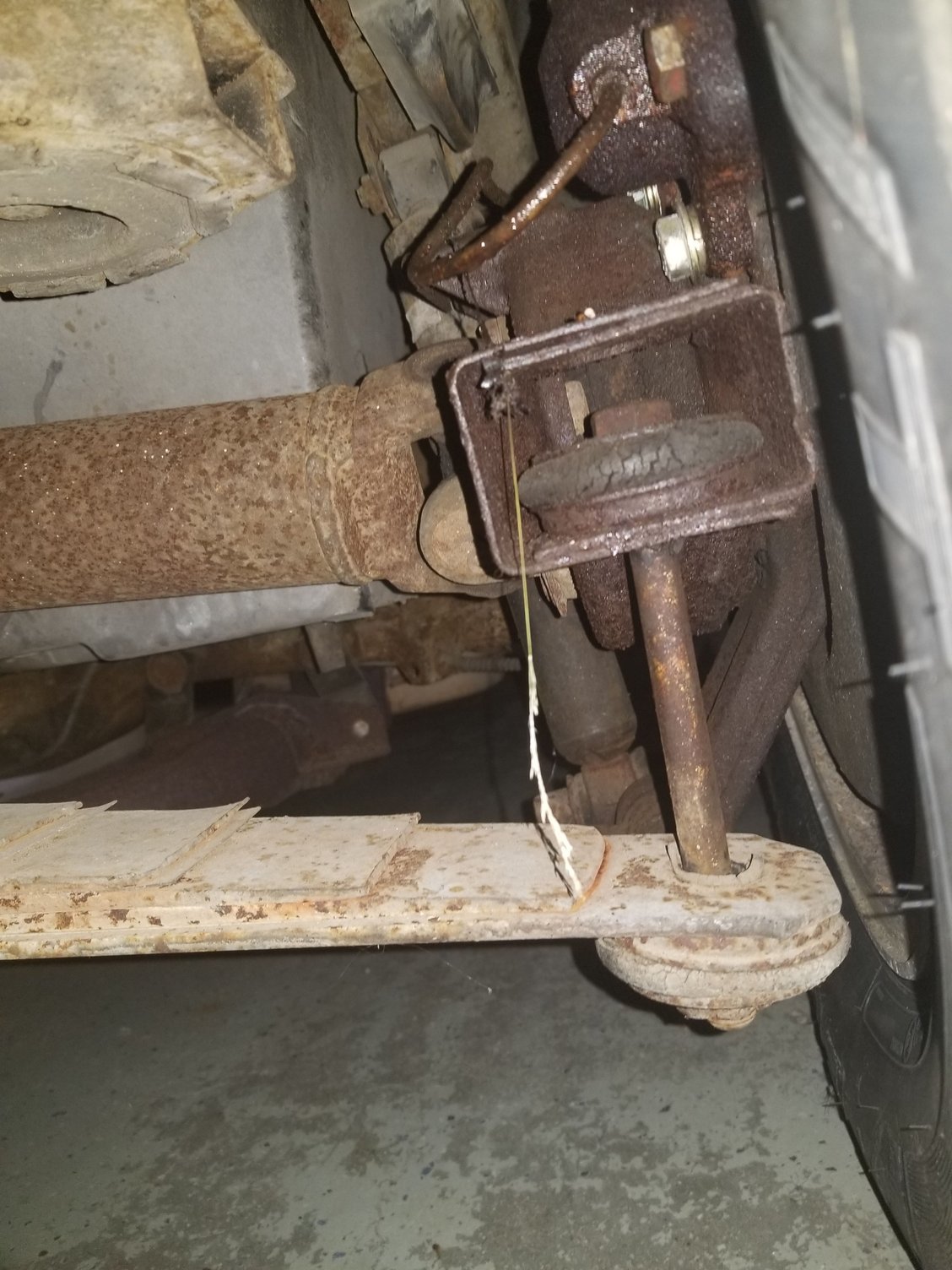

Thanks everyone,
Here are a few pics looking from the rear left & Right, sorry for the angle big men do not fit well underneath for pics

Thank You,
I just posted the same, not as clean as yours though.

If the half shafts are higher at the wheel end versus the differential end, and the spring appears bowed upward the spring is shot.
