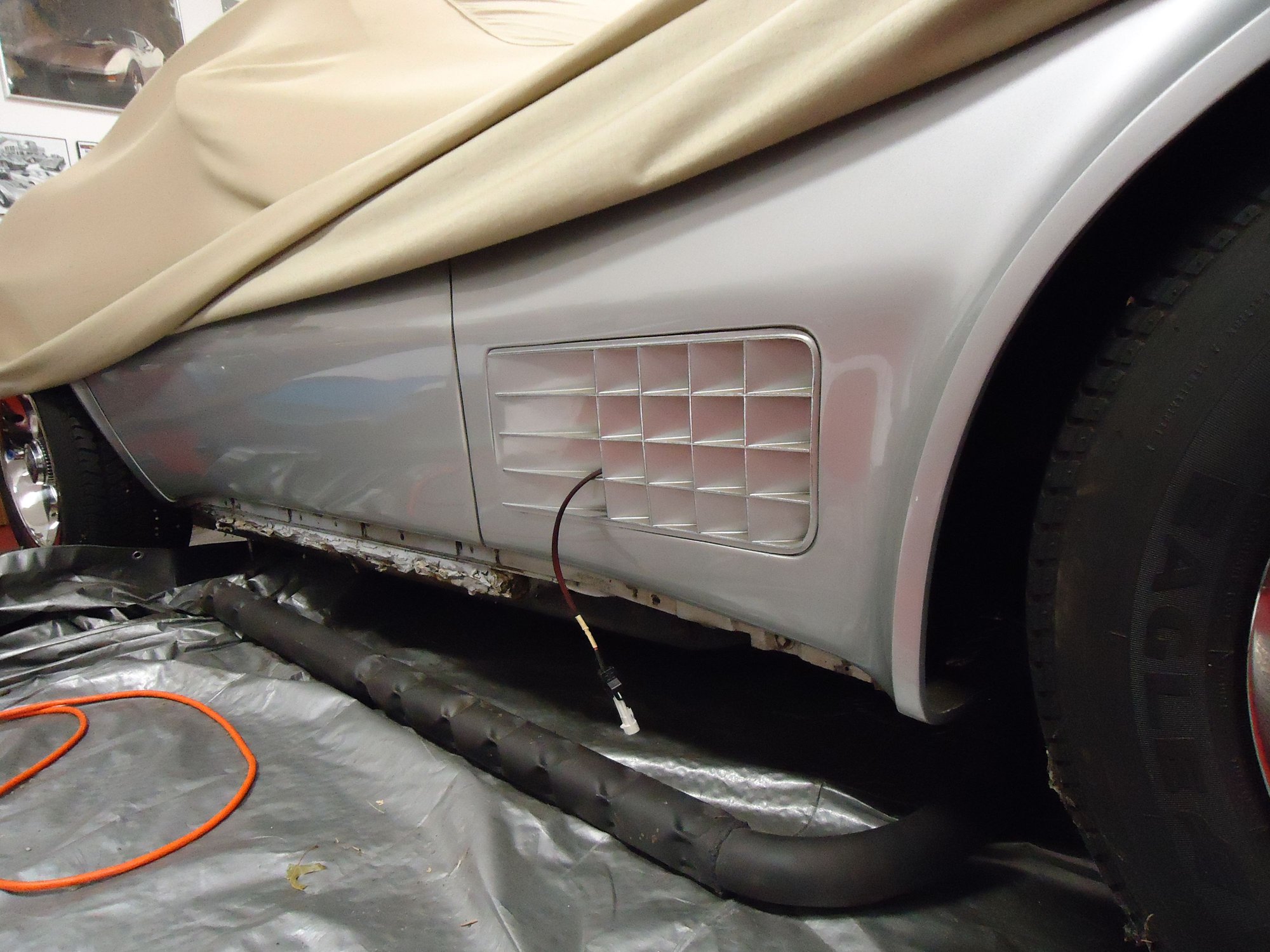

I made a 2 wire jumper harness from the starter B+ and ground with a 2 pin connector. I route this harness out through the fender vents with the connector hanging out and plug the tender there. When it comes time to go for a ride, unplug the connector and tuck the harness inside the fender. I don't like the idea of the charger cables laying on the fender for months at a time under the cover.
thats a pretty good idea. I've been looking for somewhere that I could "mount" a battery tender quick connect and have easy access to
