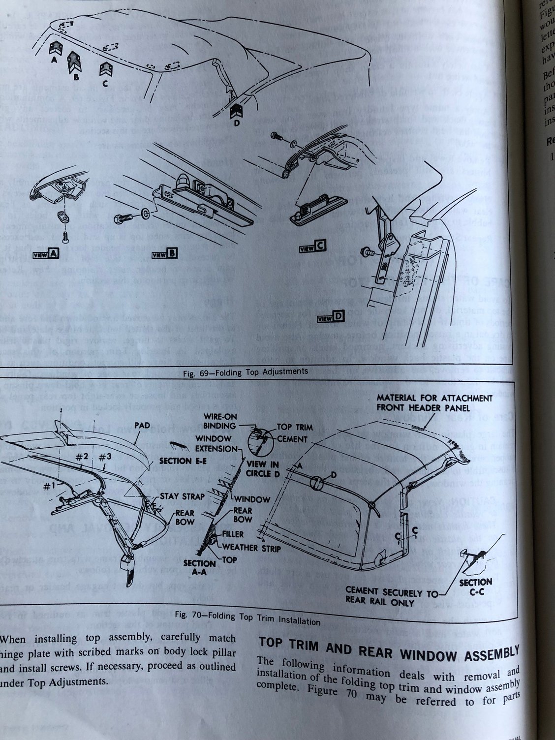

Hi,
When I got my 71' 3 months ago, it was a restoration that still needed some assembling.
The soft top frame needed all the bolts to put it toghether... I bought the hardware kit from Corvette America but i'm looking for some instructions on how to put it back togheter in order to finally install my softtop...
Anyone can help me out ?

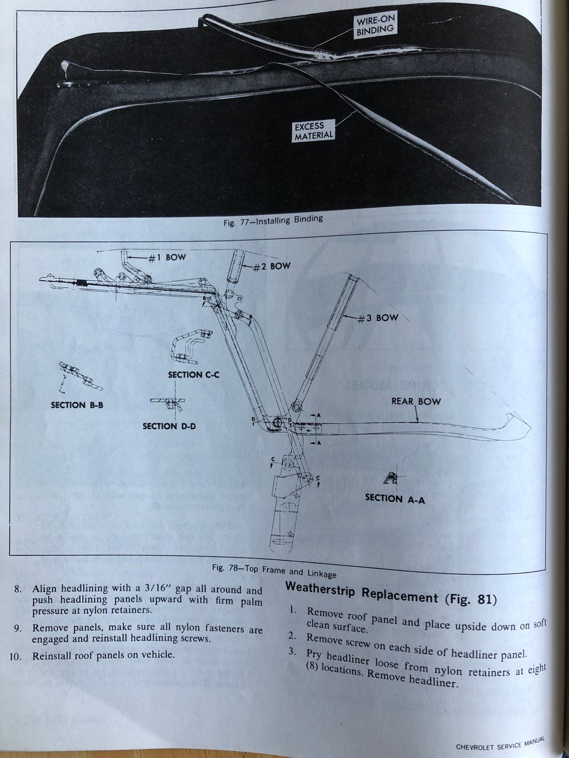

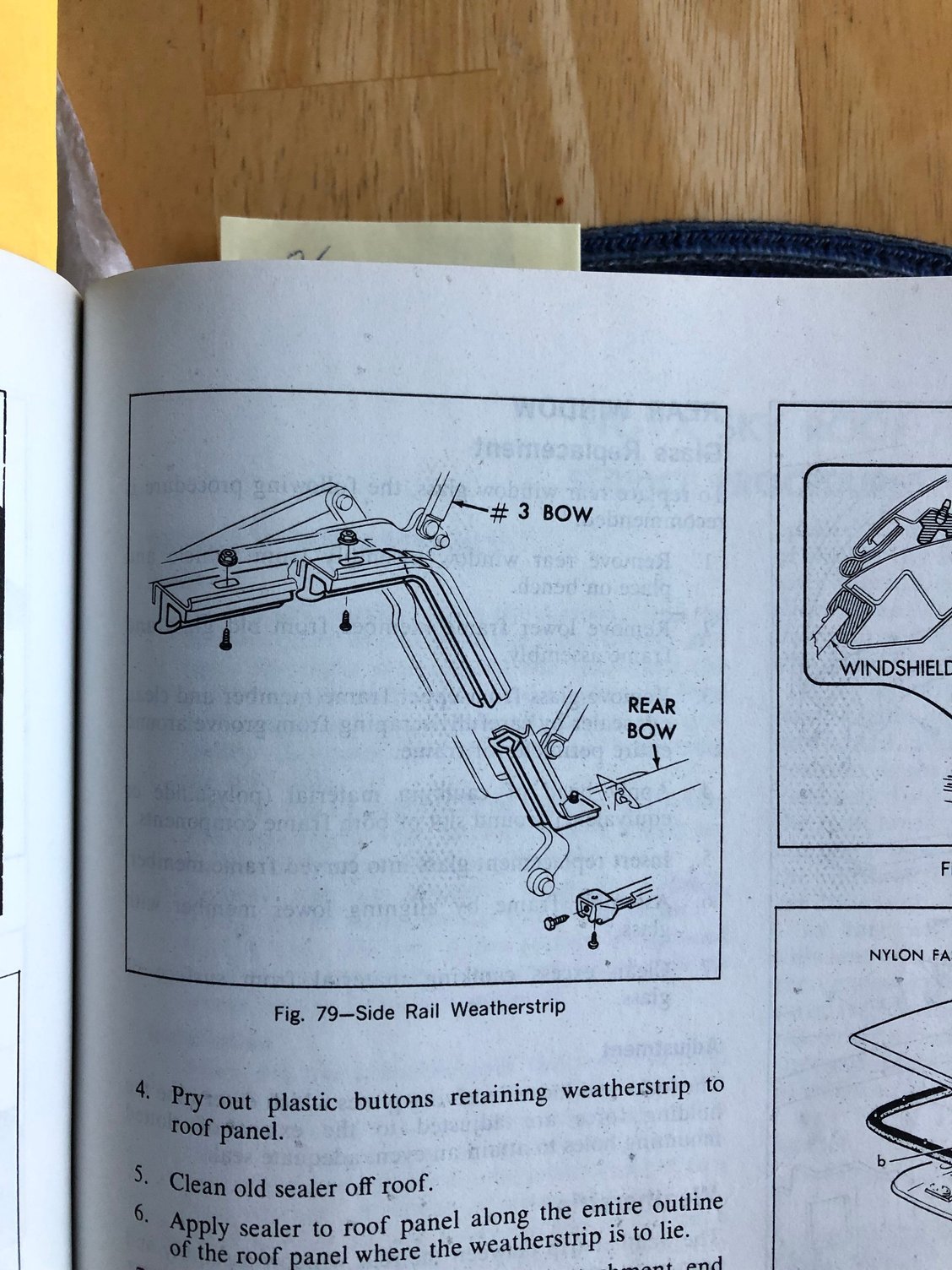

I found some info in the 73 Chevy Service Manual. Hope it helps.
Eli
