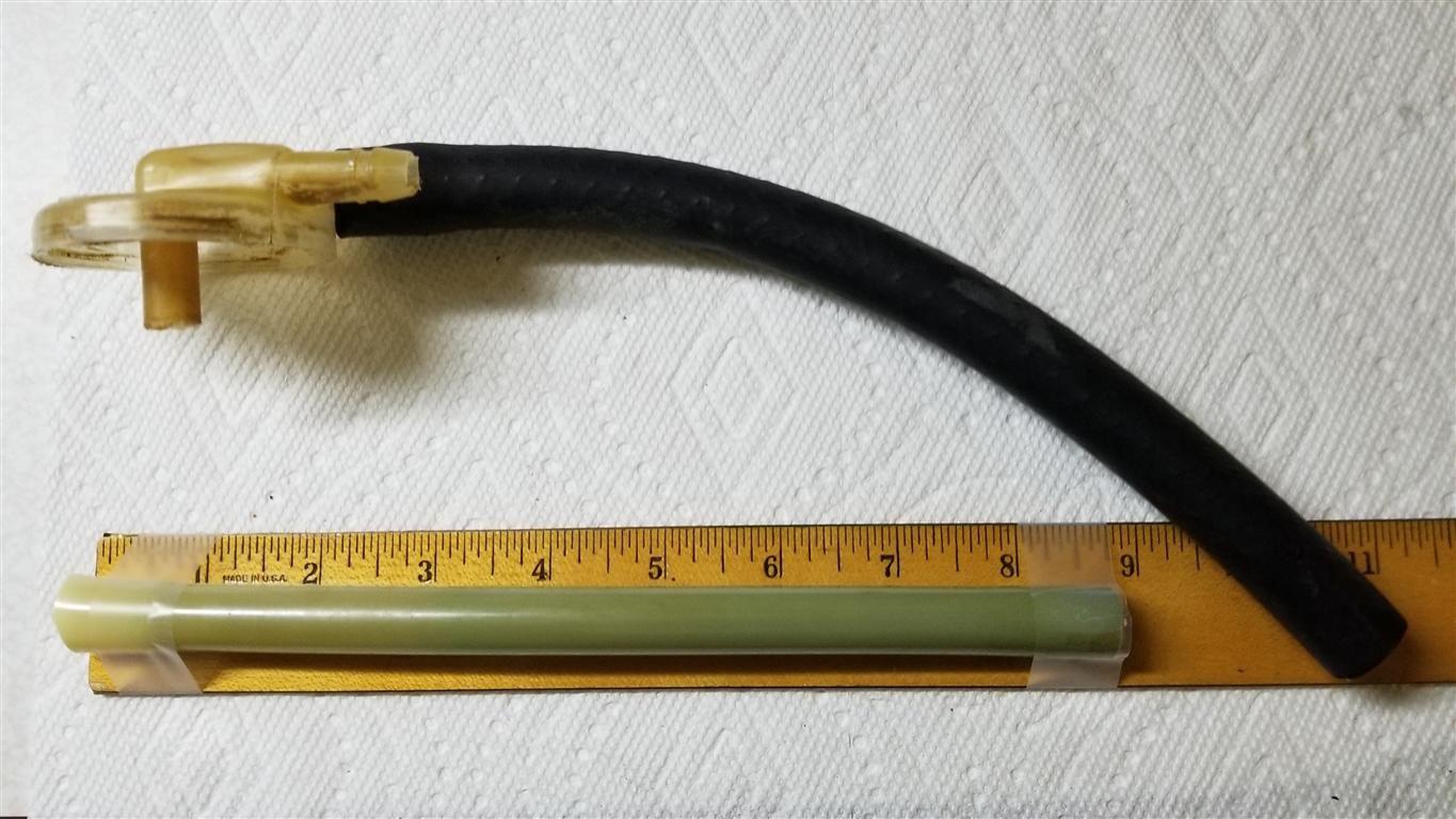

I also have a late build 77. It was equipped with A/C and has the early style reservoir and cap (not a screw on style). The inner hose is original and heavy wall (white or clear) silicone hose. I taped it to the ruler because it does have a natural bend like the diagram shows, not a 90* but a gradual bend. It is 8 3/4" long. The inner hose is still very flexible after all these years.
You sure don't need 5' but it is 3/8" ID and 1/2" OD like this from amazon, so at least clear hose is available:
