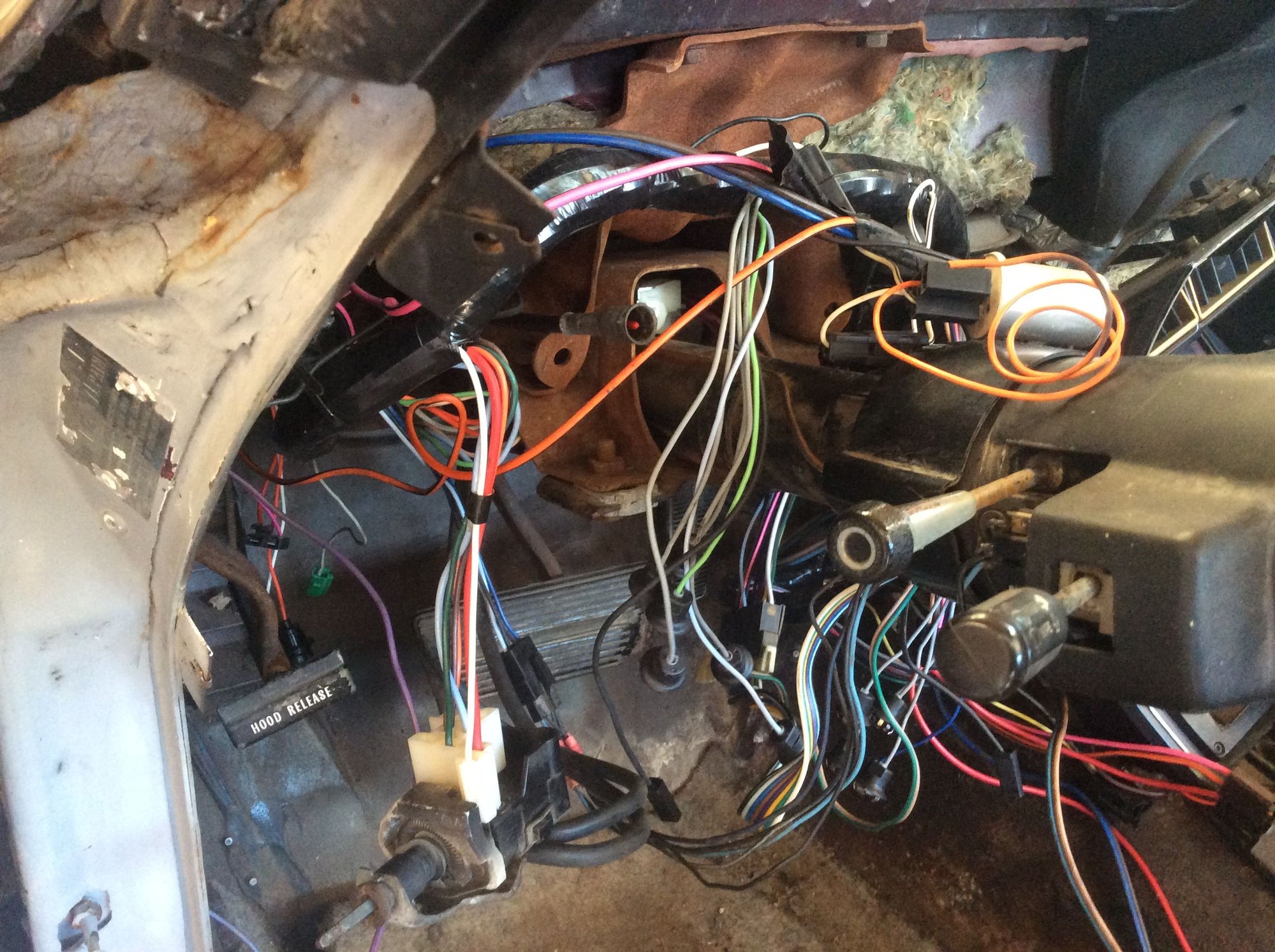

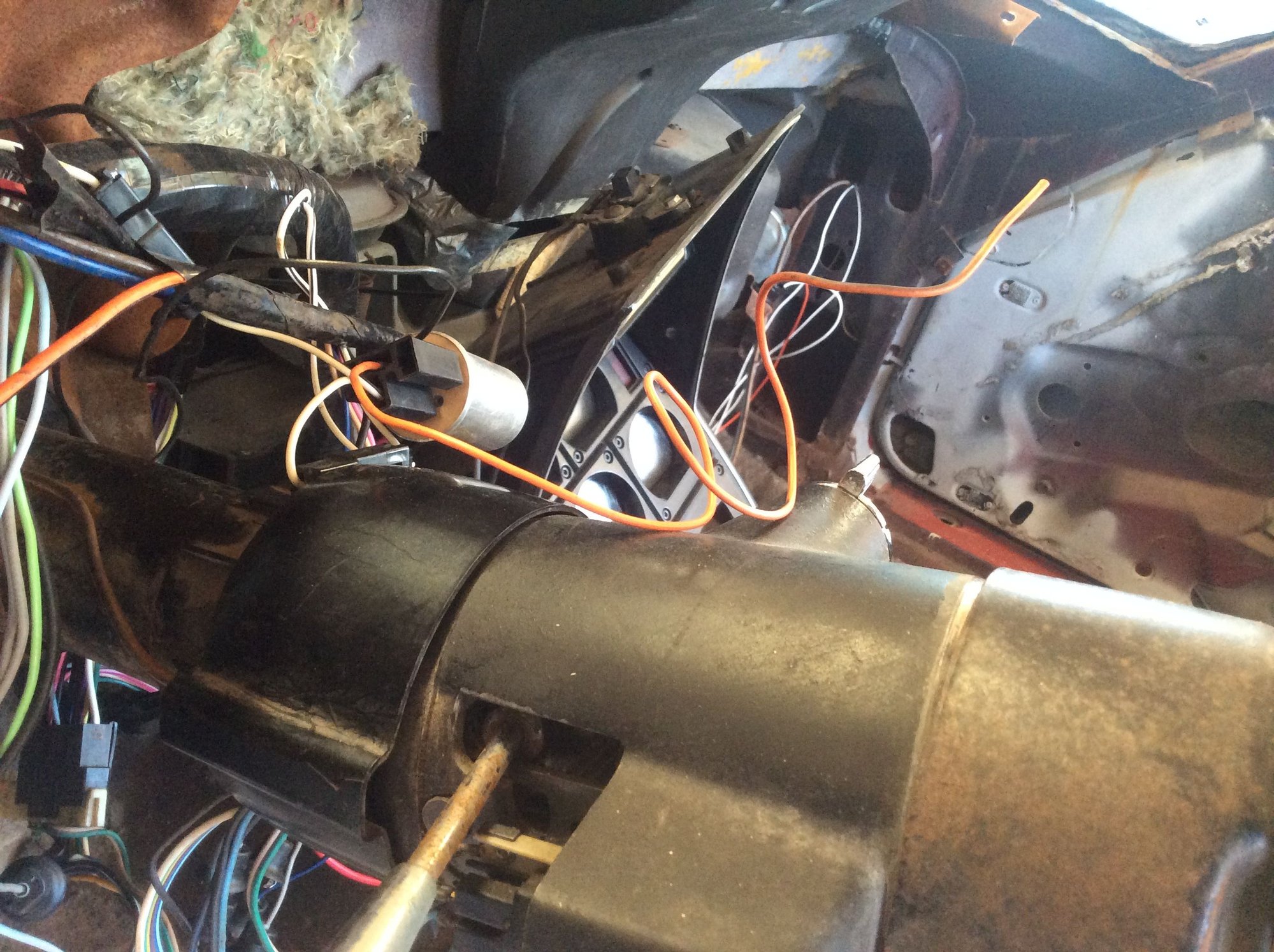

Does anyone know where this orange wire belongs? This is a brand new wire harness and it’s the only one that doesn’t seem to have anything to connect to.

There's no connector on the end? What year?

1977

Looks like the wire to the anti-theft horn-

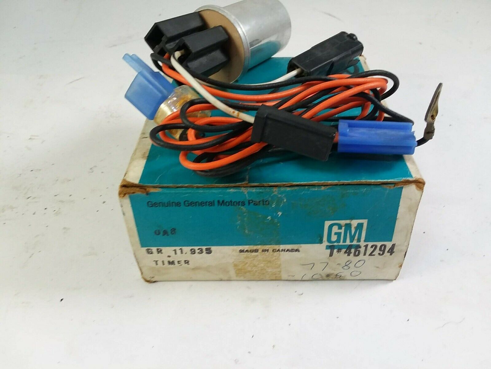

That orange single wire powers the delay timer it's connected to. There should be a blue plug at the end that lands at the fuse panel BAT socket.
Harness: https://www.lectriclimited.com/court...-timer-harness
Yep- you are right- forgot 77 had the courtesy light timer too...

Not all came with delay timer. It was part of the ZX2 convenience group package package that also included under hood light, low fuel light, mirror passenger side visor, headlamp warning buzzer. I think that it...
