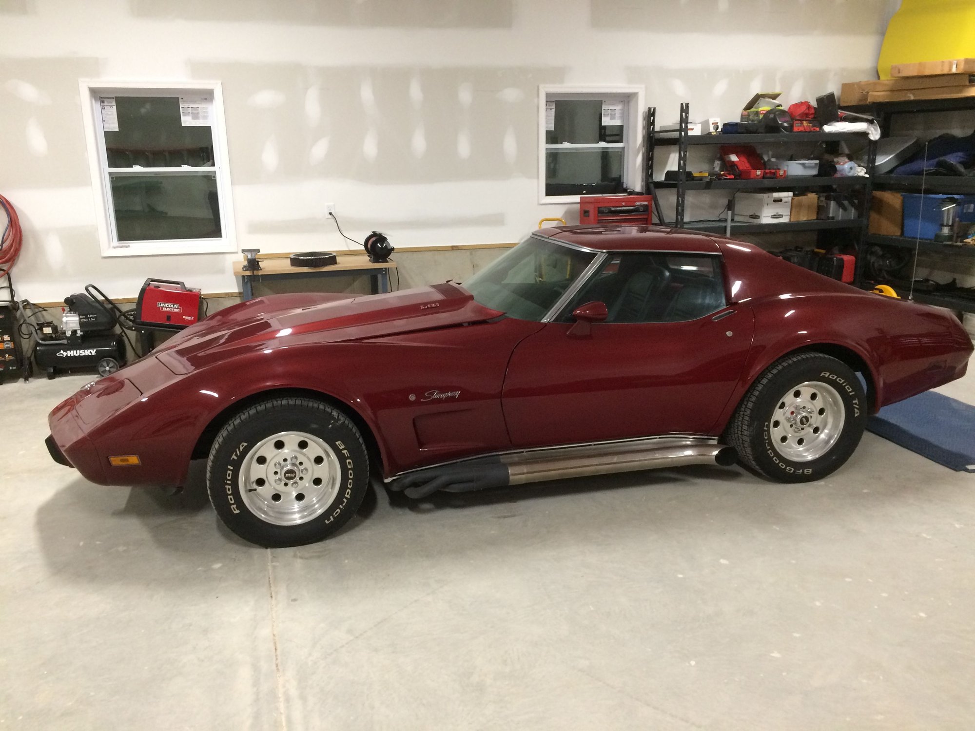

lots of threads on hooker sidelines. I love the look and sound. Fitment will likely require denting some popes for steering box and plug clearance.
Likely you will need to notch your stainless rocker panels In The front. Take your time and try to leave a bit on the front. If you take the back wheels off you can slide the rocker covers in from the back.
last thing. Very important, lol. Use anti sieze on the slip on pipes. You might never get them off again if u don’t.
I found used black ceramic coat headers and added SS pipes with Spiral baffle inserts. Stainless headers look better imo but relieving/denting stainless can be tough I’m told.

two more things. Get a set of dead soft aluminum header gaskets. Will help prevent leaks and are reusable to a point.
Slso I’m told current manufacturing of headers the last few years requires drilling holes out because Hookers QA isn’t good.
