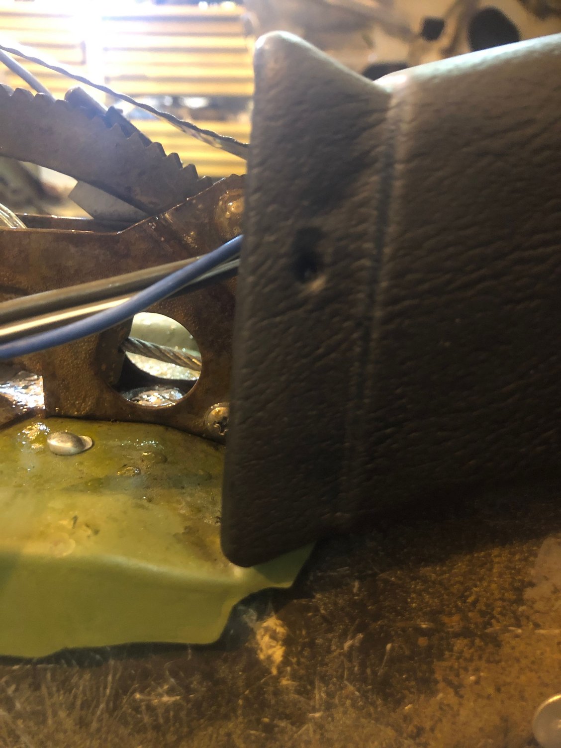

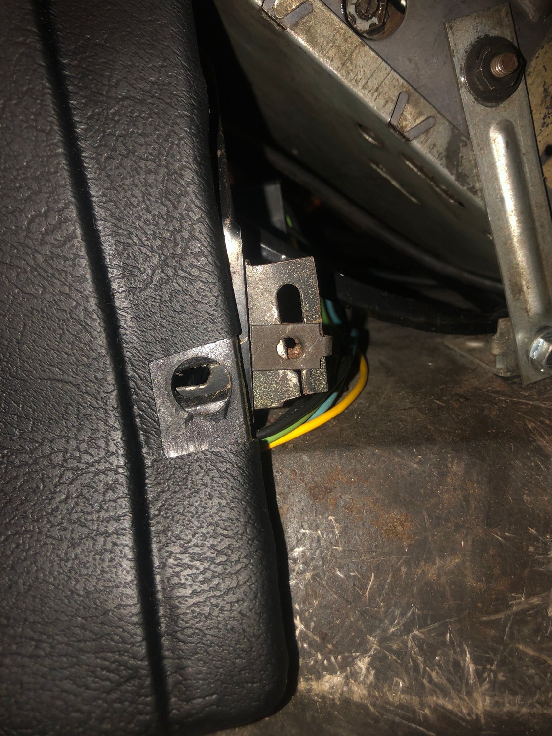

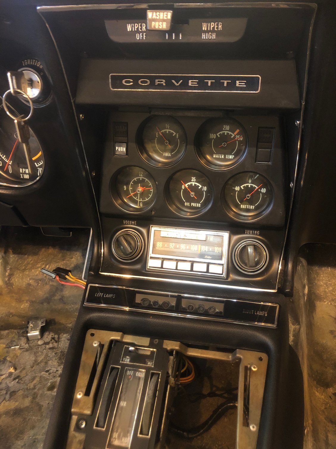

My 68 console was junk, so I bought a new one from Wilcox. Well I riveted my front support plate too it. I Got everything ready to go. But for what ever reason, it is not lining up with the screw plates up front or in the rear by the E-brake. See the pics
The console need too forward approx 1in. And can’t see how it will do that.
please give me your thoughts. Thanks Troy.

I have seen this before.
Is your upper dash sagging just a little in the center?
This will cause the console to be pushed back.

My 68 console due to Bubba, after market parts and 50 years of age required I loosen EVERY faster from the rear of the emergency brake cover all the way up to the wiper switch. After a substantial amount of time of wiggling, jiggling and cussing I finally got every faster to catch and slowly and sequentially tightened everything down. When I was done I had the feeling I would sell the car before doing this again. The feeling has passed but not the memory.
