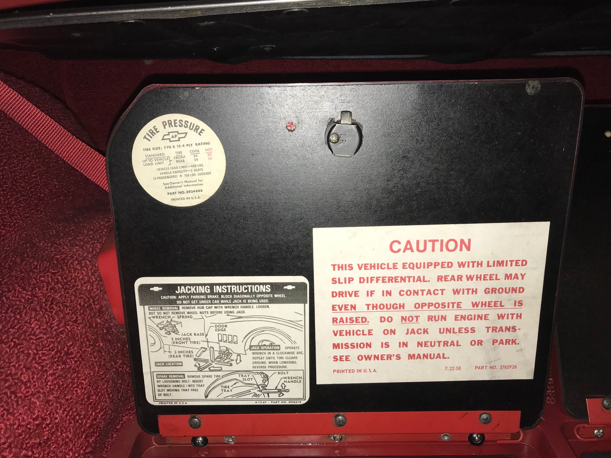

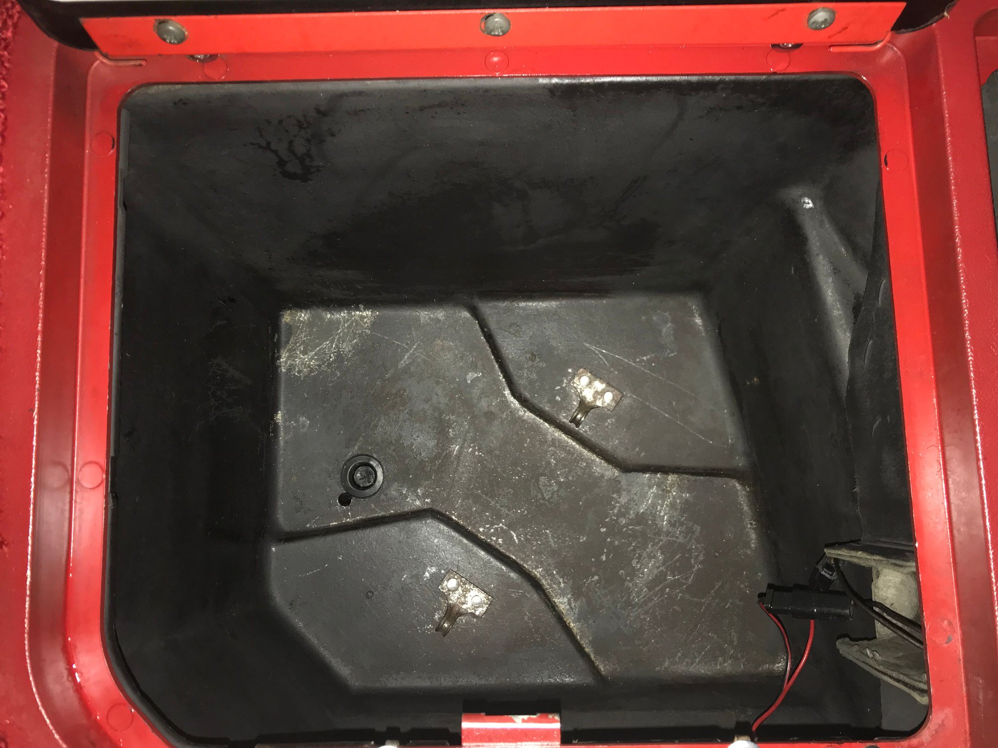

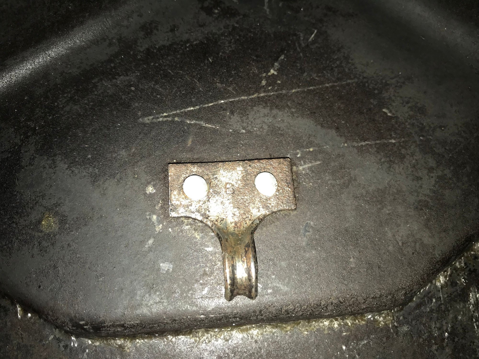

Hello Again Corvette Fans,
Day later and I have moved over to the other two storage compartments on the '69. Found the same letter "L R" stamp on the bottom of the passenger side jack storage compartment latch. Also located the letter "B" stamp on each of the riveted hold down hooks for the jack.
Anyone know who the manufacturer is that would have stamped "the letter "B" on these storage compartment parts?
Thanks once again. Kevin
