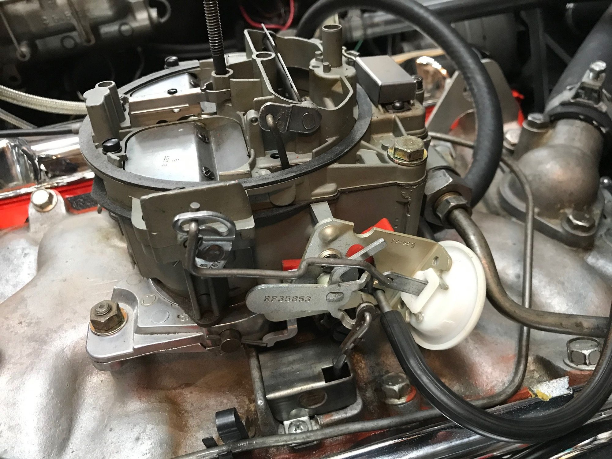

If you're going to rebuild the carburetor, would you spend an additional $100 - $150 to have it plated? What are the pros and cons?

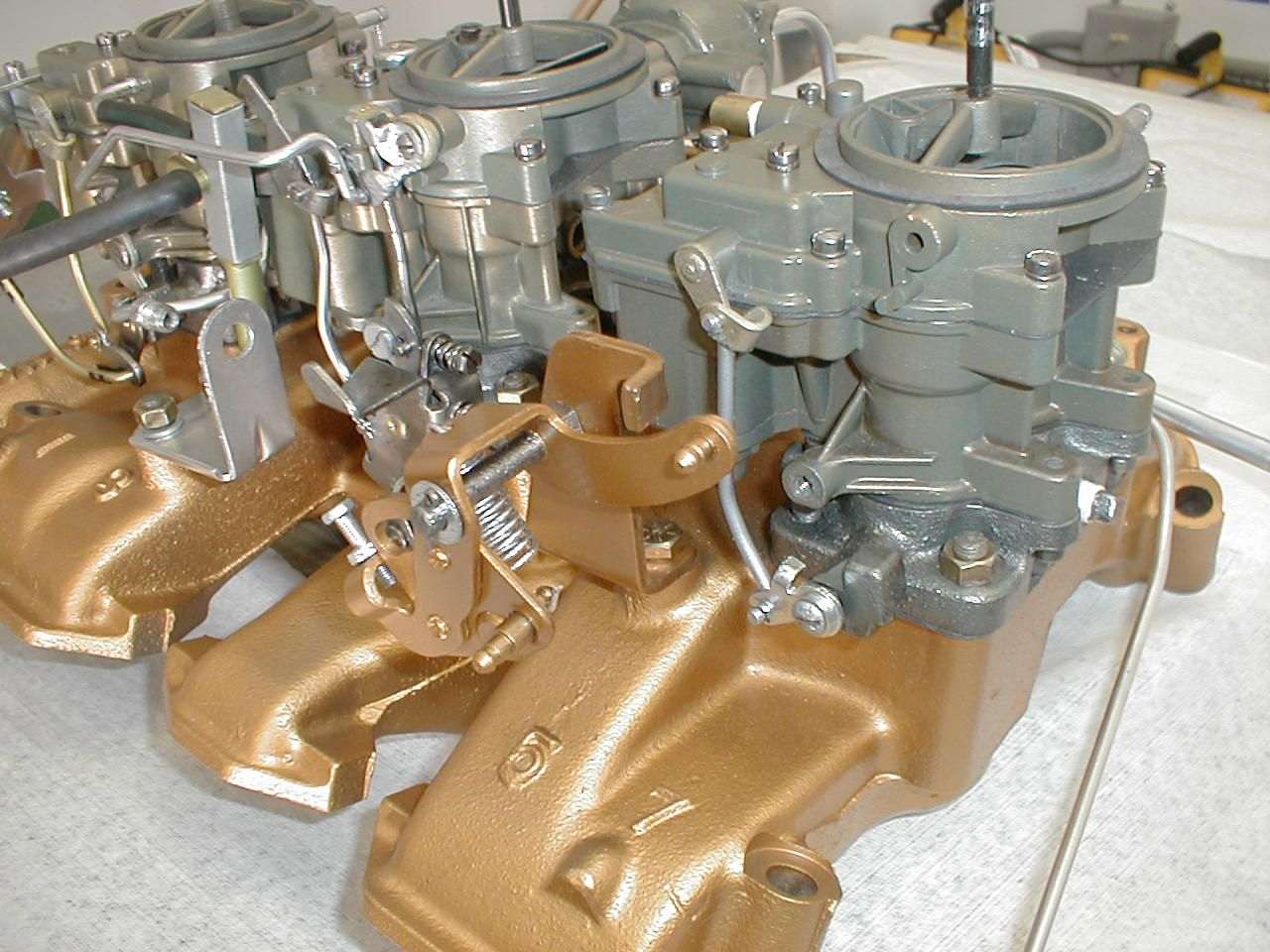

The 'protection' is provided by the zinc plating on those parts. The chromate wash is simple, adds a bit more protection (in the short term), and gives it an attractive gold-ish color.
For 'general-purpose' vehicles that like to show similar to stock, the outer surfaces of the carb can be painted for better protection. Eastwood offers some stuff called 'Carb Renew' or you can gin-up your own method for obtaining the chromate 'look', while protecting the metal surface.
There are folks that have disdain for painting carb bodies; but folks have been doing it for many years without adverse issues. Most marine carbs are painted.
Here's an example of painted carbs on an Olds J-2 tri-power intake::

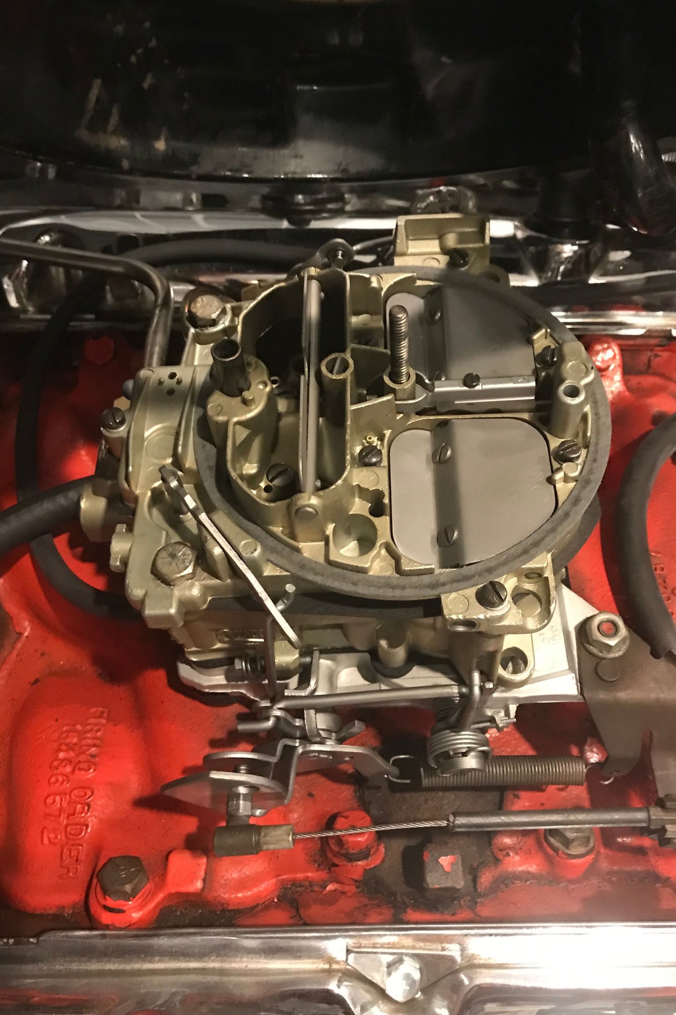

Default Carb plating
This is the stock quadrajet on my 68 L 36. It was done by Cliff Ruggles a few years ago. No extra plating like you see on a lot of the restored carbs. I think it looks pretty good.

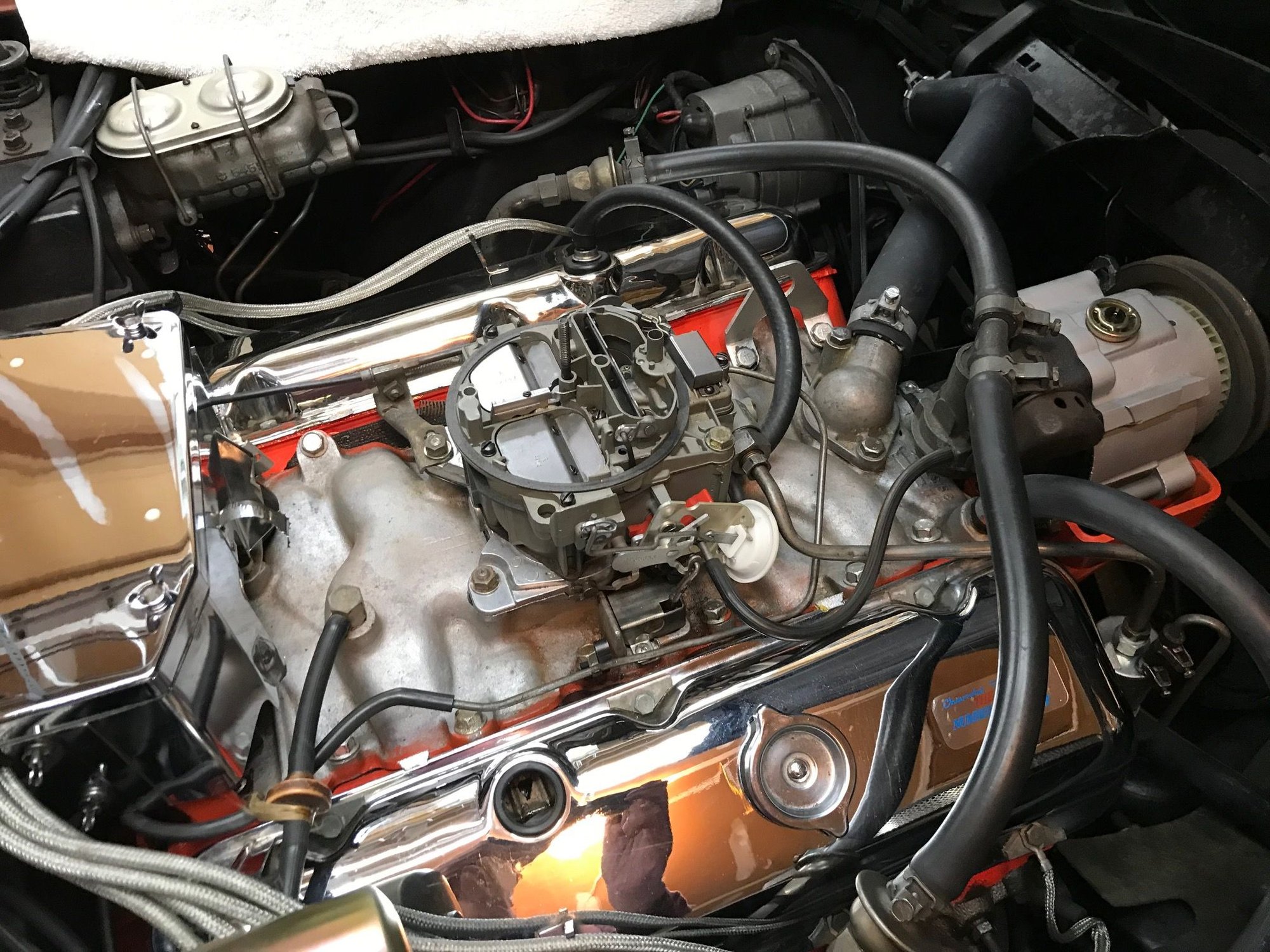

Just to follow up, I decided not to go for a full NCRS plating, but definitely think the rebuild turned out really good.
