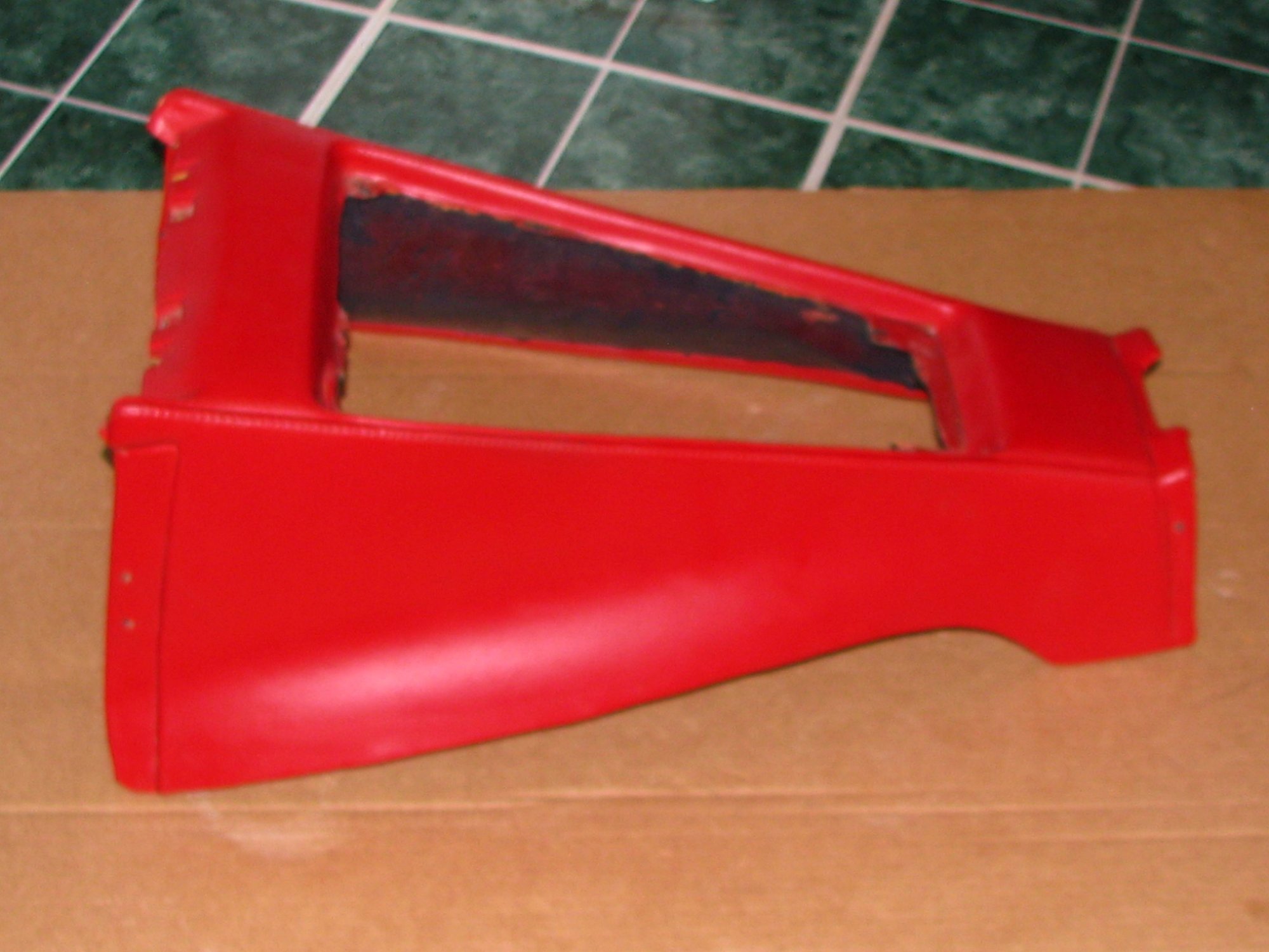

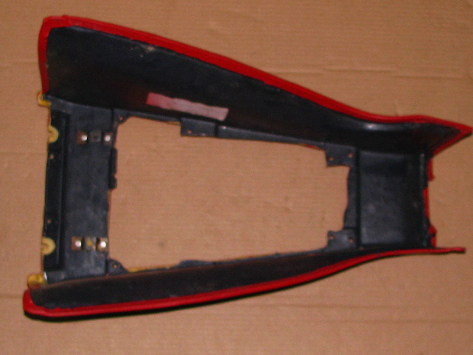

How do you tell a reproduction console from a GM?

My original on my 69 is white plastic not black on the inside but not sure about a 72

Yes, that looks like black ABS plastic.

I was going to say if it's not busted in the shift plate corners - it's not likely original. But maybe that's just mine
My 72 is a white-ish fiberglass color as well.

Thanks for the replies. Looks like it must be a repro.

Probably, but it's looks like it's in good shape.

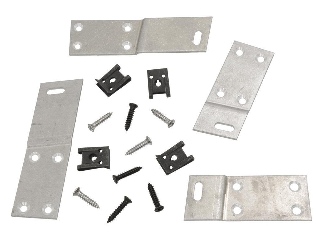

No it's not just yours, lol! Common problem I think. They sell a kit to repair those corners:
68-76 FORWARD SHIFTER CONSOLE REPAIR KIT - FIX MOUNTING TABS ON SHIFT CONSOLE

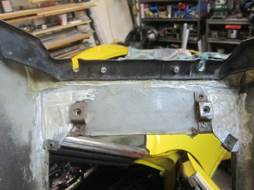

anything that's busted enough that a vendor creates a repair patch for you just know it was an issue
Mine has a pretty hard life over the years and the top ones were snapped off so I just epoxied some new aluminum pieces into the top corners, much like the kit except from the scrap bin, and drilled new holes to match the shifter-plate. 4 or 5 years and counting...
