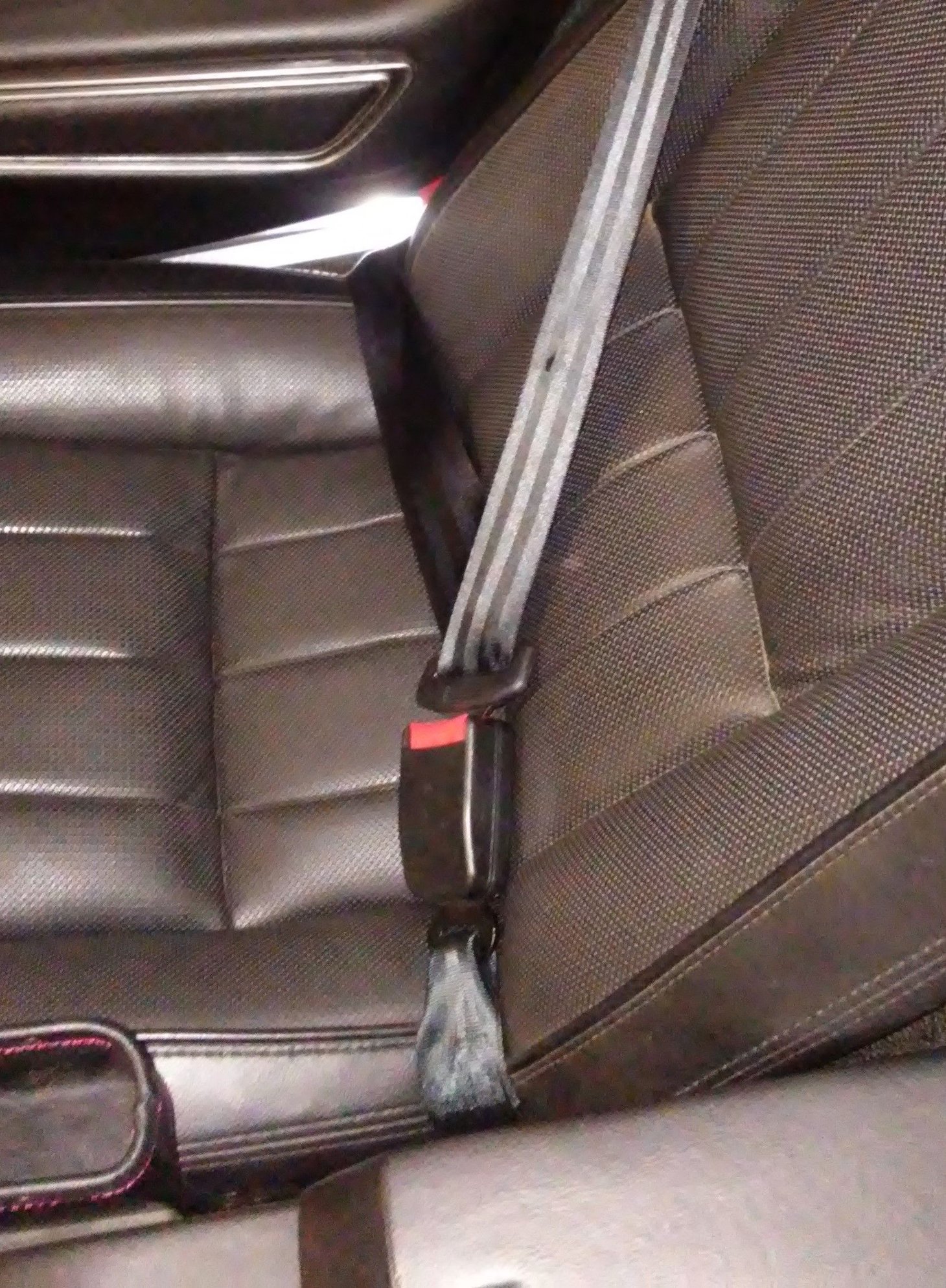

My 1969 convertible has lap belts only. Would like to add shoulder belt. Does anyone make replacement shoulder belts with correct buckle?
Where does the shoulder belt retractor mount?
Pic of my lap belt buckle below....thanks

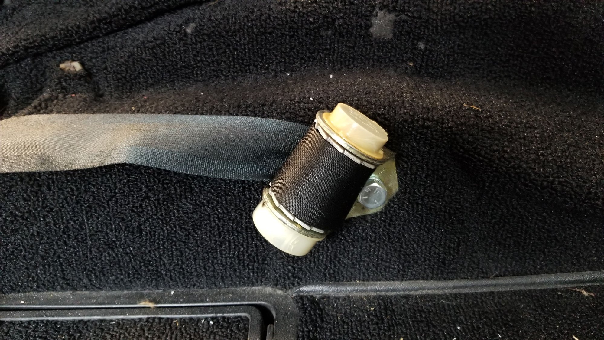

Here....
Inside of Fender.

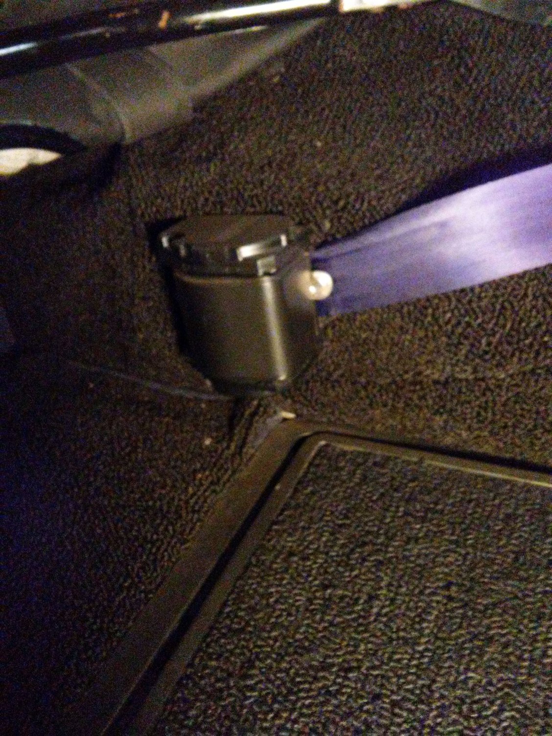

I had to unbolt the existing seat belt parts and install a complete new shoulder belt setup. You can buy much lower cost versions of these online. Takes a bit of figuring out to adapt and not perfect but better than not having them at all.
Aftermarket shoulder belt.

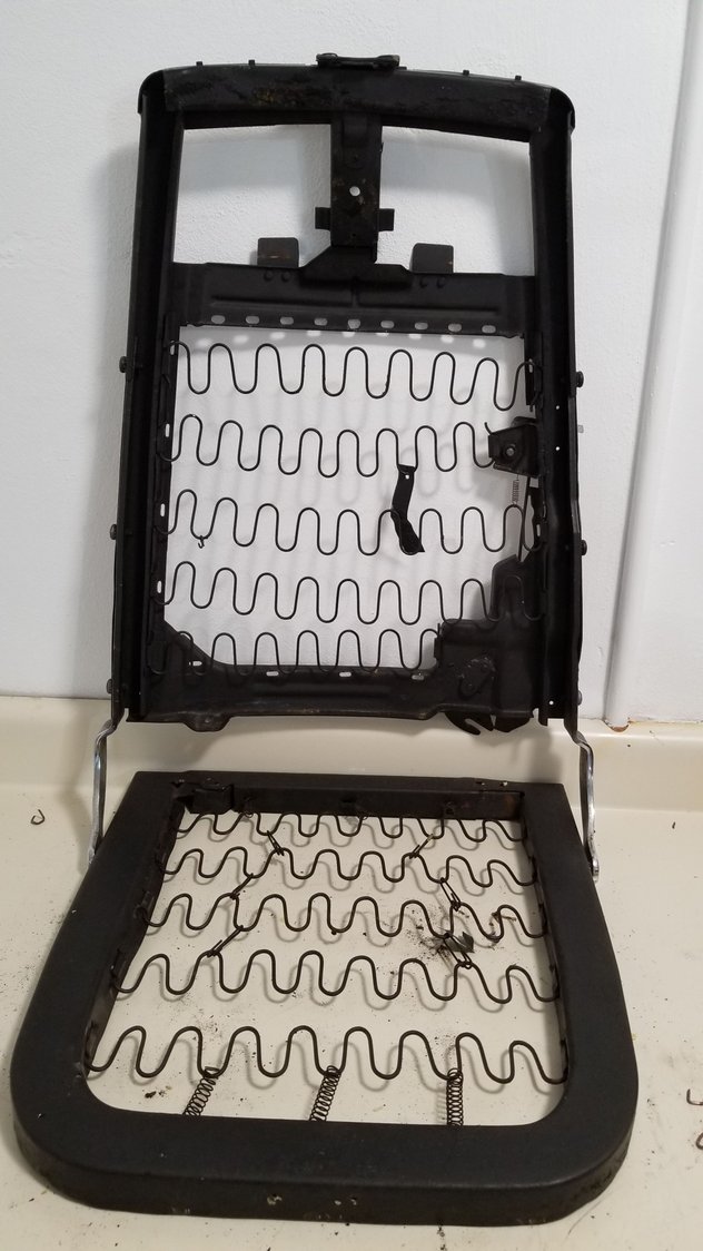

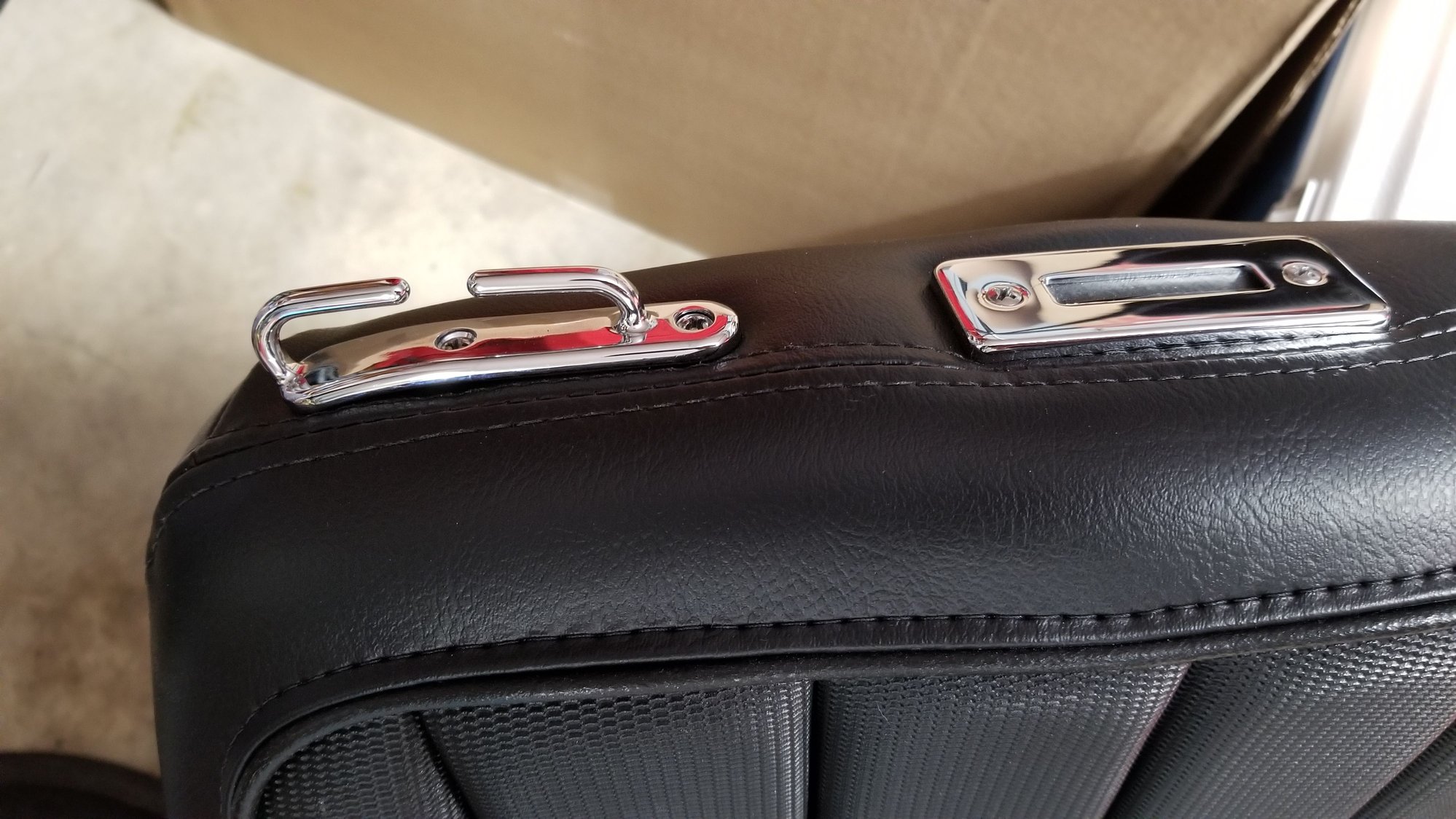

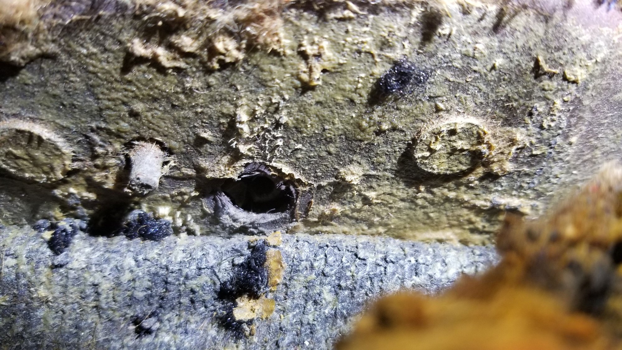

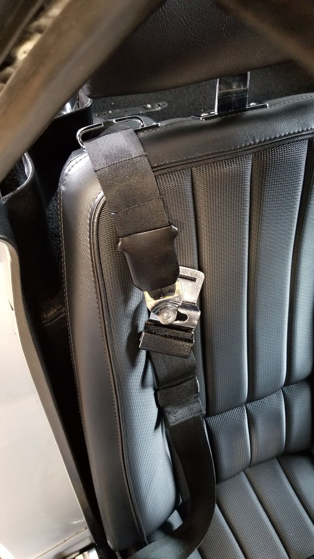

Shoulder belt retainer mounting points at the top of seat frame.
Inside fender well shoulder belt mounting point/guide pin. Plastic cover over bolt hole removed. Lots of plastic stuck in the threads.
Shoulder retainer installed. A bit nerve racking to pop holes in seats I just rebuilt. You have to feel for mounting points!
