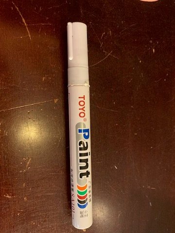

Old Dec 19, 2019 | 08:57 AM
gtmsomeday's Avatar
gtmsomeday
Joined: Apr 2016
Posts: 93
Likes: 72
From: Dallas Texas
This was cheap stuff. The Jury is still out! But for now my BFGs have a stay-of-execution! I felt like I had nothing to loose.
Oh yeah - It is time consuming.

Thanks for doing that so quick! Already found it on Amazon. Might cruise over to Hobby Lobby later and sniff around.
Time I seem to have plenty of. It's 14 degrees F out there now and we're on our third ice storm and it's only December. I actually have a tire off now - eliminating the heat riser and replacing the center section of moulding on the side pipe cover. Perfect time for a clean up and paint.

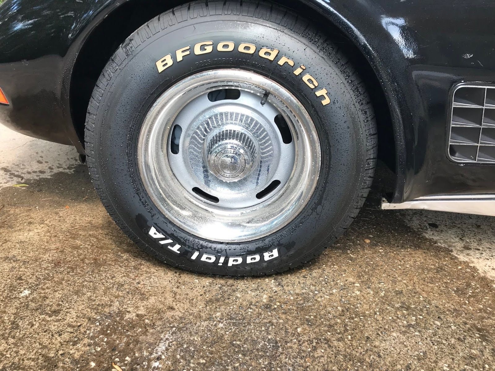

I guess you already tried brake fluid...? Tire below is half done.

Did you just wipe the brake fluid on then wipe off or was scrubbing necessary?

Just put some on a rag and dab it on just the letters....Wait maybe 2 to 3 minutes then wipe it back off with just a little bit of scrubbing. I then washed the tires off with soap and water.
