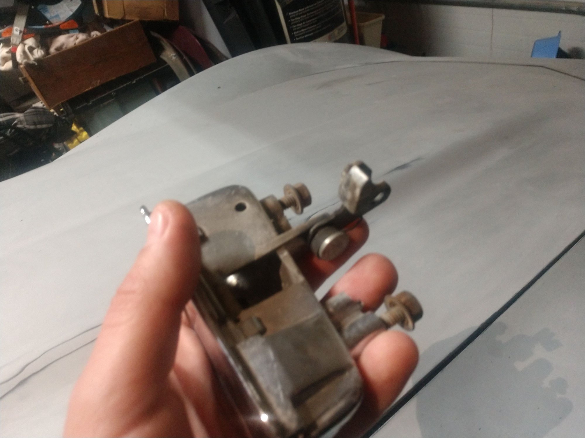

Does your driver's door open using the inside handle? If so, the spring on the outside door handle may be broken, which will make it so the linkage to connected to the rod that actuates the latch mechanism will not articulate. Basically doesn't move/ rotate anymore! Hope this helps, if your inside lever doesn't work either, please post, have mine all apart, can send about any pic you would need!
Linkage extended, broken spring
Broken spring
Good spring
Handle depressed, spring working
