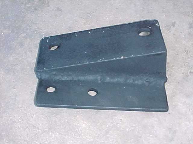

It's practically a bolt on. You'll need the stock Corvette pedal assembly, clutch assembly, z bar linkage, and bell housing. The only thing about the T5 is that when it was mounted in the Camaro, it was tilted about 20 degrees. Using the Corvette bell housing will straighten that out, but you'll need to fabricate an adapter for the rear mount and the shifter. That and to shorten the driveshaft a bit.

If you're gonna go with the T5, make sure you get a world class T5, the kind used in V8 Camaros and Firebirds. The 6 cylinders used a non-world class T5, which will work, but is weaker and only has a .80 overdrive 5th. The W/C T5 has a .63 overdrive 5th which will drop your 3500 rpm at 65 to about 2000. You don't have to worry about the cross member, but It will make life easier in the long run if you pull the engine. Using the adapter I made from two pieces of angle iron, I made my own rear mount which was just a thick piece of reinforced rubber with the two holes in it. And you don't even have to weld up the adapter like I did, you can just bolt the pieces of angle together. Just make sure you have a quality shop shorten and balance the driveshaft.
