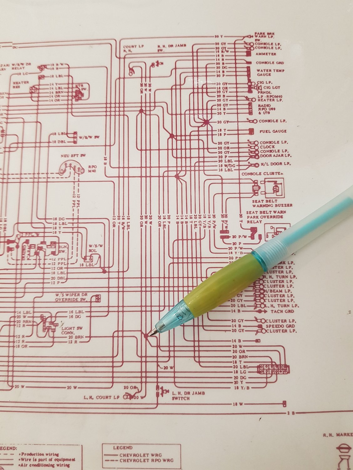

Does someone know where this point is located?
I got my courtsey lights work when I open the driver door, but not when I open the passengerdoor, and turning the lightswitch to the left. I know the passengerdoor switch is working.
thanks

The car is a 72, but has a wiring dash harness from a 73... but the groundpoint shound be the same?

this is a 73 wiring...

Ground point is on left side above fuse block. If dash pad is out easy to see.

Can you see it or is it taped in to the harness?

If you stand on your head and look up it is a screw into metal and few ground wires on it. Hard to see but its there. Wire runs from there to dash as well

I think I know where that screw is, but no white wires are attached there....there must be 2 splices, otherwise the passenger courtesy light shouldnt work when I open the driverdoor
