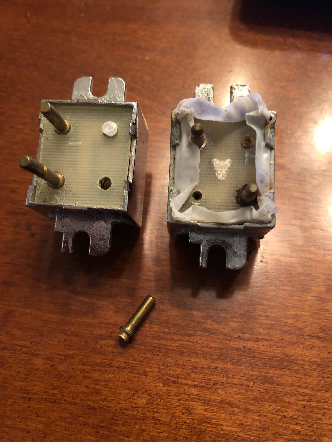

Are these pins/terminals prone to breakage and can they be fixed? The one on the right is what I pulled out of the car (original?). The other is what I had bought new and have now broken by taking the connector off the switch.

Looks like circuit board can come out easily by bending tabs. Should be able to solder post back in

Yes....after you take the switch apart and clean off the burned contacts and apply some non-conductive grease to keep them from burning in the future.
