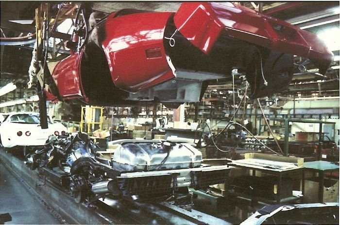

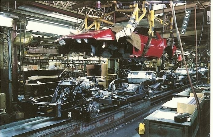

Body drop at St. Louis. If you look these over, you can see a great deal was installed before body drop.

Love those pics , that automated jig has 8 contact points on the body ! a bit more elaborate than the 4 strap harness you can buy online now days . I would not install headlights and then try to hang a customers body from 4 straps , its already nose heavy with out the extra weight up front .
