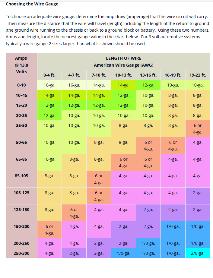

Is there any modification I need to do to my wiring to install a high amp alternator?
Powermaster recommends increasing the size of the charge wire from the alternator to the battery. Recommendation regarding the proper wire gauge can be found here.

When upgrading to a higher output alternator you should always install a larger wire between the alternator and battery . Even with a standard output alternator you will get better performance and life out of your alternator if you upgrade the main battery wiring. The original wire just isn't large enough for proper power transfer. If you are using your alternator to it's maximum output or when you upgrade to a higher output Alternator you must increase the wires size. An alternators ability to send the power it is making to the battery is directly related to the wire size and quality of connection between the alternator and battery. Also, a wire that is to small when used on a high output alternator can cause the power to back up within the alternator making it overheat, burn up and fail.

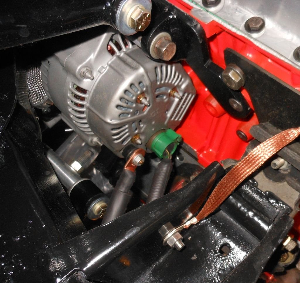

I have run an extra #6 wire from the alternator to the a power stud down by the starter where it ties into the rest of the harness. It also has a fusible link. I also added a grounding strap from the alternator to the cylinder head so I am not relying on the alternator mount for a ground.
By doing this, I am avoiding pumping 100+ amps thru factory wiring designed for 40 amps, plus factory amp gauge no longer pegs under load.

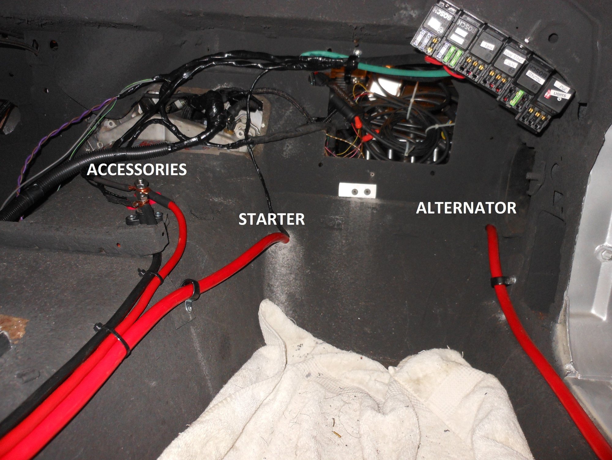

I run a 1/0 directly from the alternator to the battery and then EVERYTHING else off the battery. I have a lot of electrics- Electric power steering-Electric fuel pumps-12 Fuel injectors- 12 coils- electric AC compressor- Dual electric fans-upgraded headlights 80/100w- electric headlights-etc I also added a bunch more grounds...
This same wiring is done by BMW ($100K car new)- wired directly from the alternator to the battery- then everything off the battery.
