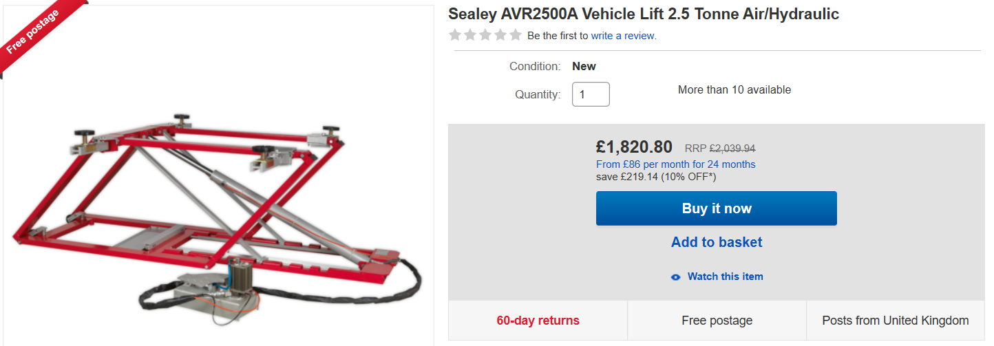

Originally Posted by Stroh
What lift is this? I'm interested.
Mine is an air over hydraulic but they do electric versions. I recall mine was £1,100.00 thereabouts and it's paid for itself in a couple of years. The only drawback is it came with a long handle, bent at one end that locates into a hole and lets you lever the end up so it rolls on wheels mounted at the other end. Mine soon snapped so I rigged up a double 90 bracket and use a floor jack which is easier than the tool it came with. When down you can leave it under the car unless you're super low..

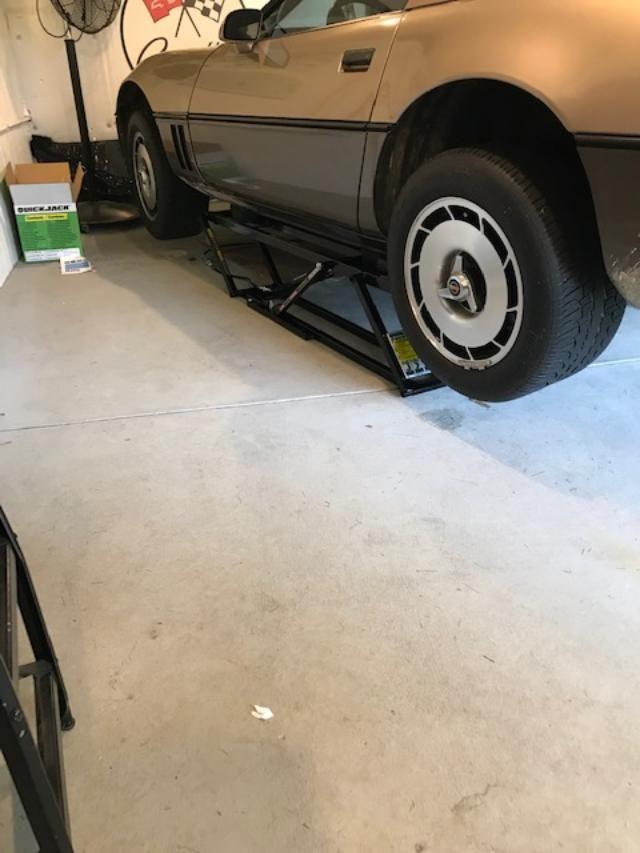

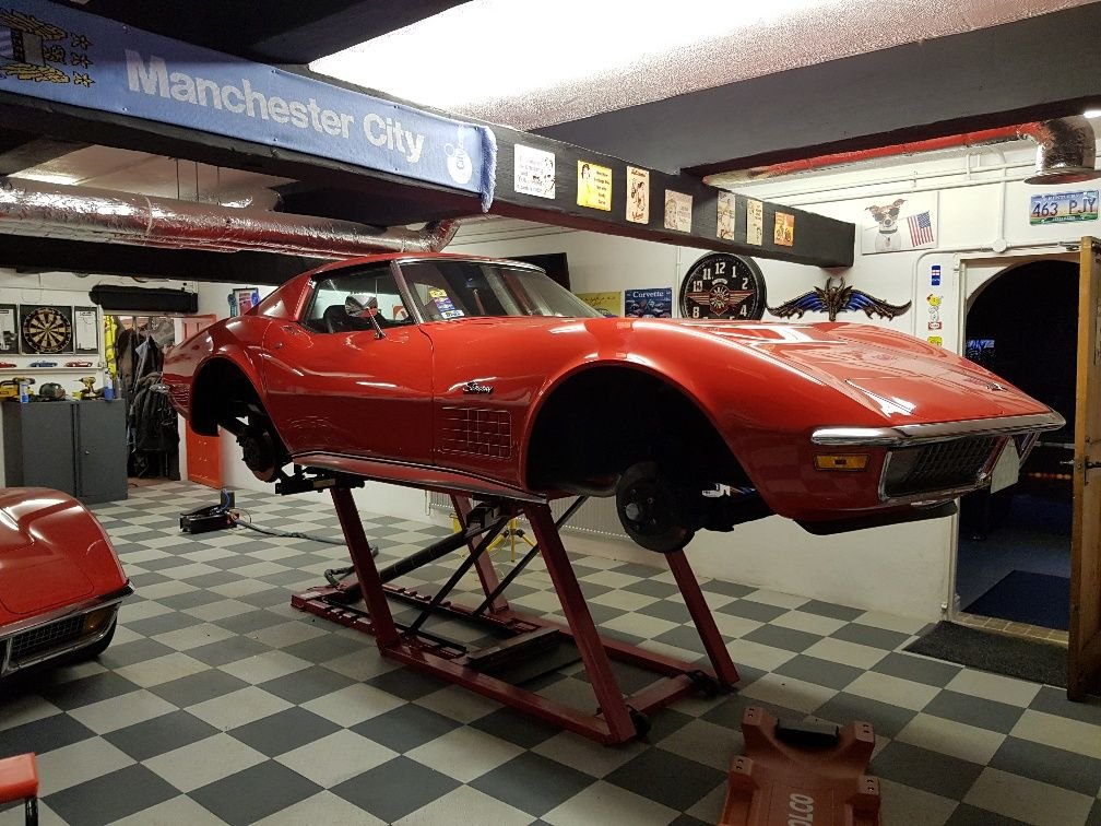

Originally Posted by brit vet
Stephen, you can get one of these portable lifts for the same costs and whereas the QJ looks to be limited to 20" of lift give or take an inch, these raise much higher as you can see. Mine uses compressed air but they do electric versions as well.
I would lean away from this just because you are blocked from getting under the car almost entirely. My Quickjack blocks the sides but I can get under the length of the car from the front or the rear. Getting under it on the sides would be better of course, but I can roll around on my creeper to just about anywhere I need.
Also, returning to the OP's question(s), my Quickjack also stores underneath my car. Not sure where you'd put that wood ramp when done.

JETS C3-C4's Avatar
JETS C3-C4
Joined: May 2017
Posts: 583
Likes: 196
From: Wisconsin
Just a F.Y.I.
The Quickjack can be placed side to side of the car instead of length wise front to back. This will give you some side access under the car.

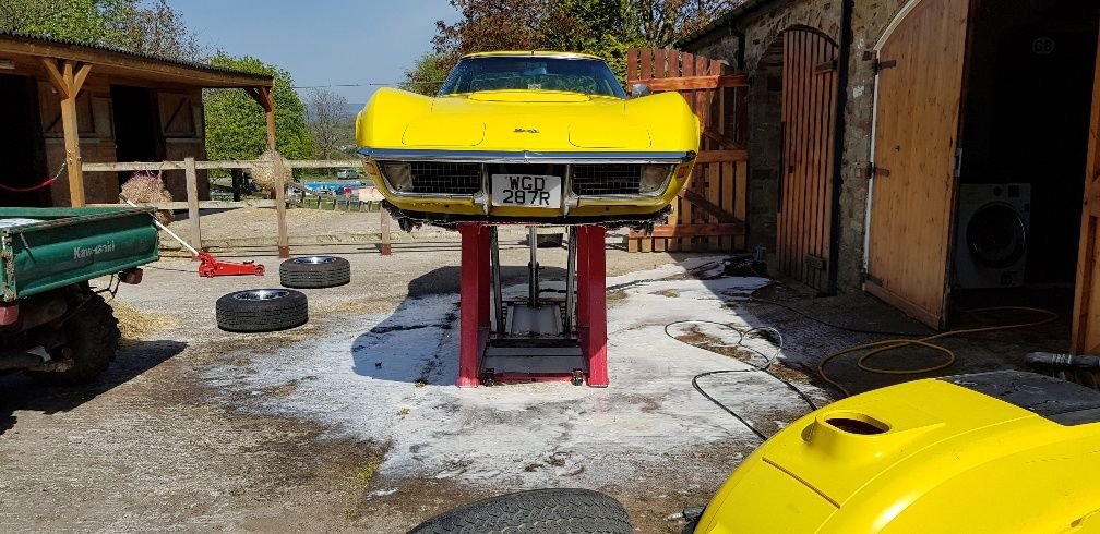

Originally Posted by Tonio
I'd want some outriggers on that thing to keep it from accidentally tipping over.
I can assure you, it isn't going anywhere.
I've even used it outside several times on less than great ground:
