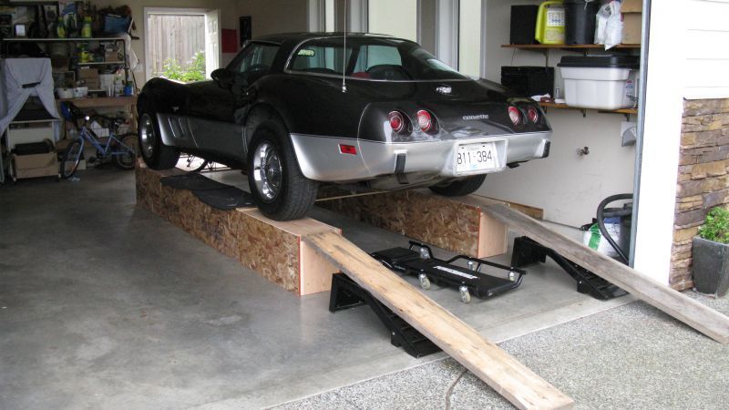

was doing a search for homemade ramps, and came across this

It wouldn't be my choice, but I guess in theory it may be OK. It all looks a bit narrow to me though, no leeway for some casual steering!
I'm just about to buy a Quick Jack system - I think I'd prefer that to the option shown here

No. That does not look safe to me. Simply getting the car onto the platforms, no matter how solid the construction, poses some safety issues. Homemade platforms and 2x10 ramps with steel ramp just-in-case understructure doesn't inspire much confidence. The wood could slip during the up and down. The weight could be too much for the OSB faced platform. How likely is it that the car could be tipped?
Quick jack 5000. $1400 would be a MUCH better option. No up and down safety concern. No tipping possibility. No way a vette is too much weight.
Granted it's more expensive than a hundred bucks in lumber, but I'd never park one of my cars up there on that wood and crawl under it.

I don't have a problem with it.

If those boxes are constructed correctly, yes, its perfectly safe. There are several threads around here on DIY wooden drive on lifts. I spent some time considering building one...but I dont trust my woodworking skills enough.

It's got great clearance, but what if you need to take the wheels off? I bought the Quickjack as well. It will do nicely until I find someone with a lift I can go over and borrow any time I like.

You wouldn't catch me under that car.

Too narrow for my steering skills.

no, that is not safe

To narrow? Depends on who's driving it on the ramps. I do this everyday. My dream retirement job!

You could Google: Home Made Car Ramp Images, get some other ideas. I have seen some platforms with LED lights inside, clever. I like everything except how the ramp attaches to the platform. Appears to be a 2 X 12 holding up the ramp. But how? Bolts? Nails? Brackets? That's the scary part. I would carriage bolt a 2 X 8 horizontally across the back, just under the ramps. It would serve double duty; holding up the ramps and locking in the two platforms from tipping.
You can put a lot of weight on 2 X 12 construction, vertically (like house studs) That's likely what's inside those OSB platforms. Even 2 X 10 would work spaced closer together.

That would be the ones I built. I also have 1/2 aluminum plates in the inside.

I would do a little re-engineering, and make it in three sections, so the center section could be removed. Be able to get under and work on the driveline and such. Probably add a couple safety features in the design while I'm at it.
Three pieces would be easier to move and store.

I have seen the dual wooden platform deal like this many times in my life and I like it.......but that one is terrible......
They get pretty creative where I come from........it is a long cold winter there and plenty of time to build study wooden platforms.
