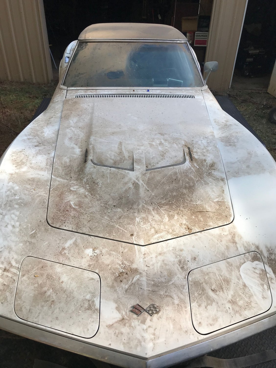

Thanks for the incite so far. I will have more information soon. I'll post the vin after I research it a bit more, I do know a bit about 68's having owned and restored one back in 77-79 at this point nothing indicates this car was anything but a 72.

Well, there is no doubt the car has been repainted. They painted right over the door jamb switch.
Get a powerful flashlight and look at the bulkhead above the differential under the car. There is always overspray from the original paint color there as the bodies were painted before they were placed on the chassis. Anyone careless enough to paint over a door switch will not have removed paint from this area during a color switch. You can also check under the carpet.

Whatever you find, "it is what it is". Understanding where it came from is merely interesting history...which could be of use to you as you work on it. Your project looks challenging but very "doable". Enjoy the refurb trip!!

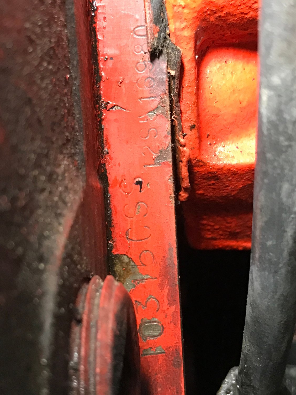

Vin # 1Z67W2S516980

Engine build date
T= Tonawanda
03= March
16= 16th day
CSS= 454 270HP air injection reactor Smog pump Automatic Trans
VIN 16980= H March VIN production 515020 to 517613 for the month
So not its original trim tag. But the engine pad stamps looks very correct and W on the VIN indicates big block.

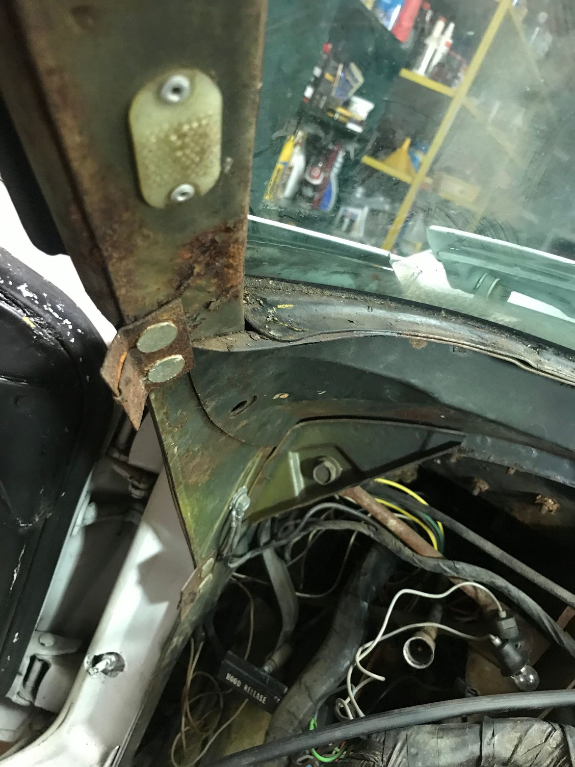

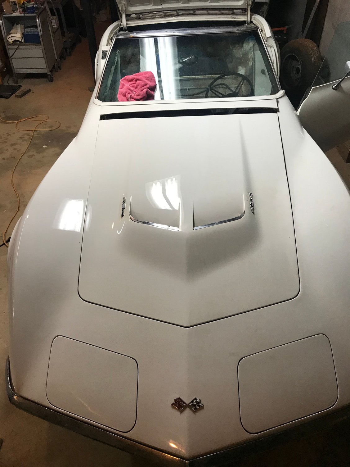

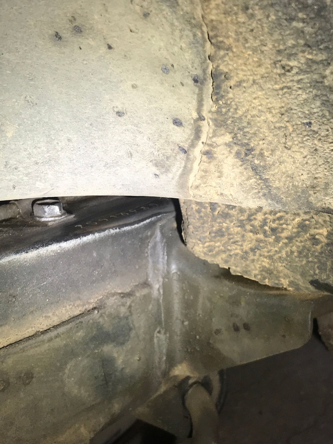

It looks to have been a white
Bird cage looks good

That's always good news
This looks like a great project brother. Good luck with it!

Ty everything looks solid so far no rust frame numbers match body lines look good, all looks fixable , the journey will continue...
