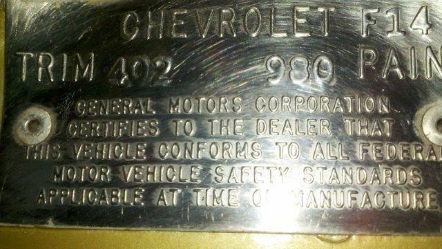

input please? Owner does not have tank sticker1969 Corvette Numbers and Decoding
VIN:​​​194379S713139
​​​713139=1397th built in January 1969
​​​Per GM shipping data report; official productiondate was January 15, 1969
Trim Tag:​​F14, F= January, 14= 14th
​​​Trim 402= Black Leather
​​​980 Paint= Riverside Gold

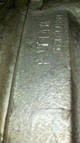

Engine Block Casting Date: J23_.8 = Oct 23, 68
Block Final Build Date:​T115 MK
​​​T= Tonawanda
​​​115= November 15
​​​MK= 427ci/400hp, Transistorized Ignition, 3x2 Holley carb

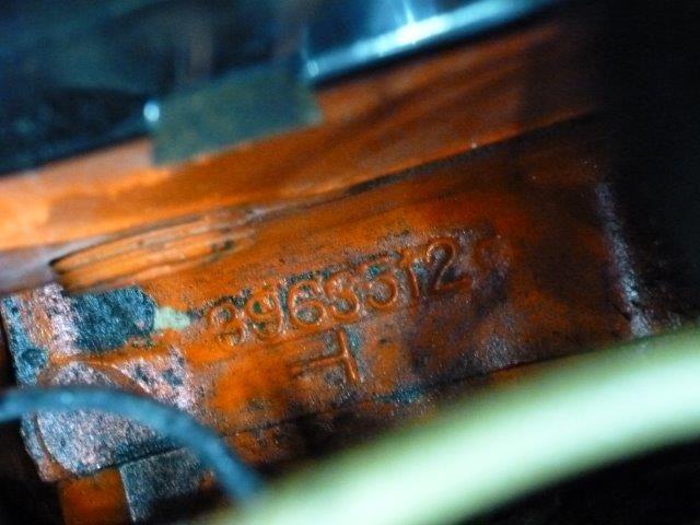

Engine Casting Code: ​3963512 = Oct 1968
Block VIN: ​​19S713139 = matches VIN Tag

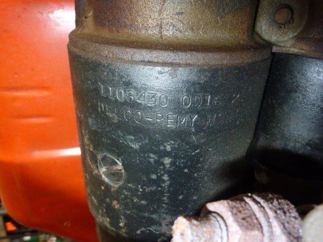

Starter: ​​Deco Remy GM High Torque
​​​0D167= 1970, April 16 (not original, starter has been replaced)
Transmission: ​​79S713139 = matches VIN Tag
​​ P8T14B P=HD Muncie, 8=1968, T=December, 14= 14th day, B=close ratio

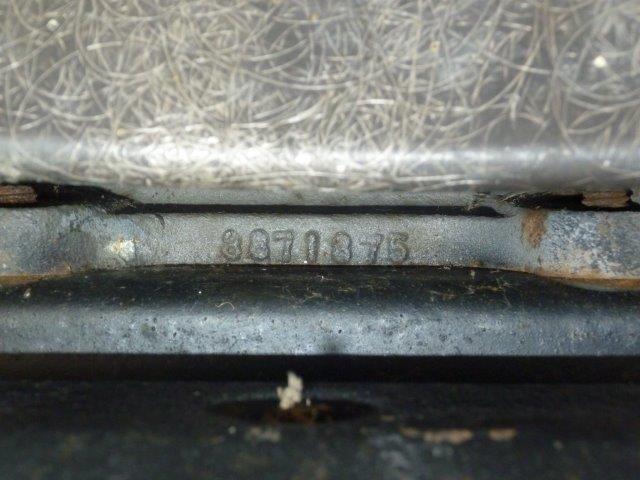

Differential: ​​8871875
1 FA _ 12_ 1=shift, FA= 3:70 HD Positraction, _ (could not read), 12=day, _ (could not read)

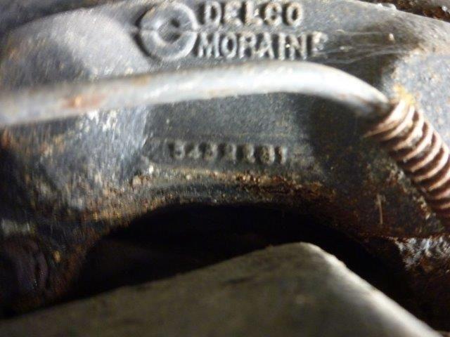

Brake Calipers:​​Delco Moraine
Left Rear: 6473080
​​​​Right Rear: 5432281
