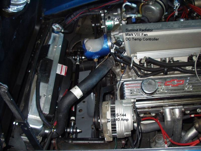

Bones1982 I had similar fitment problems with my 1968.
I got an upper Radiator Hose for a 1977 350 corvette at autozone. Fit better than the part that was supposed to be for my 68. I think I trimmed one end about half an inch (~1/2") max. I have the old part number but it's no good anymore. Give it a shot. I'll get a picture for you to see.
here you go... take a peek. It also fit well with my stock radiator shroud before I converted to the mark viii fan.
