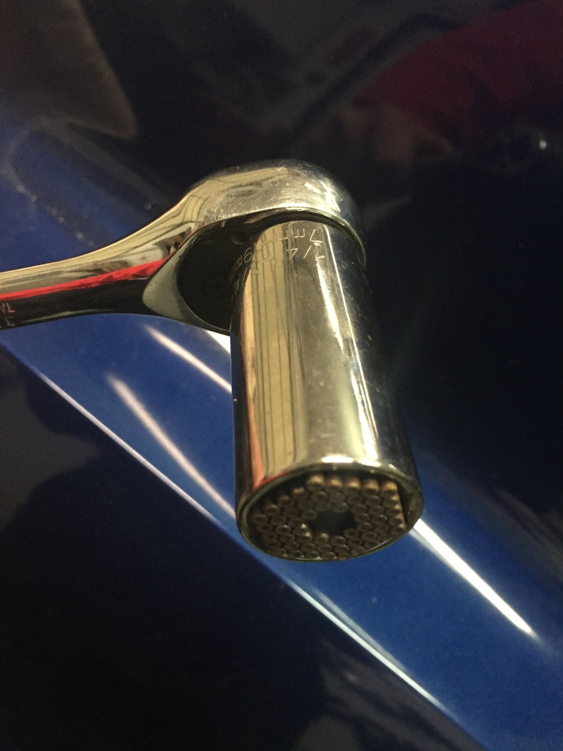

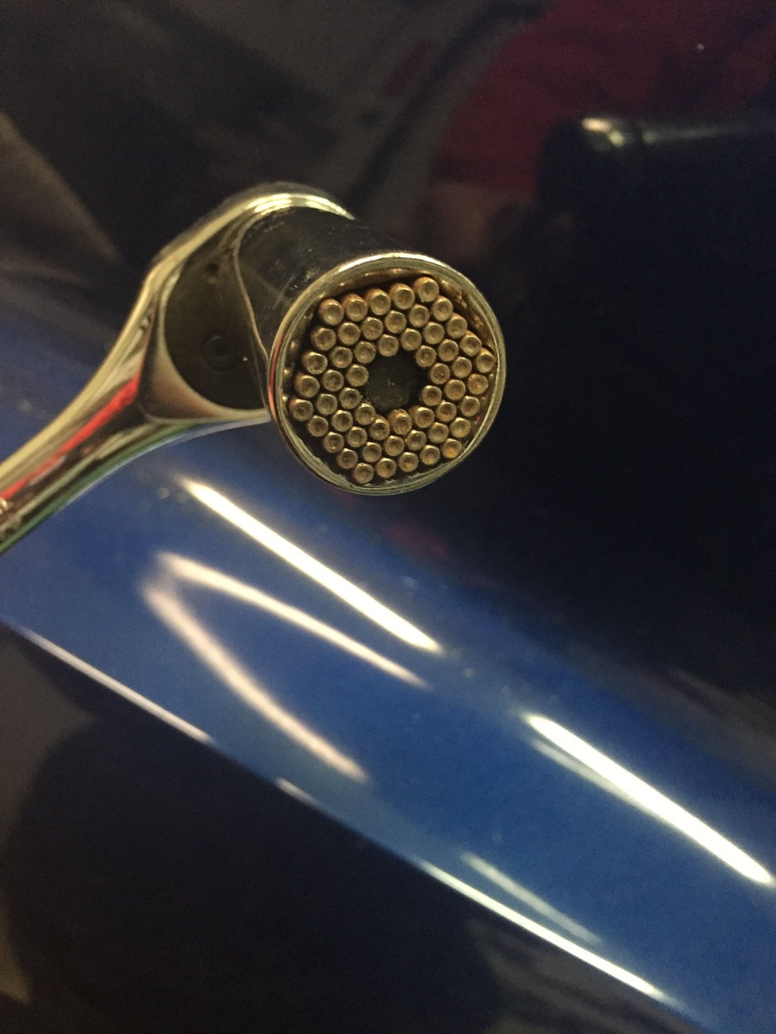

Thanks, everyone. Got it out last night. Love using my new impact wrench. It broke loose on lowest of the three speeds and came out without issue... I ended up using the special pin head socket that fits all ... and the best part: I already had all the necessary tools.
Can you post a picture and manufacture for the tool you used?
Or, if is in a set, just the set and manufacture's name.

Not sure about the name or make... AllOut or something like that. It's designed for removing stripped bolts.
Pretty handy rachet head. I'll look at the piece when I get back home and see if it has a manufacturer mark near the measurement info.

I meant to include those pictures with my thank you post. (Each pin recesses to form fit whatever you're yanking on. Pretty slick)
