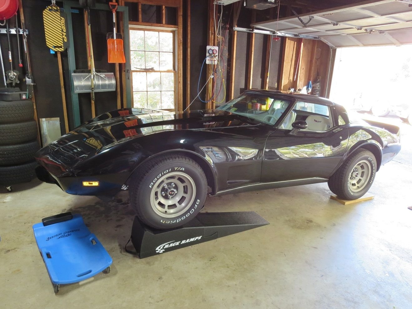

Just had a thought based on my last post.
How about 1” tall wood pads to drive the car onto? One under each wheel, or maybe just at front.
That way, I could stack the blocks which would help with clearance to the headers.
Thoughts?

From: Long Island
My 85 is lowered so I use 3" plywood drive on pads under the car, (under each wheel).
This allows the jacks to fit.
3” thick? Do you have a pic? Thanks.

Originally Posted by DC3
Sounds like a good plan. I'd put a pad under each wheel to keep things even.
Have you looked into the SUV adapters? I can't use them on my '73 while the tires are on the ground but if I get it up in the air a bit first, they work fine and give me extra height for working.
DC
I am thinking some kind of jack assist ramp plus the SUV adapters. I like those better than stacking blocks.

Update. Order 3” jack assist ramps from Race Ramps and the SUV adapters. Summit had in stock. Delivery tomorrow.
