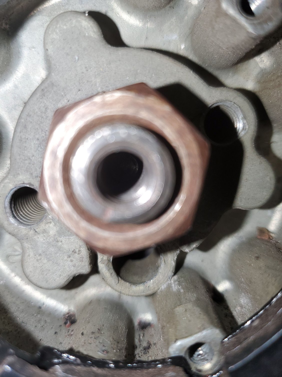

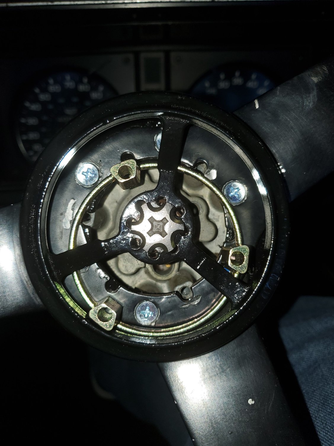

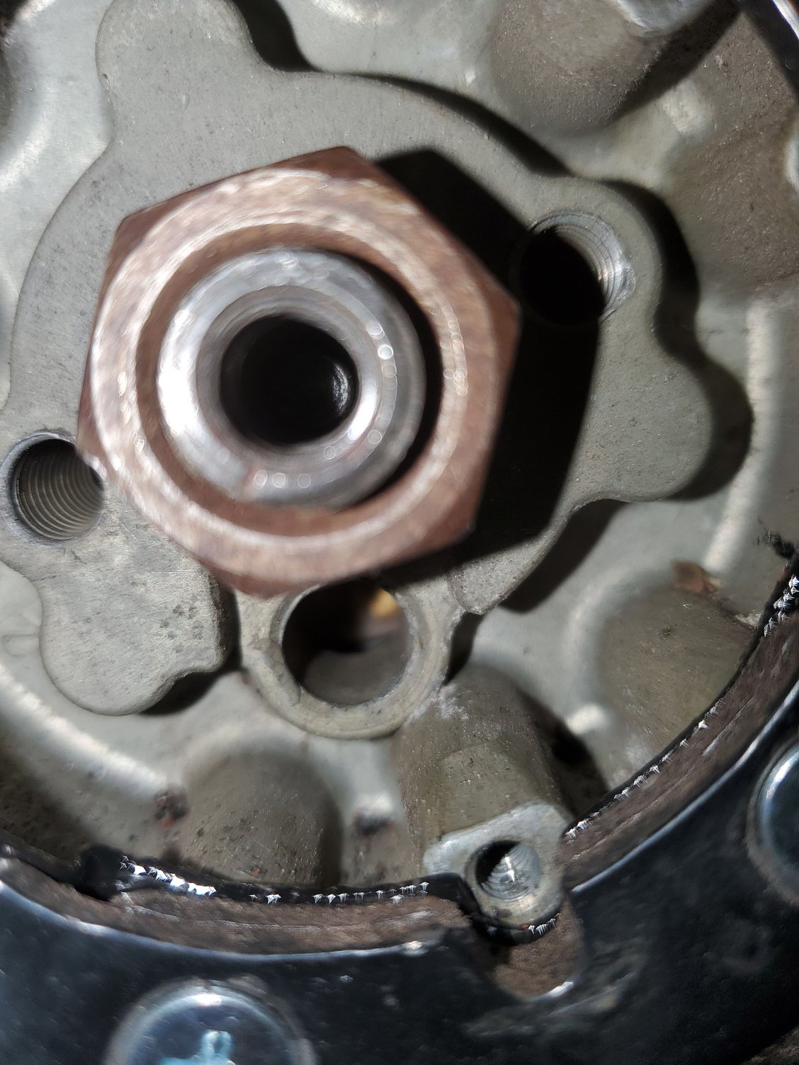

OK - I searched around and couldnt find a solution anywhere - so here we go again.
I have T&T on my '78. It has never worked since I got the car. So - I bought the rebuild kit from Willcox, and got to work recently. I ran into all sorts of the wrong screws right away - and I think I finally have those all sorted out (steering wheel screws were not flat top, so the spacer would not fit in all of the way - and then I forgot to order the Star Bolt retaining screws.. I have it all now)
So, after I did some painting, I went to reassmble today and heres what I found - I test fitted the star bolt and tightened it all of the way down to make sure it would lock. It did, so great, lets start the full assembly! I take the bolt back out, put my steering spacer and telescopic lever on, and tighten the star bolt all of the way down... it has to be soooo tight for the locking mechanism to engage that it would be impossible to adjust it once fully assembled (I tried!) .... so what am I missing here? Is my rod that the star screw presses against just slightly short? I tried to capture inside of the hole in a photo, but was having a hard time getting it to focus.
One more question - the horn contact spring and rod - those go into the largest of the three holes pictured in the 2nd and 3rd picture, correct?
Let me know what you think!
Best,
VV

Pictures always help me.....................
And then I adjust the "Star", and after many attempts it seems fine. ( its just barley snug, then back off one or two holes )
Hope that helps..............

how long is the little rod inside ?

pull the rod out. I think i removed the two bolts holding the coloum to the dash.turned the tilt all the way down, and then kind slamed the column downward so the rod would come flying out. lol
get a steel rod at home depot. its about 3 bucks for like 5 ft.
cut a new one slightly longer. file it down till it tightens the tele, but also loosens when you turn the ****/screw. its a lot of on off til you get it right. but you only need it slightly longer. like 1/16

oh yeah there is a wedge inside the shaft hole, when you insert the new rod you want to make sure its inserted properly and not forced in.

The horn piece does go down the big hole as you said , but make sure it touches the little contact.

Ok so it sounds like everyone is in agreeance that it's the rod.. how do I know when it has seated properly on the wedge?
I'll pull the rod tomorrow and report back with what I find!

You need to pull the steering wheel hub, part of the lower horn contact that should extend up through the hub is missing or broken off. If your upper contact spring and pin are put in the hub like it is, it will ground the horn and honk all the time.

OK - quick update for future lurkers.. Instead of getting a longer rod, I found an old thread where Jim Shea himself suggest a small ball bearing to make up the difference (see post #9 https://www.corvetteforum.com/forums...l-problem.html) ... so i ran down to Home Depot and grabbed a 3/16 ball bearing for $0.76 and popped it in just out of curiousity.... and it worked! So - I got the wheel back together for now. I still have to spend more money with @Willcox Corvette to get some proper screws and to get the piece @'75 suggested so i can hopefully have a horn.. but hey, its coming together!

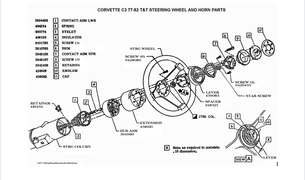

yes, th function of the star bolt is to press in the rod, which forces the wedge into the locked position.
THe lever is conected to the star bolt via 2 little machine screws. so you turn the lever you tighten the star bolt.
You need to adjust the star bolt, as such that the wedge is in the unlocked postion. when the lever is to the left, but also locked when lever is turned to the right.
the lever only rotates the strar screw about 1/4 turn; so you need to tighten the screw til it locks, and then back it up a bit til it unlocks the tele. that is where you attach the 2 machine screws while the lever is to the left.
If adjusted correctly when you turn the lever to the right, it will turn the star bolt enough to press the rod and lock the wedge.
edit: oh yeah, the lever mentioned is the one under the horn button, not the tilt lever stock on the side.
