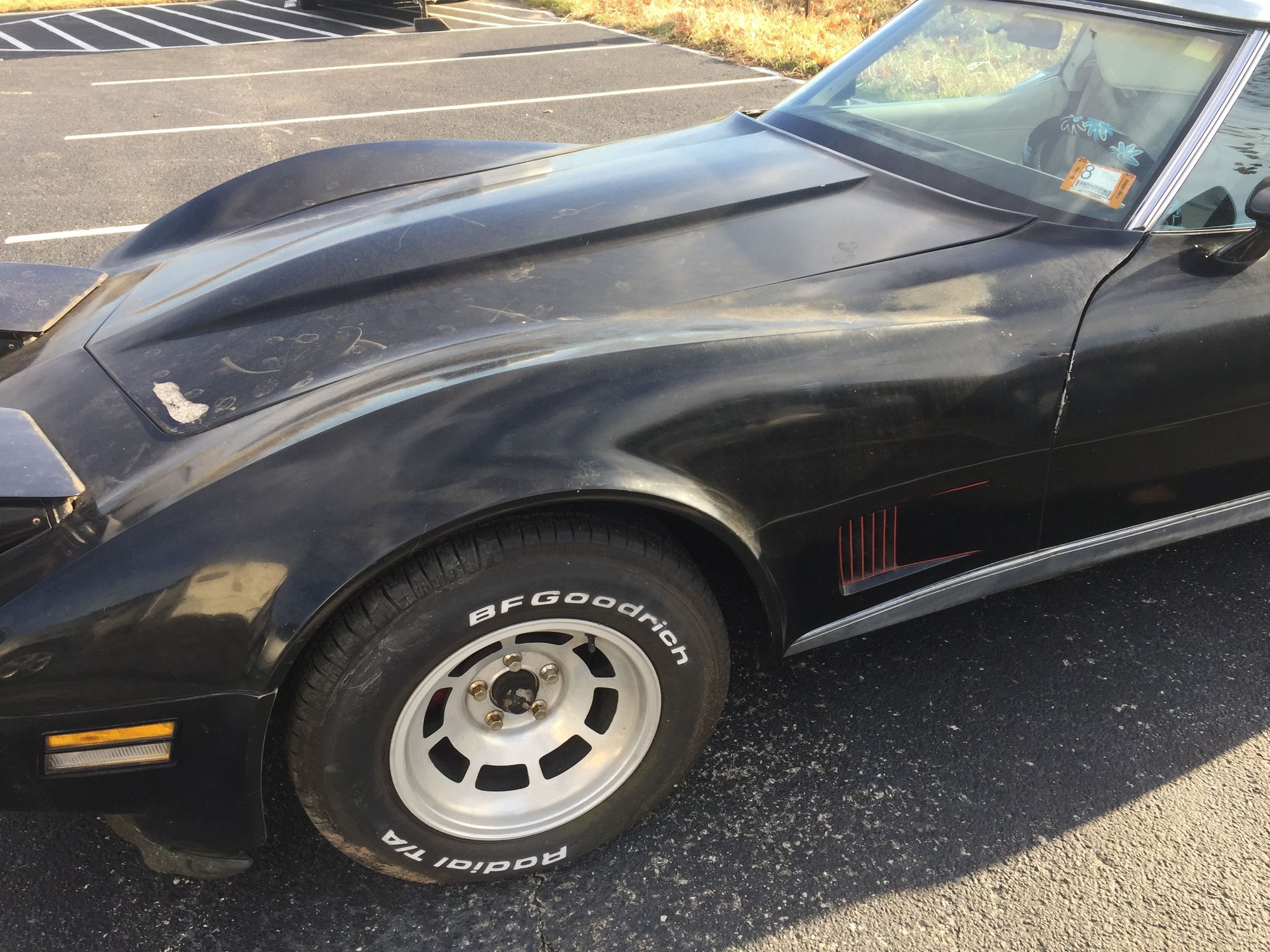

Not quite sure where to turn, stuck in a bit of paralysis by analysis, so thought I'd solicit some advice out here...
I acquired a 1980 C3 from a family member. I live in Missouri. I am very mechanically inclined, but haven't worked on a project car in a very long time. It's got family history, so I didn't do much investigating before buying it. Saying "no" really wasn't an option. It has sat outside under car covers for many years. It has seen better days paint-wise, but it is all still there (more or less), and still totally stock. It does run and drive. I knew it had a transmission issue before I got it, so that was rebuilt first. While up on the lift I got a good look underneath and didn't really see any major rust or mechanical issues. It also appears to have had the front end control arms rebuilt "recently".
Right off I know it needs to be painted and have a few spots on the body repaired. I also need to get a closer look at the birdcage to see if there are any deeper issues. I'm suspecting at least some around the windshield at the lower left corner of the driver's door, but not sure if there are more elsewhere....yet. I wanted to get it to pass a safety inspection before I can get it registered and then get it to the body shop for a more detailed inspection.
Clearly, I don't want to dump a ton of time and money into it before I at least try and get the whole picture. For example, I know it needs weatherstripping throughout, but there's no point in doing that until after paint, and there's no point in getting to paint unless I am (reasonably) sure there are no major surprises waiting. The same for a bunch of the vacuum tubing to the headlight actuators, gas gauge, interior, etc. No point in dealing with those issues yet.
There are a few smaller safety inspection issues I can address myself, but one of the larger ones is an exhaust leak on the driver's side A.I.R. tubing right at the exhaust manifold. The tubing is broken/corroded right at the center two compression fittings, near cylinders 3 and 5. Clearly, I could spend $200+ on new plumbing and then struggle (I assume) to get the old one unscrewed from the manifold. But, what are everyone's thoughts on what should I do in the longer run? If, assuming no major issues, the first thing I would do is put on headers, then sinking that money and time into those tubes right now really isn't a good bet. I could try and epoxy repair the point where the tube meets the compression nut. Certainly not a long term fix, but perhaps one that would get me past the safety inspection. Is it as much of a pain to get the old fittings out of the exhaust manifold as I think it would be? I can't see getting the manifold off the engine and then trying to get them out as any easier, but perhaps that's the way to go?
Does the idea of pulling off the emissions equipment make sense these days? Go to headers and side pipes, or at least headers and duals? Would I get that much better performance and reliability out of it? It's old enough where I'm emissions inspection exempt. I'm not 100% stuck on keeping it bone stock, but I don't know that I would want to just throw out the removed parts either, with the thought that maybe "one-day" I could put it back to original.
There is plenty to do on this. Aside from the points above, I know I have to take it one bite at a time, but where would you start?
I should add, other than the transmission it still has old oil, coolant, PS fluid, plugs, wires, etc. in it. It did run out of gas during the transmission rebuild, so I at least know it doesn't have 24 gallons of 10 year old gas in it. I put about 4 gallons of premium in hoping that'd give me some cleaning action. Do I drop in some sea foam? Change the oil first? Or maybe change oil after trying to sea foam? Same for a general tune up, plugs, wires, cap/rotor. Just trying to get a plan of action together.
Thanks!

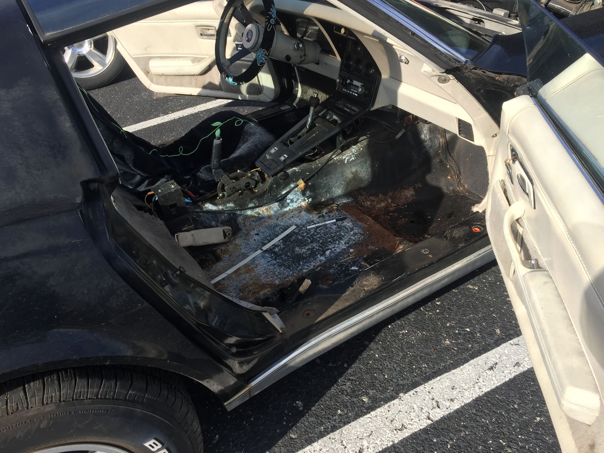

Ok, MO has safety inspection. Emissions are exempt 95 and older. So the A.I.R. system can be removed. Birdcage rust. Pull the kick panels in front of the doors and check the #2 body mounts. Paint. Do the body work and take it to MAACO. These 7000 dollar cars do not need 5 to 10000 dollar paint jobs and locked up in back of the body shop for 2 years. Here is a link to a thread about inspecting and buying a C3. https://www.corvetteforum.com/forums...orvette-6.html. go to post 107.

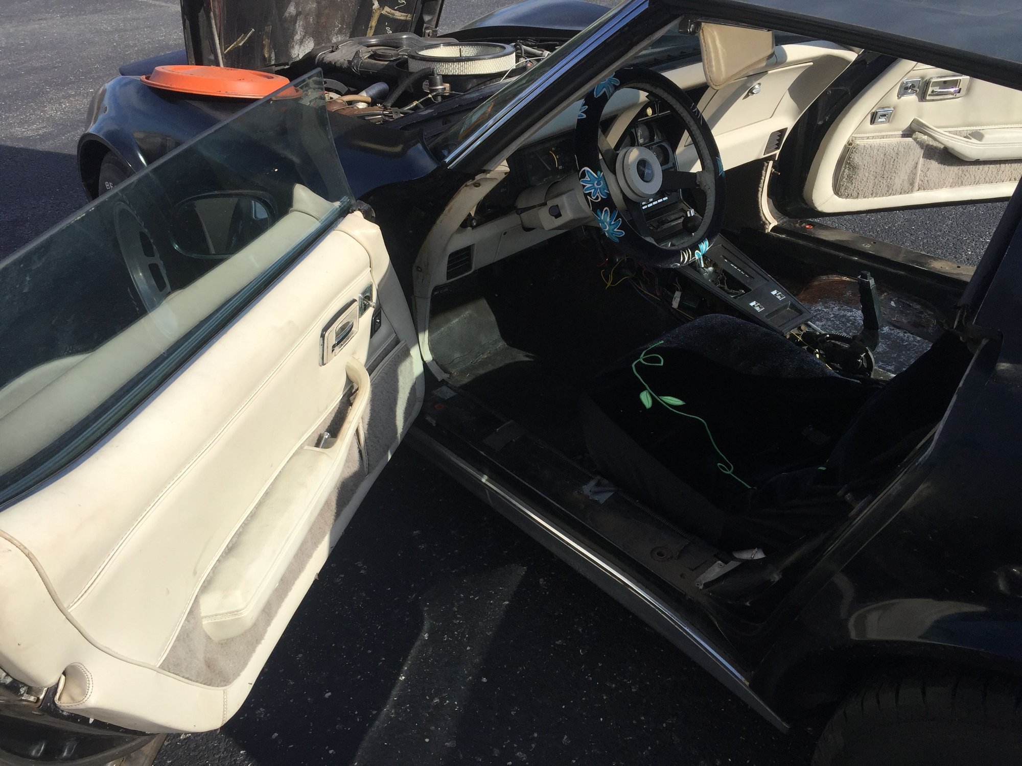

He had pulled out the seat and the carpets due to a water leak, but I have them and are in great shape. Just need to resolve the weatherstripping replacement.
Seat cover and steering wheel cover are "vintage" and clearly must be limited edition.

Looks like you are from the Fenton area. Lot of folks around that can help if needed. Make sure that the water leak on the passengers side is not from the heater core. When it warms up you need to take a ride to Creve Coeur airport, several of us rent a hanger there and would be happy to give you a hand.

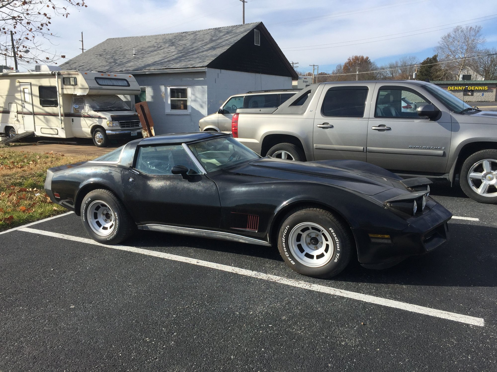

Car looks pretty decent overall. If the bird cage isn't rotted out, its worth fixing up some and getting it road worthy for sure.
