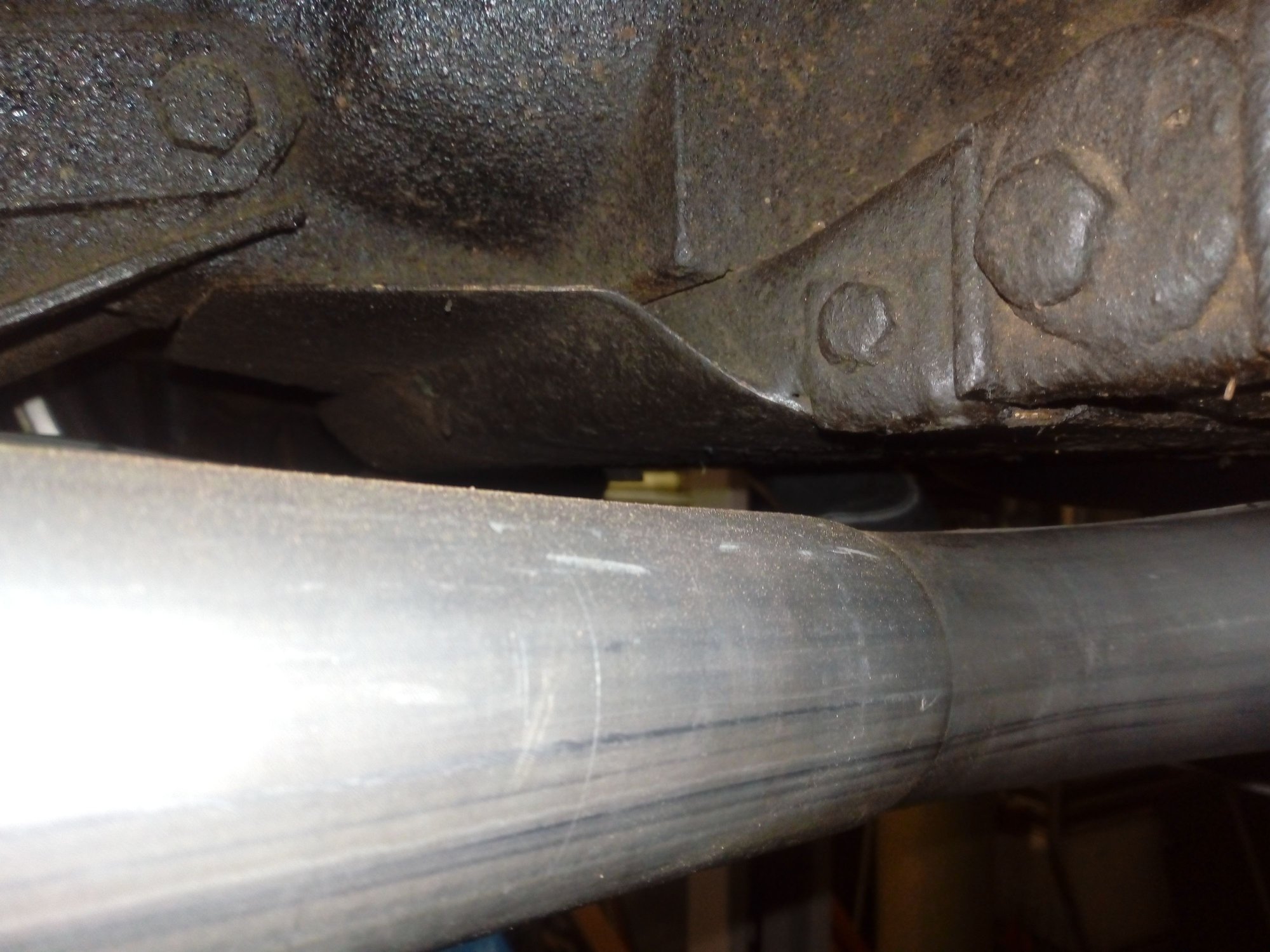

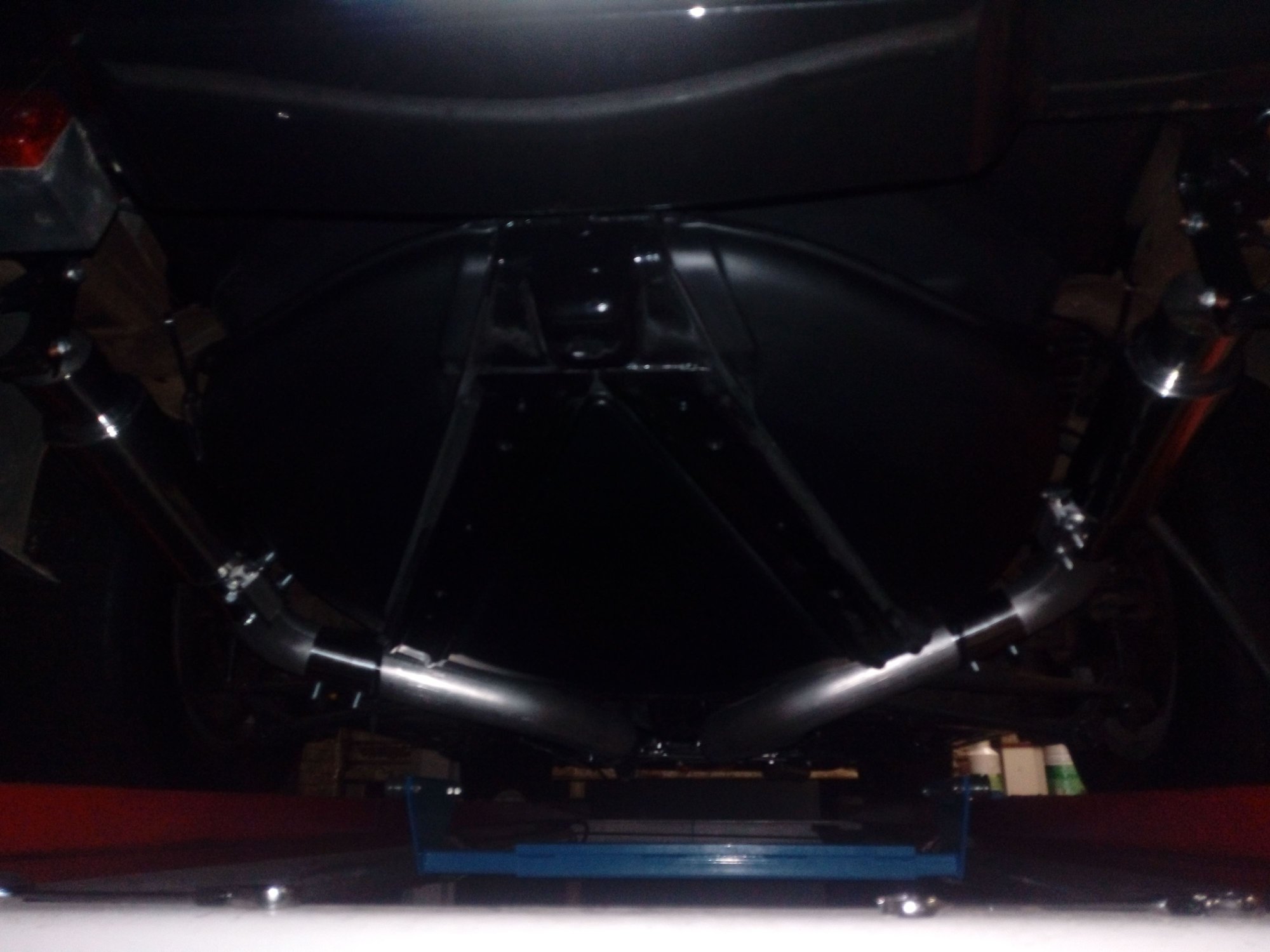

Hey everyone
What would be the ‘correct’ distance between the leaf spring bottom and the top of the exhaust running under it (1977; I'm using allen's true dual exhaust pipes).
I got about 1 cm… which I find really close to the spring 'shield' (don't know what that aluminum plate is called), but when I back it off a little more it comes very close to the street level…
I'm running longtube headers, but it seems the rear pipes that go under the leaf spring are closer to the ground than the headers flanges...
Any advice on this would be very helpful.

1 cm seems a little tight. Steel spring?
Normally they want about 1" of clearance around the transmission, you're back farther (very slightly cooler) and the differential isn't as fussy as the trans but I'd still look for more than 1cm
If it's a glass spring you'll need way more
M
Yes, it's the original steel spring.

If it was me, I'd still try to get some more room than that. It wouldn't see much movement from the engine back there but no doubt it'll touch at some point

I was just under my 79..allens duals not stainless..
i readjusted mine just now because one was lower than other..im about one inch away and im about half inch below e brake cable as a reference. Wow now im going to look at more cleaning after seeing yours
