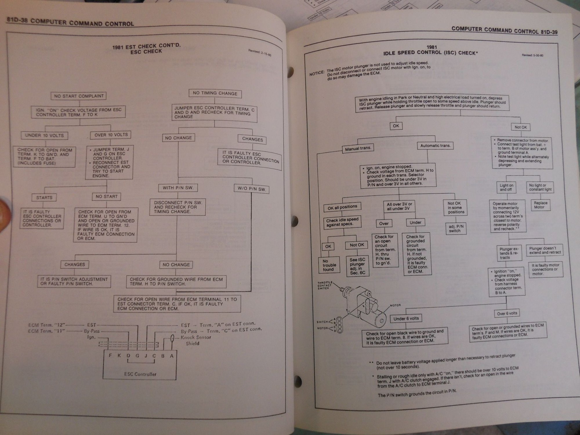

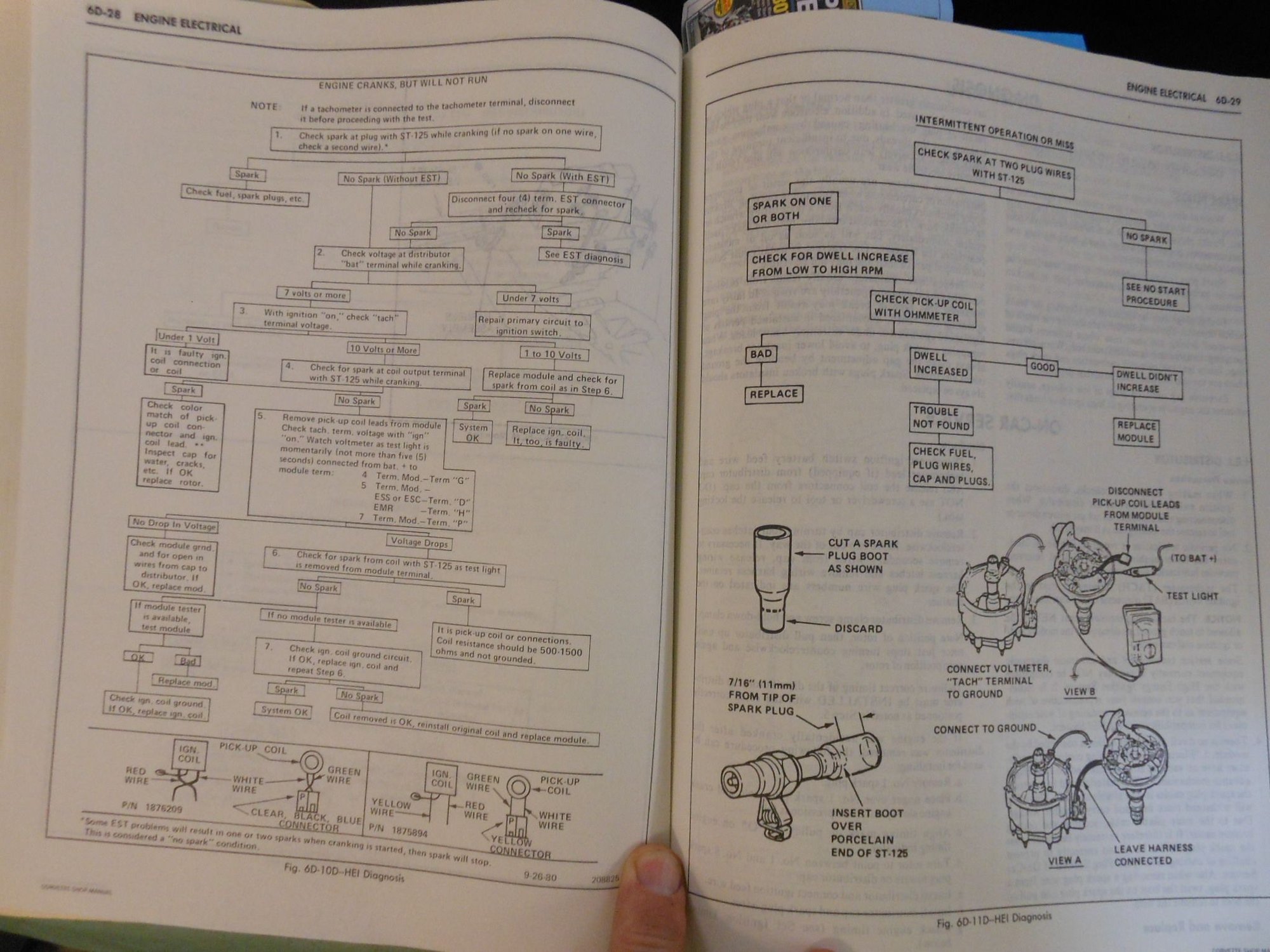

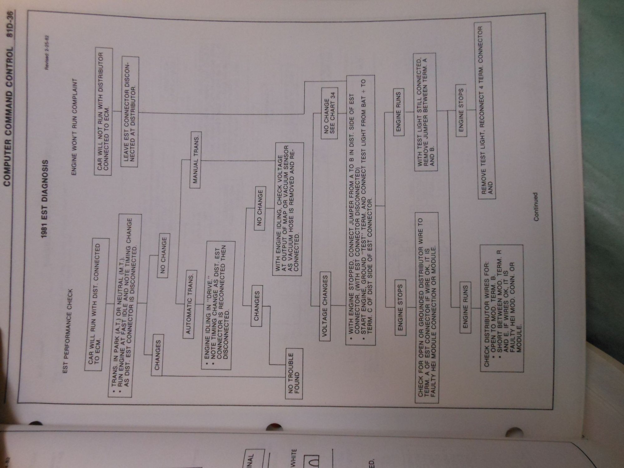

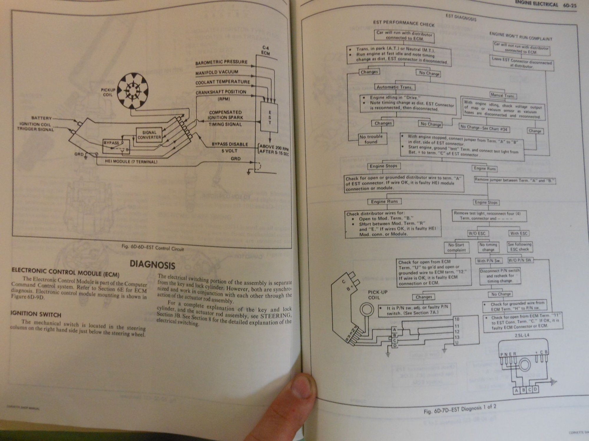

Direct your mechanic to these sheets below, from the 1981 Corvette manual.
You might ask him to reconnect the dist and pull any stored codes, if there are any. The 5-pin OBD1 connector is under the ashtray. Put a wide spade connector between terminals D+E (the two furthestmost Left connectors) on the OBD-1 connector below the ashtray. Turn the ignition key on 'run' (don't start vehicle). Watch and count the blinks. Normally it will blink once ..then twice (=12), then repeat 2x more times. Code 12 is the reference signal from the distributor ..which it doesn't see when the engine is off. After the 3rd time of blinking '12' if there are any stored codes, it will blink those numbers out. Count the 'blinks'. For example, 2-blinks followed by 3-blinks equals code 23.
If he has a snap-on scanner (especially an old one) with 'Domestic US' software that goes back to 1981 (and the right connector & cable), he should be able to read data too. But the entire system can be troubleshot with only basic voltage checks and tools he should have in his tool chest.
Follow the troubleshooting tree below.

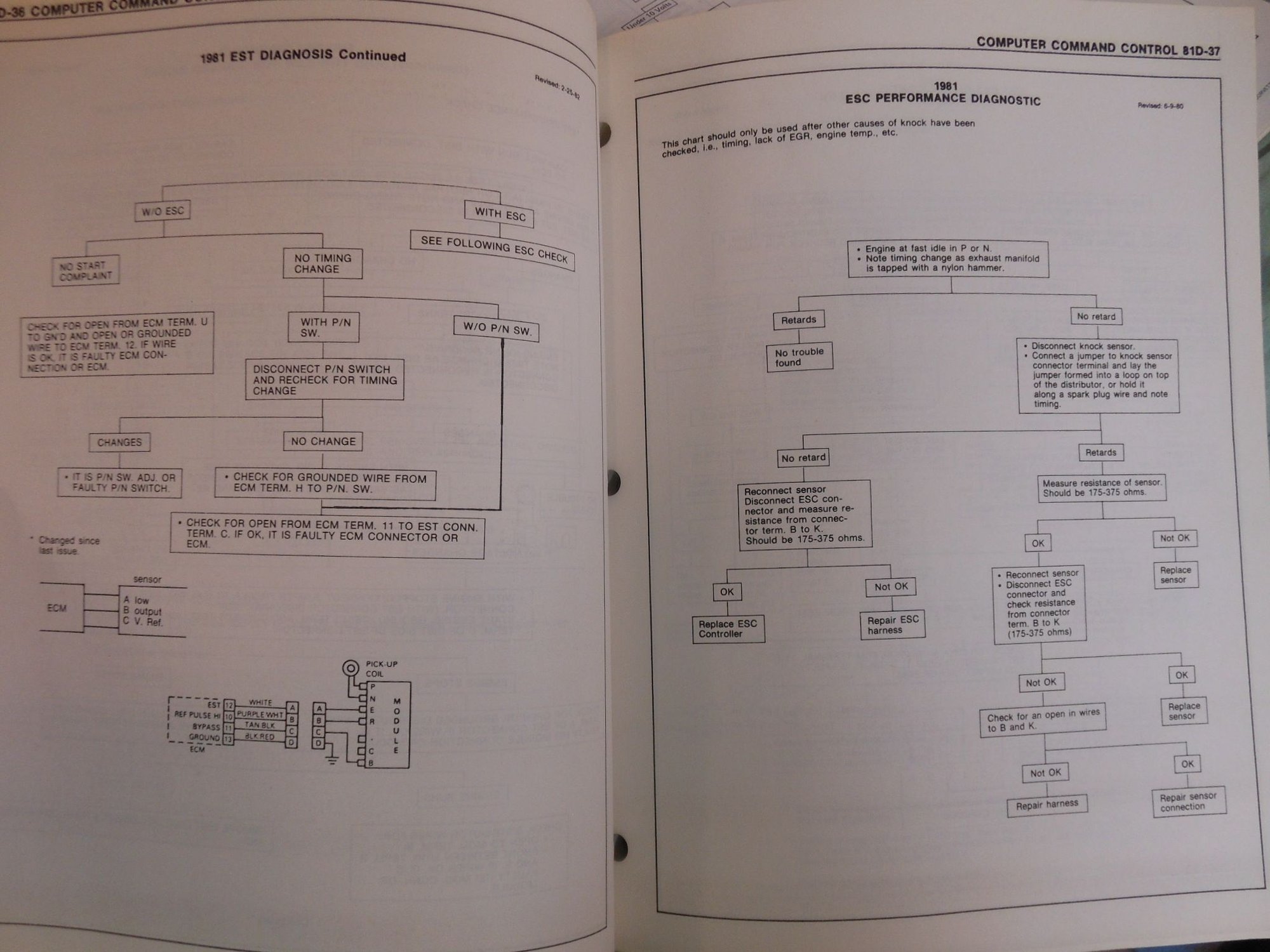

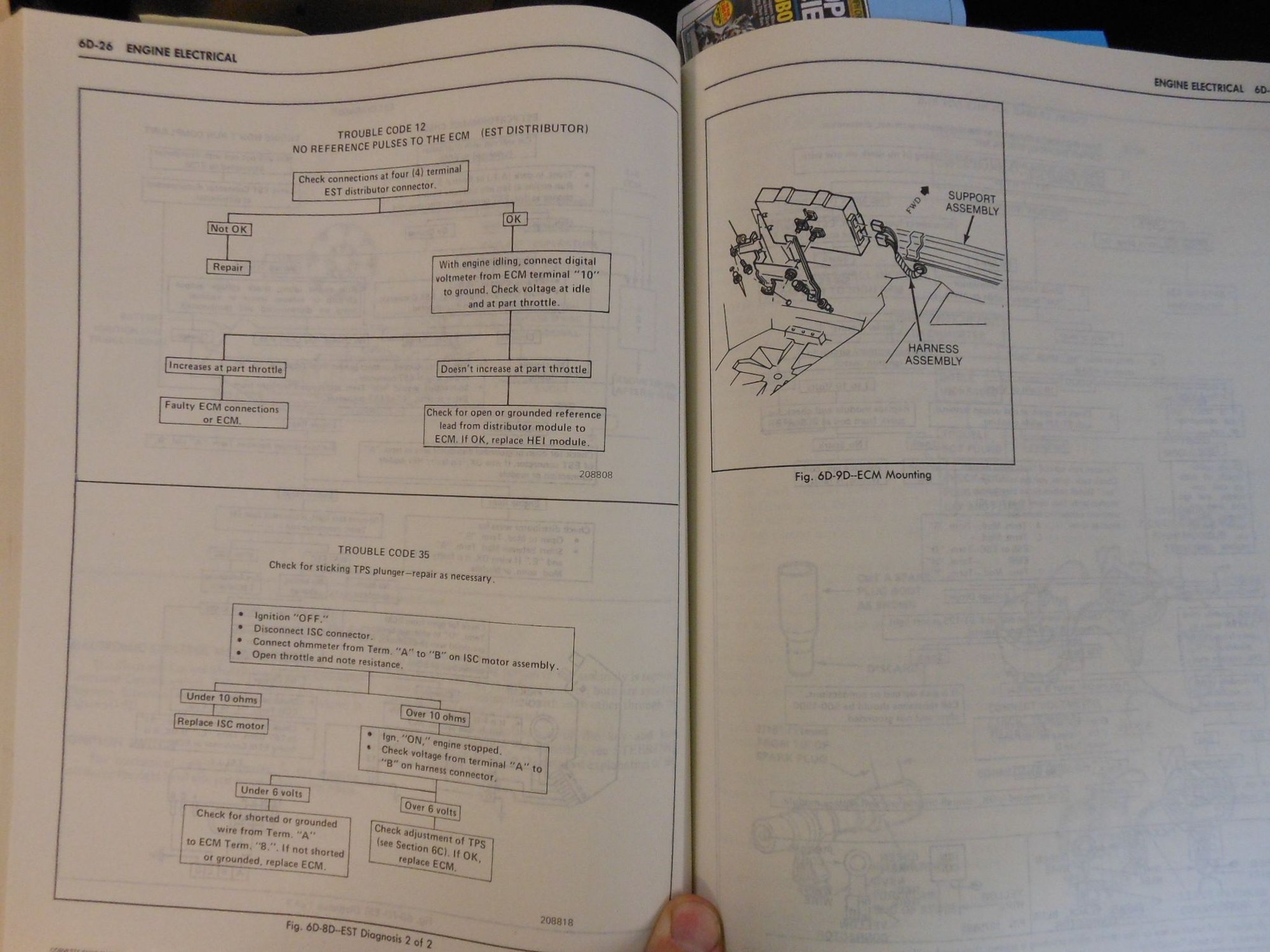

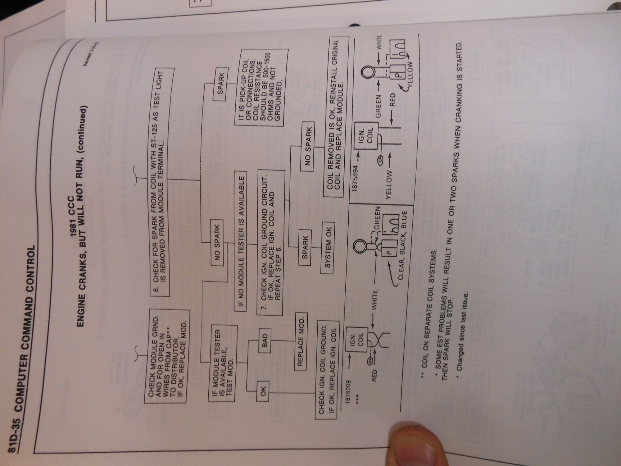

Ok, I found (in a different book) more charts in the CCC Diagnostic's GM Book 212. Start with the first two below:

thank you for the pages i will pass them on to the mechanic ,I found it relevent when one of your pages sent goes down the parth of motor running with dizzy not connected to ecm thanks.it should be very helpfull, PAUL
