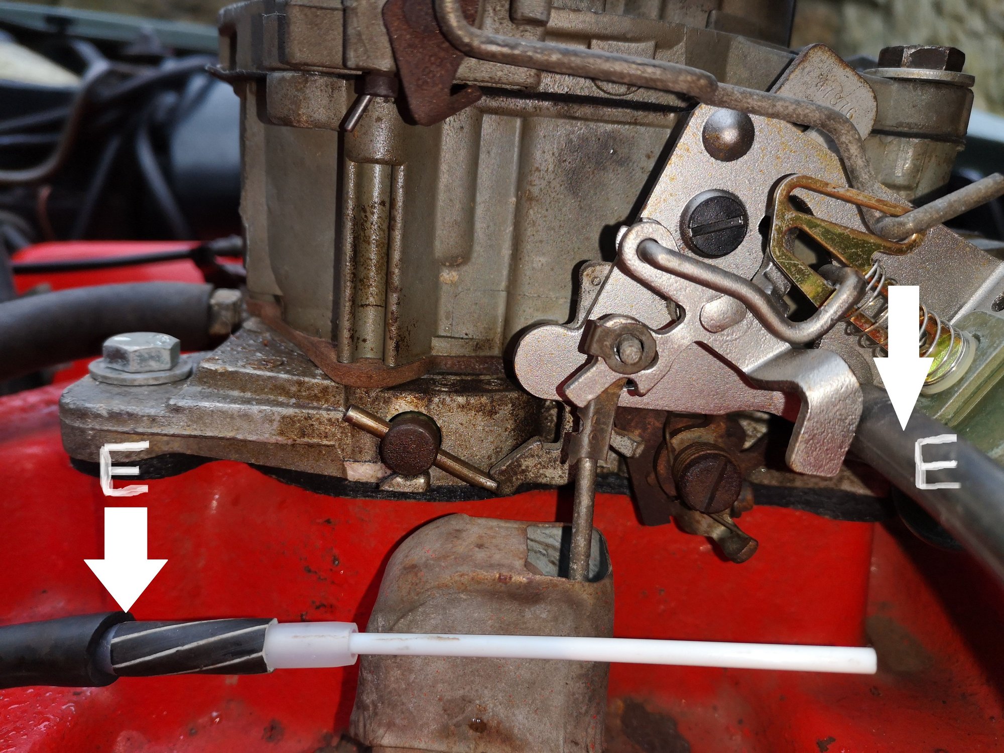

Hi All, My 72 has Just arrived in the UK from US and looking around the engine bay it seems there is no connection to the Vac advance unit on the distributor. There is a hose (marked E in photos) that attaches to the carb but the other end is hanging loose and appears it would not connect to the Vac advance as its a bit of an odd looking hose. Research I have done seems to indicate that port "D" should run to the vac advance but is currently capped off. Hose "C" runs to the valve cover breather. The engine and carb seem are not original and seem to date from different years but car has AC (now removed) auto transmittion and power brakes.
QJet part number is from 1974. PN. 7044206 C4 FA

The link below shows the set up on a 1974.
Port A connects to transmission controlled spark solenoid which you dont have..
Test port A on a running engine to insure you have vacuum at idle and above idle. If you do connect it to the distributor.
C should run to the PCV not a breather.
D runs to a thermostatic valve which you dont need.
B is a little puzzling it seems to head towards the drivers side firewall but may not be needed in your case, it may have been used for cowl induction.
E may be for the vacuum modulator on the automatic transmission. Not sure why it has those additional pieces.

Thanks, very informative so much great info on here for me.. Not sure what you mean about port B though as it's capped off?

on my 68 I use E for vacuum advance on the dizzy. The hose E was disconnected and plugged by our friend Bubba. That looks like a ball point pen stuffed in there as a plug. Pull it out and see if it still writes, then hang it on the wall.

Well Rescue Rogers, who would have thought it, you are absolutely correct. It is indeed a ball point pen shoved in there. And there’s me thinking it was some kind of specialist cable with multiple cores.

you do not need Port B

Hose E has to be one of the greatest Bubba inventions I have seen ever!
