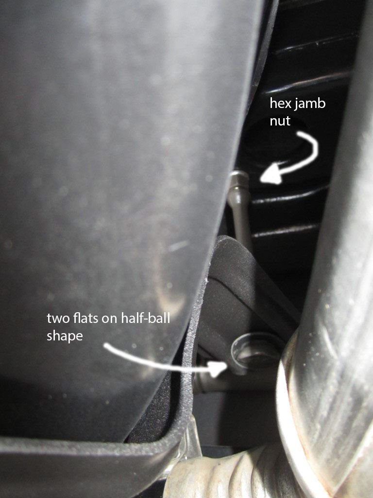

On my 72 those hanger bolts have a weird head on the end that's like a half ball/cone with two flats, the A-frame on the spare hanger rests and pivots on the that. Then up at the frame there's a regular hex nut on the end that threads into the frame, acts like a jamb nut. Certainly nothing you can get a 6-point on. Regular open end wrench, (maybe a linewrench style crowsfoot on a long extention)
Anyway, on mine you have to back off the nut jambed at the frame, then you can unscrew the entire bolt using the two flats at the lower end.

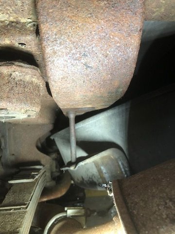

Thanks for all the help, I wet them down with PB blaster again today, Im posting pics of what my 68 bolts look like.
