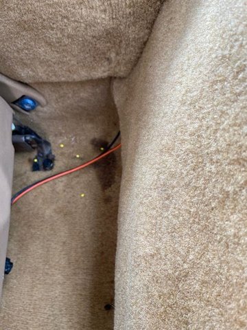

Can anybody tell me where this water is coming into the car from i dont have a garage but do have a cover and we had some rainy days the picture is of the back of the driversside seat ?

Unless the cover is waterproof, then it just absorbs water.
I would look at the t-top weatherstrip.
Maybe have someone sit in the passenger seat while you pour water along the t-top/body edges to look for drips.
