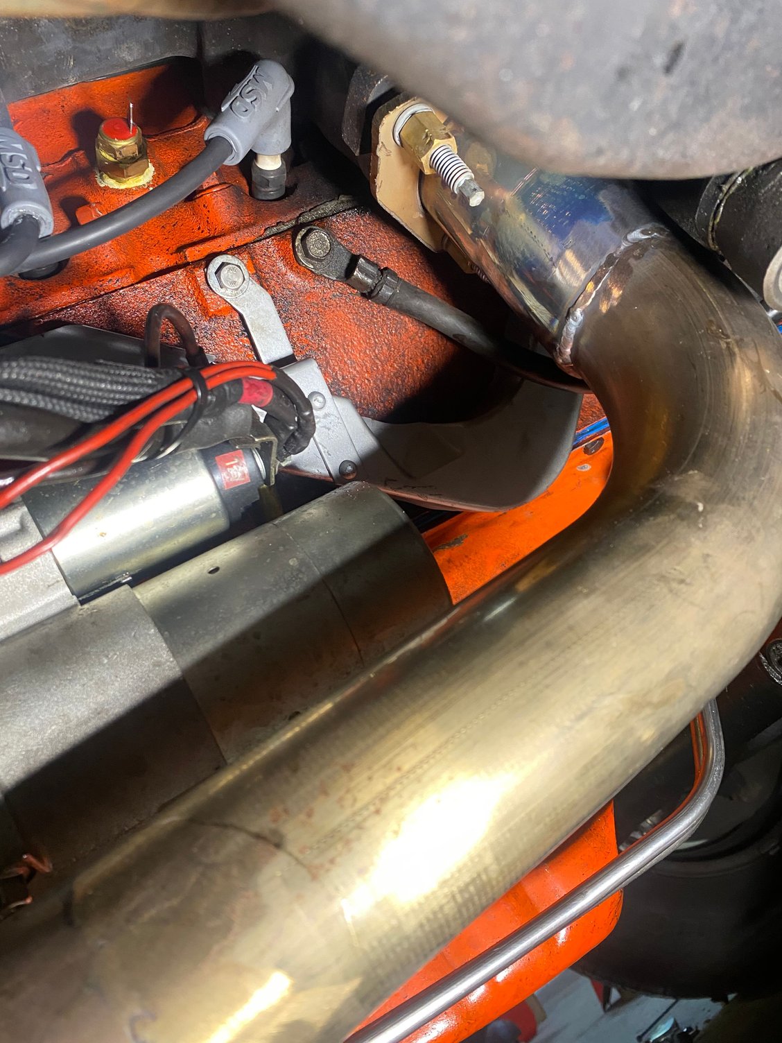

Ive melted enough spark plug wires on the rams horn manifolds both the 2 inch and 2 1/2 inch to understand why GM used those lower V shields. Ive always ran my wires away along the frame rail and I finally bought a set. Drivers side is NOS and the passenger side was used, so I sandblast/painted it and promptly wrecked the paint during installation. Not a bad job, and the wires are ran in a much better manner. Unfortunately one of my 8.5 super conductors, no. 1, came up a little short, so it will have to be outside of the top shield. What matters is the wires are protected where they need it the most.

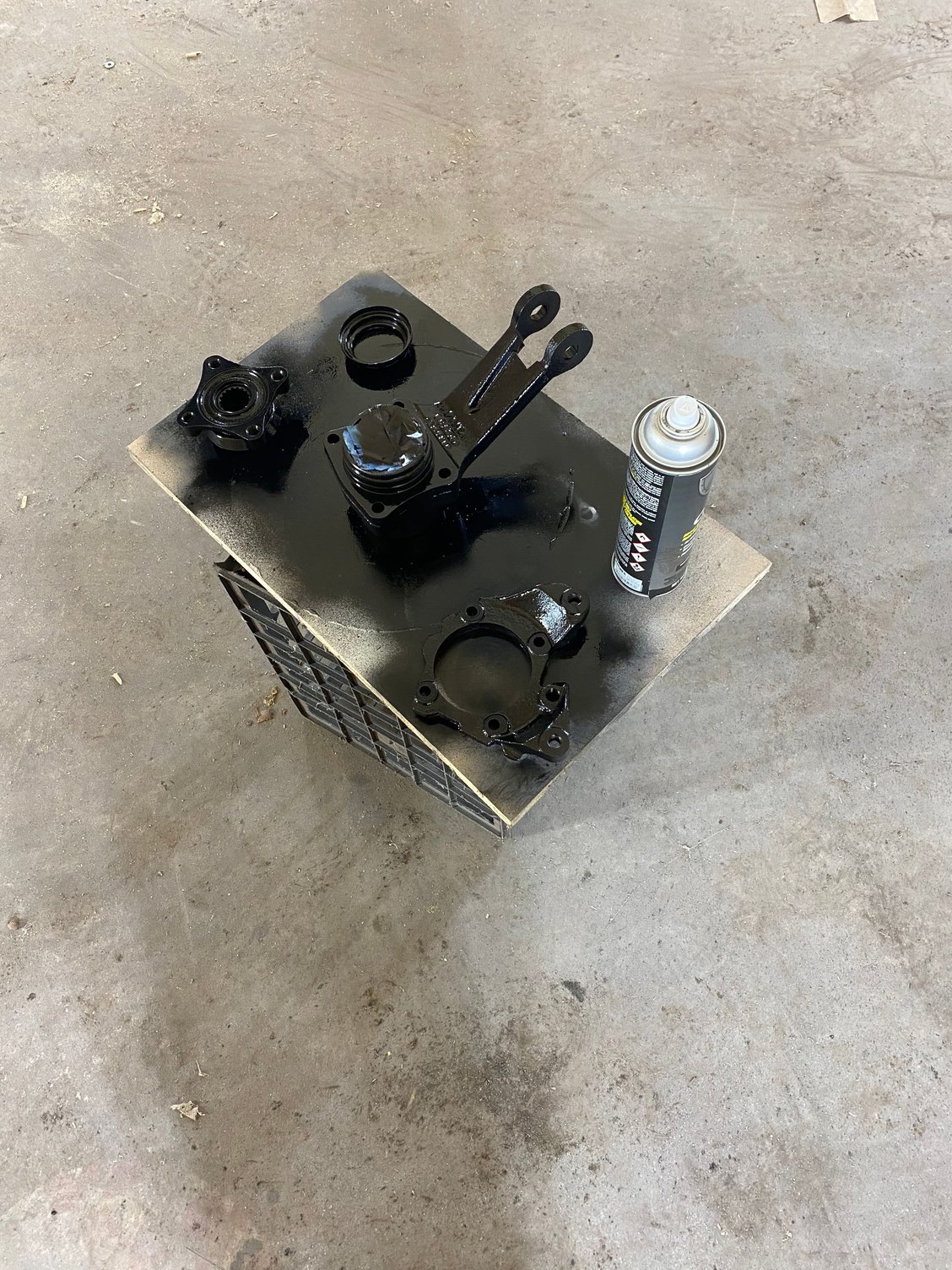

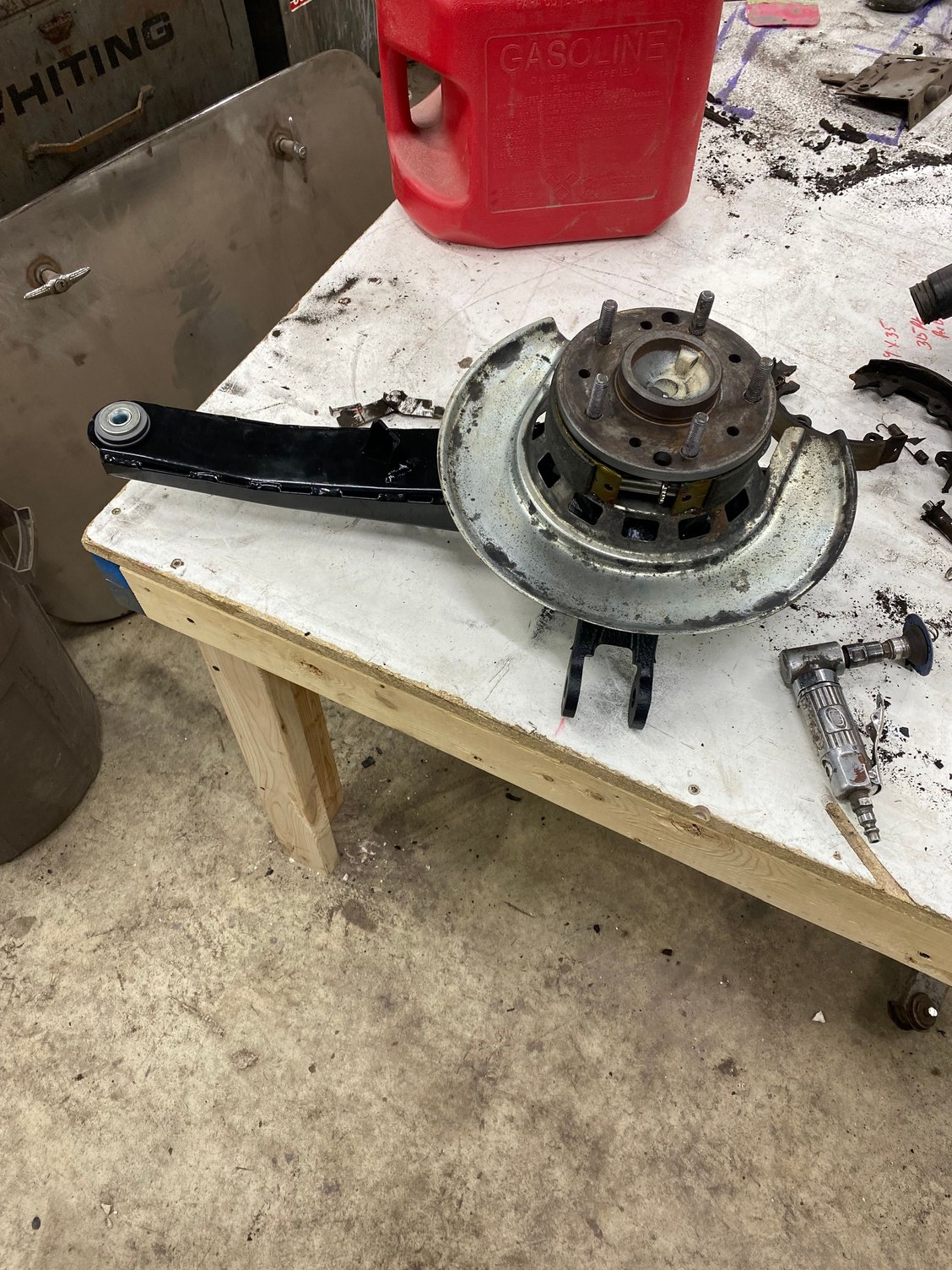

Drivers side trailing arm assembled
started on the passenger side

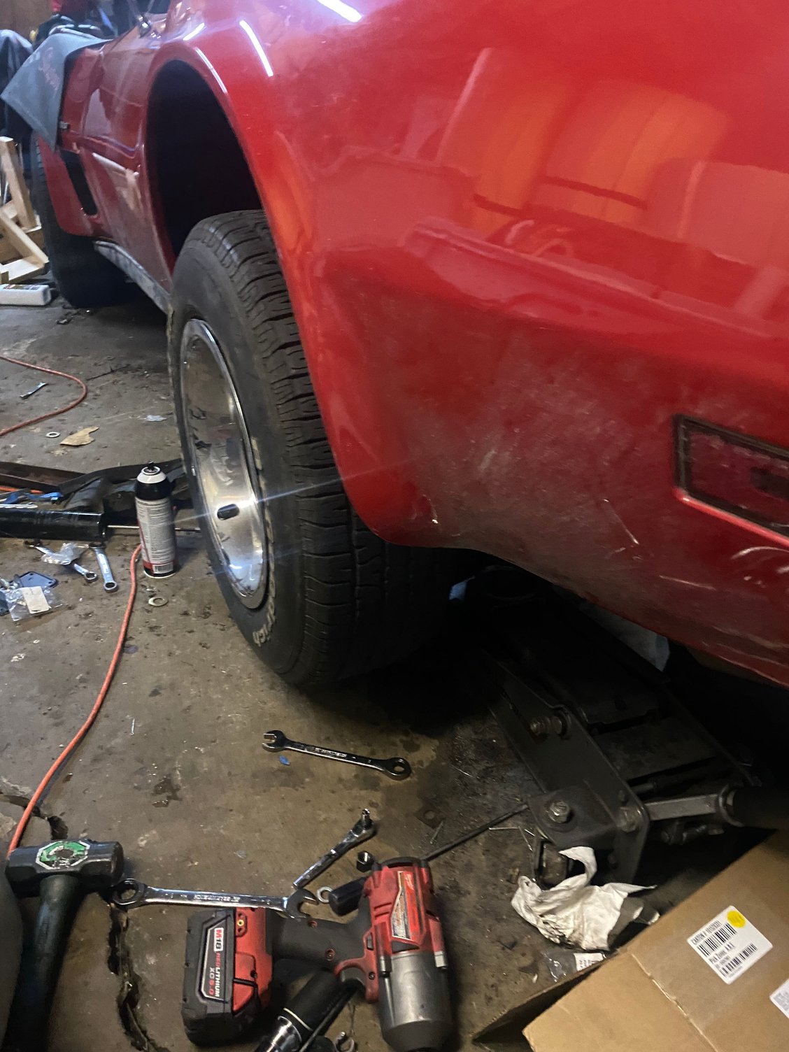

Drivers side completely assembled. Brakes, hoses, parking brake, trailing arm etc. I just have a base toe setting for now. Cant really do much until its all assembled.
Passenger headlight reassembled with new bushings and grease, took all of my bounce out. Front valence reinstalled.
Transmission cooler hoses replaced, they were weeping again, and I rebuilt the power steering pump because the front seal was damaged. Again. Drivers side rocker trim reinstalled.
I also put in a proper drain for the rubber boot around the fuel tank filler, mine was missing.

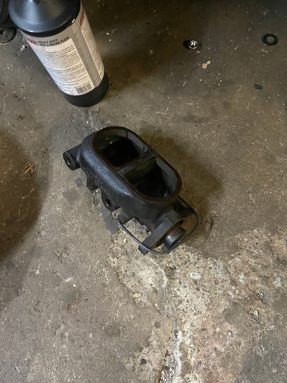

I am replacing the master cylinder because it has a bunch of junk floating in it.

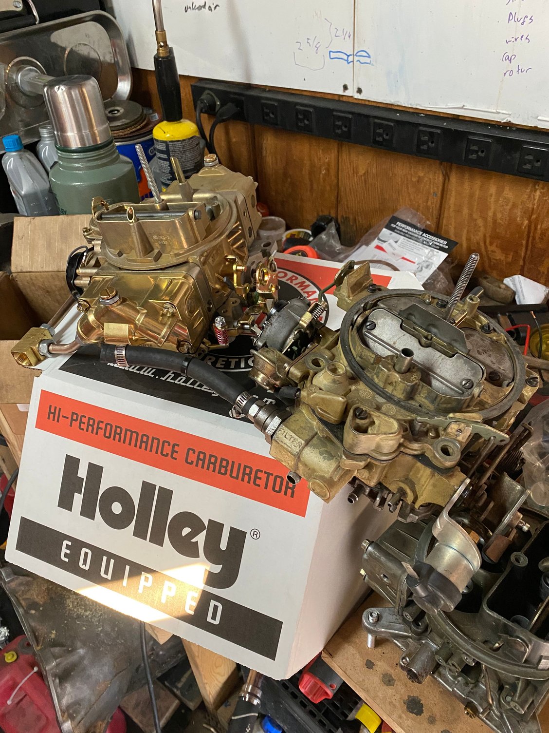

Found the carb issue. My brand used baseplate snapped… again. So I’m back with my Quadrajet to save some money.

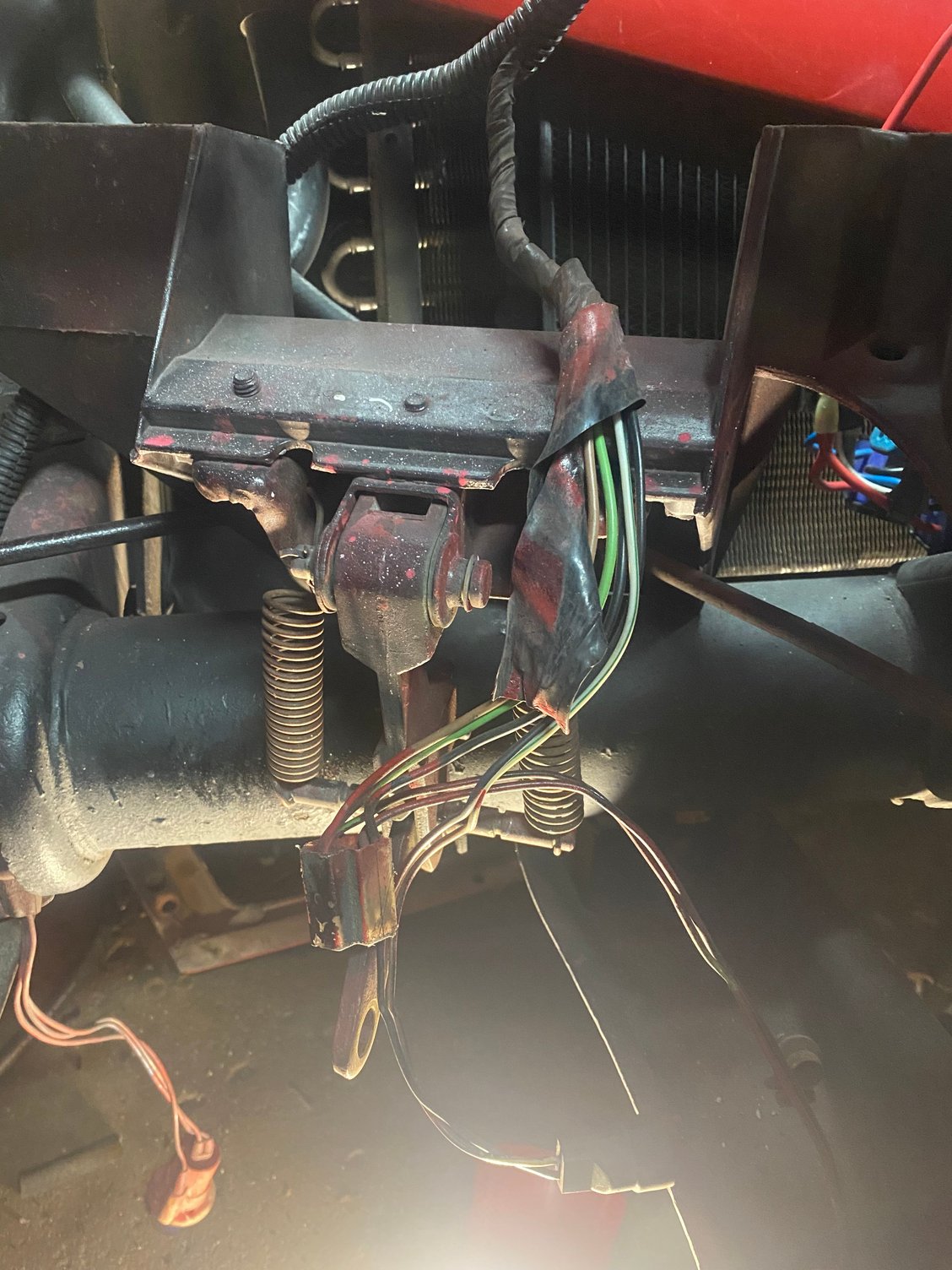

Yes sir, opens just fine, full travel on the hinges too. Actually has ~1/2 of an inch if I recall correctly. The cooler I'm using is a hayden 679 rapid cool plate and fin type.
I have it mounted to the ac condenser there in the picture with a Hayden mounting kit (with those kinda cheesy plastic push locks). The lower line goes through the same hole between the core support and body that the AC hoses do, and for the upper I drilled a hole through my core support and bent up a 3/8 nicopp hard line to pass through. The hard line is only about 5 inches long but I didn't want to shove another hose through the pass or risk kinking the hose.
If your car has AC, (that works/is fully hooked up) you might have to get creative like I did getting those lines through in that location, but if not, that pass through would be perfect for both lines. With the suction/discharge hose and hard line to the condenser its a pain to get one hose through let alone two.
Measurements of my cooler; 3/4 inch x 11 inch x 11-5/8 inch

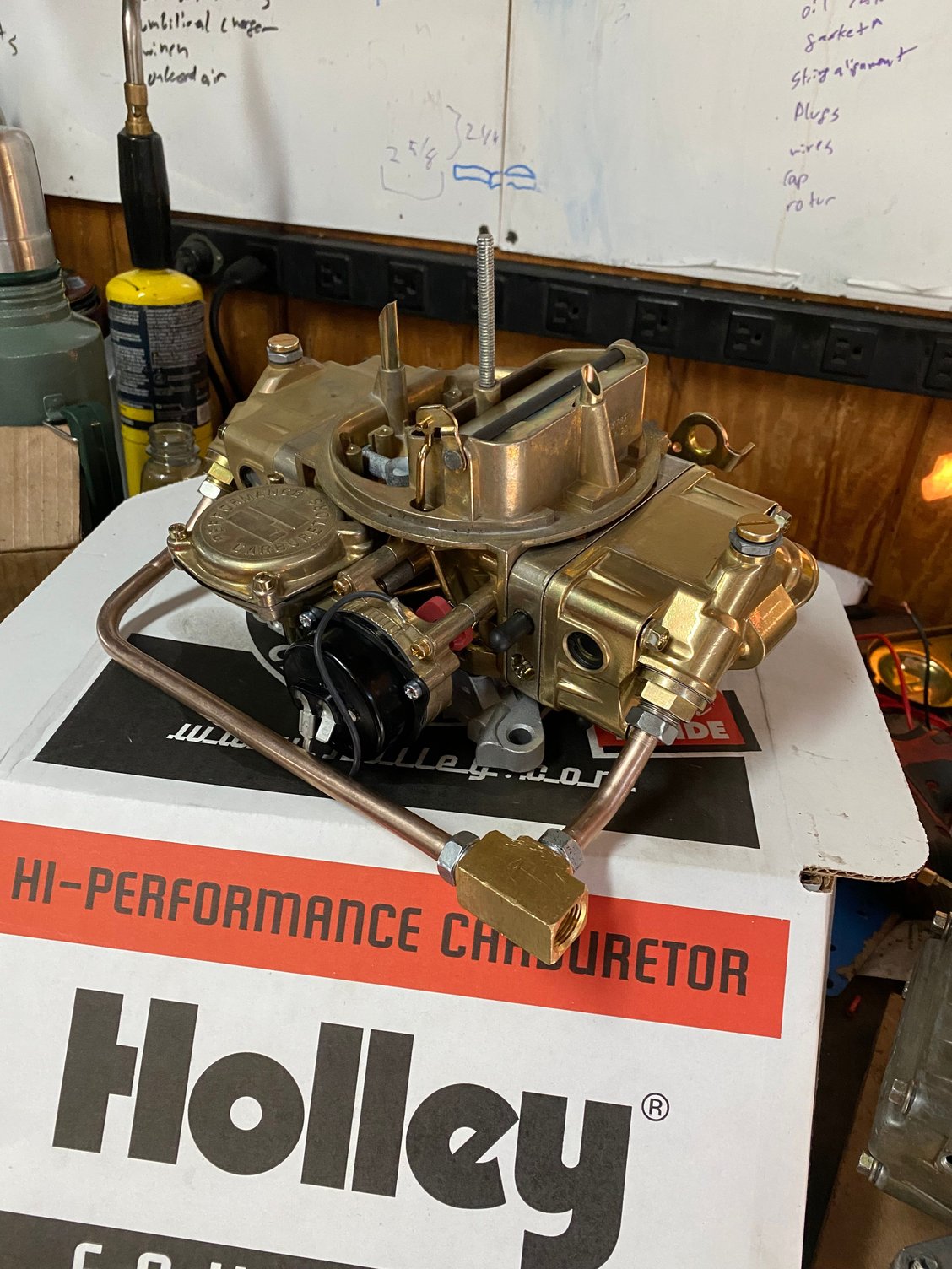

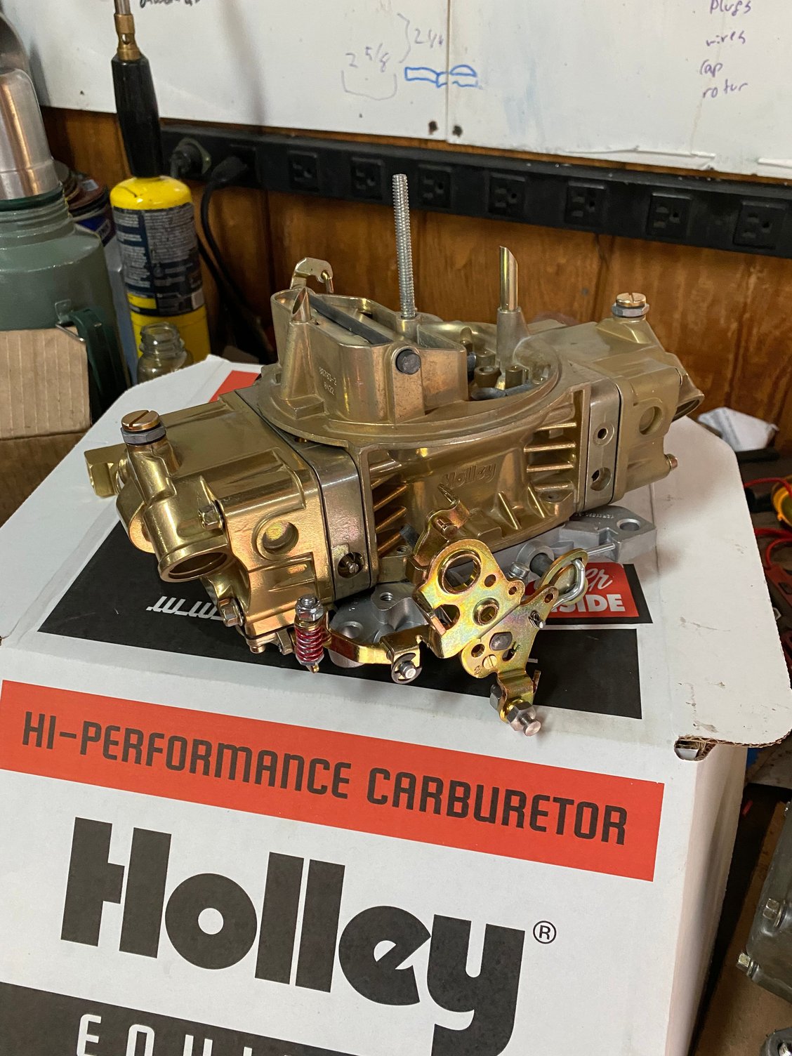

Big day today. A month and 1/2 ago I ordered a brand new Holley carburetor from Holley, because they came out with exactly what I wanted.
I wanted;
600-650 CFM
gold or zinc dichromate
vacuum secondary
Square bore
Center hung floats
glass sight plugs
electric choke
I was convinced that Holley didn't make a carburetor in gold with glass sights but I was proven wrong.
That is a 4150, P/N 80783C, its a 650 vacuum secondary in gold dichromate with electric choke and glass sight plugs.
They were on backorder and I had to order one special. It took a while but I’m ecstatic! Its perfect.
I took it apart and swapped over my jets and such from my 600 as a starting point. I converted the 4160 plate to a jet size (“6” plate = 68/9) and Im using 64s on the primary. Idle is perfect, anything over 2K rpms is very strong and the motor pulls just like I wanted it to. No secondary stumbles. I am still in the process of getting it fully tuned though, I have a part throttle stumble but its a given that you need to fine tune a brand new carburetor. I had to modify my air cleaner further to clear the longer 4150 and make a new fuel rail but that wasn’t a big deal.
