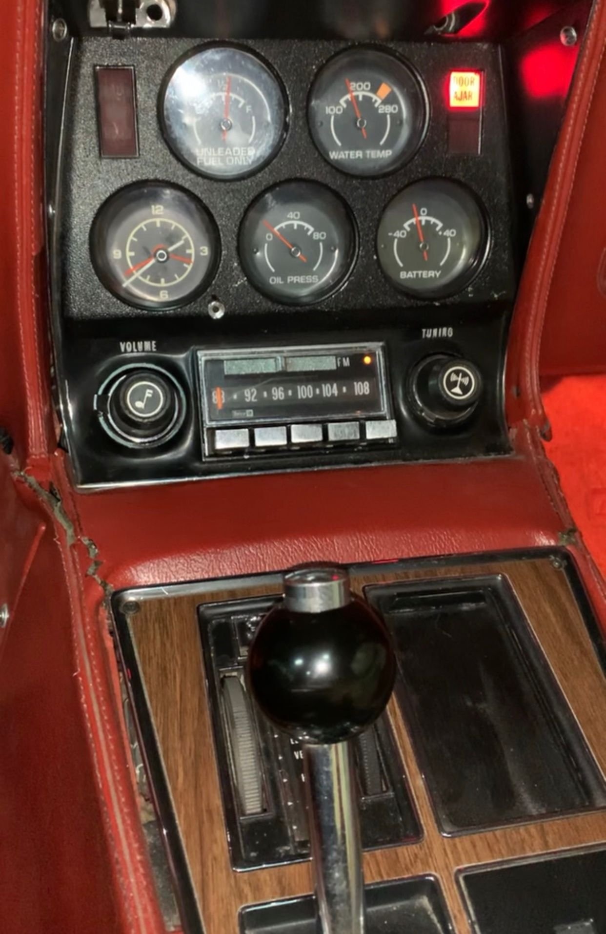

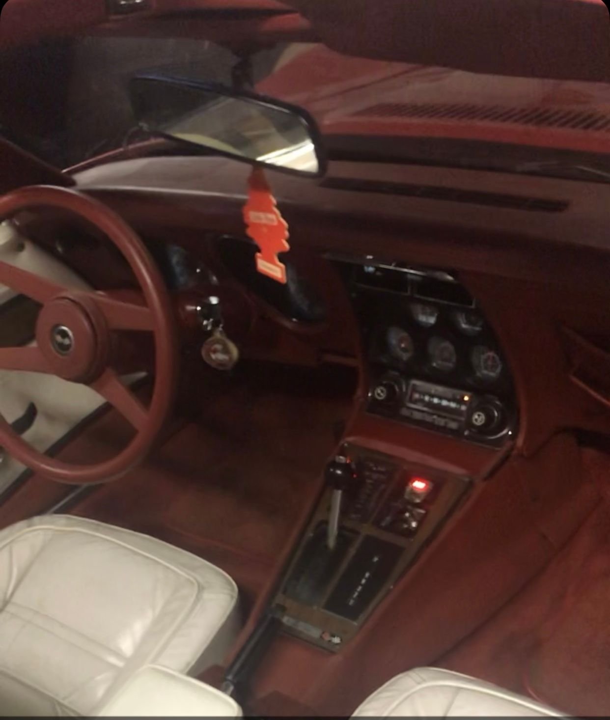

Here are some shots of the interior before. note the lower shift console being all sorts of broken.
broken and out of shape
notice the dash is sagging a bit

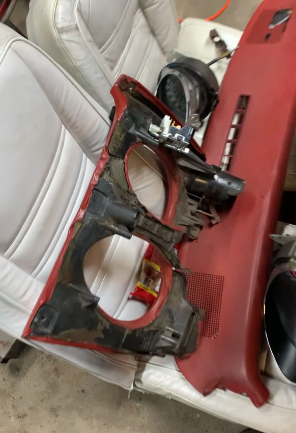

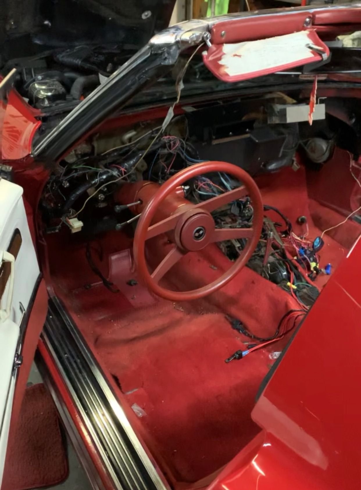

Here are some pictures after disassembly
almost all the way disassembled
the most broken piece of them all.

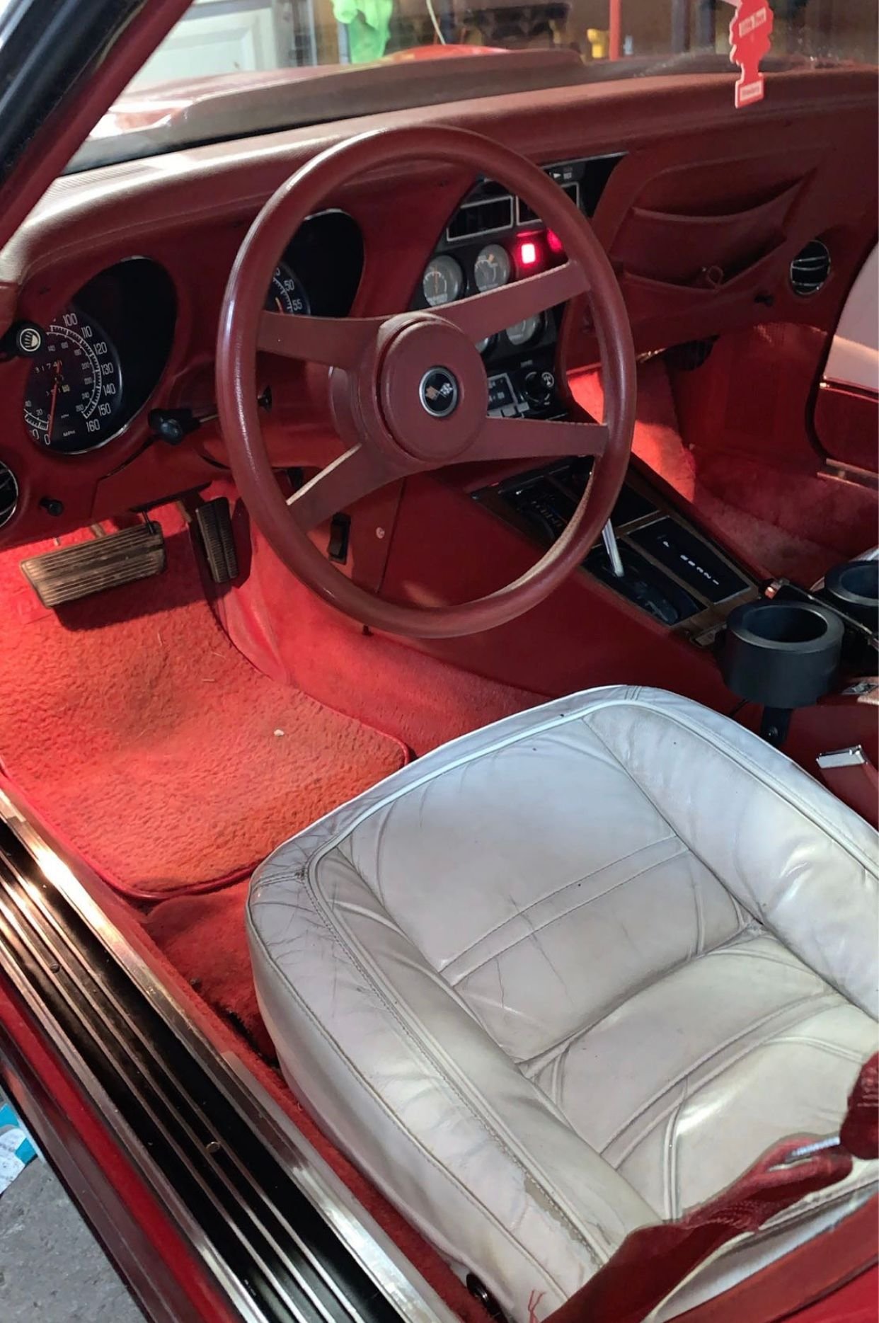

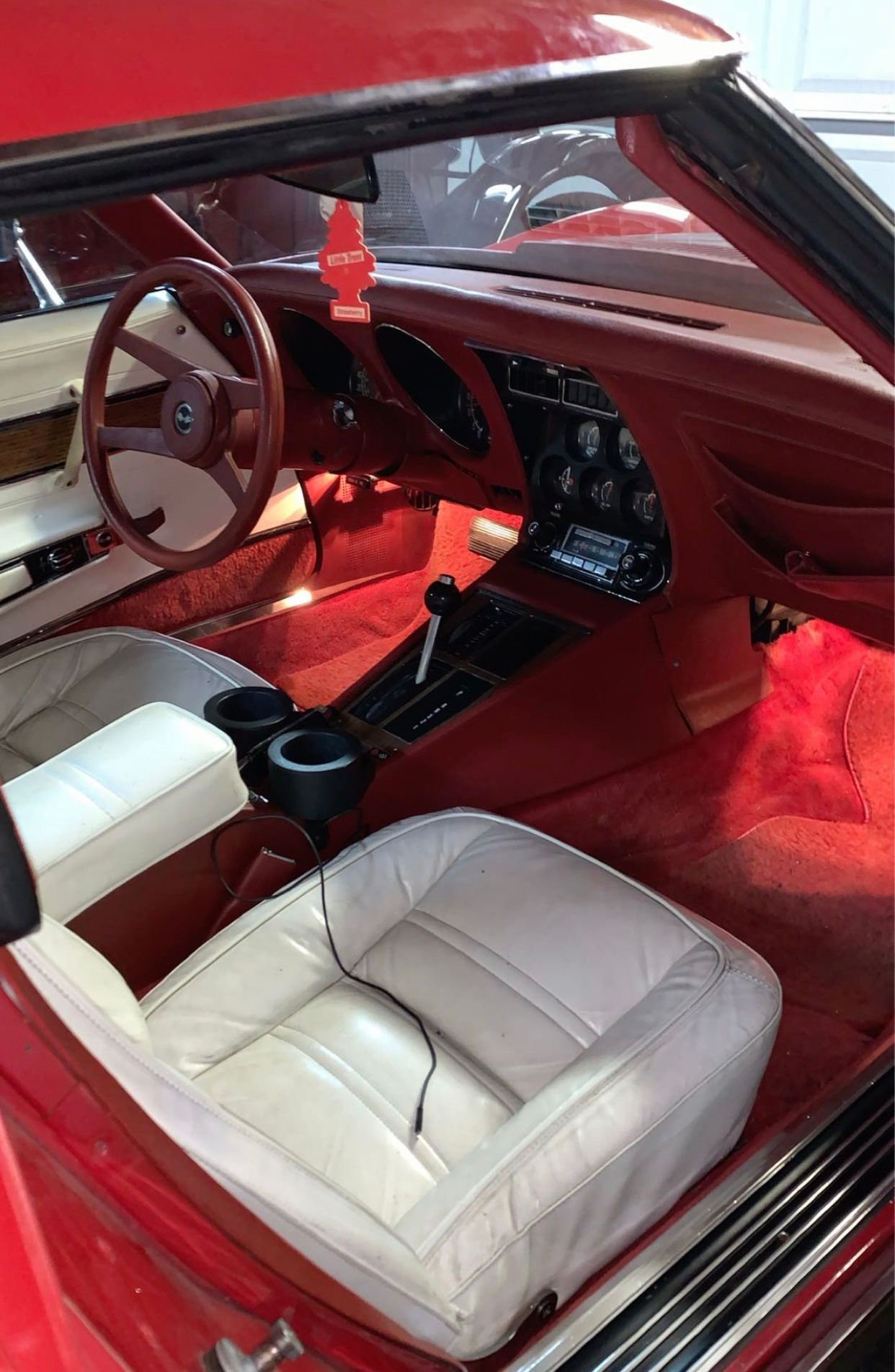

Here is my new dash in. its a sort of 50/50 mix of original and new parts but it all holds together good, and I think it looks much better

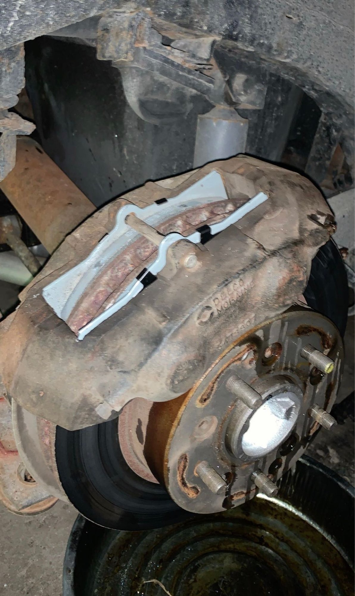

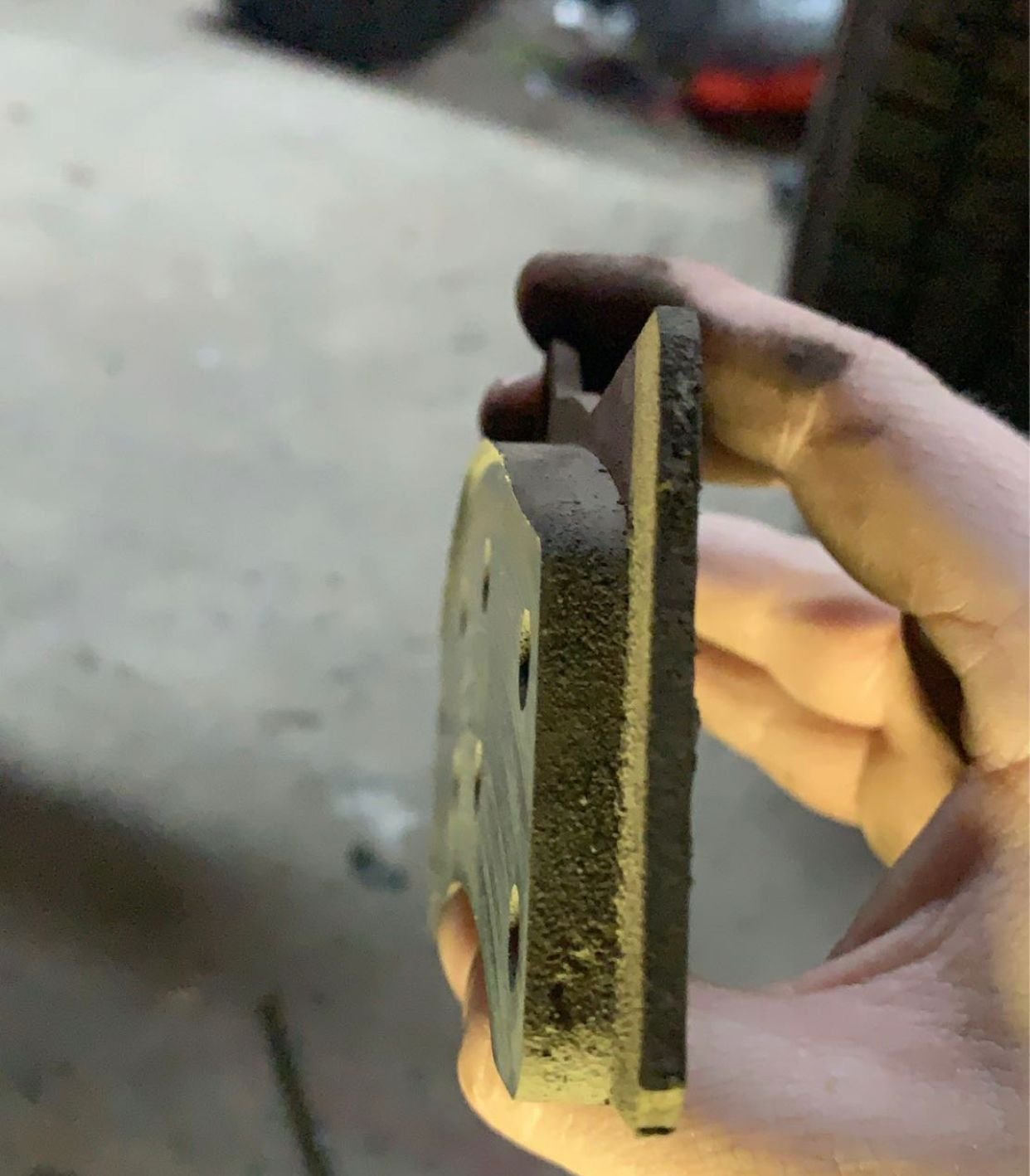

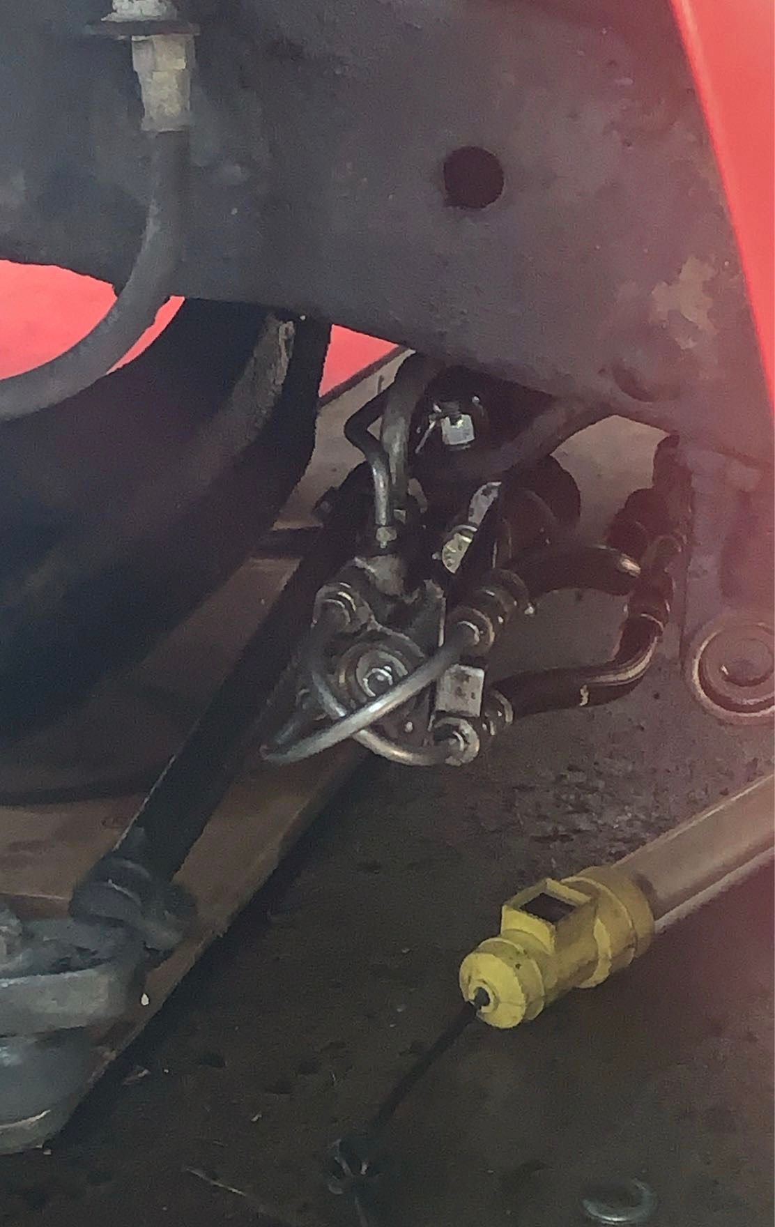

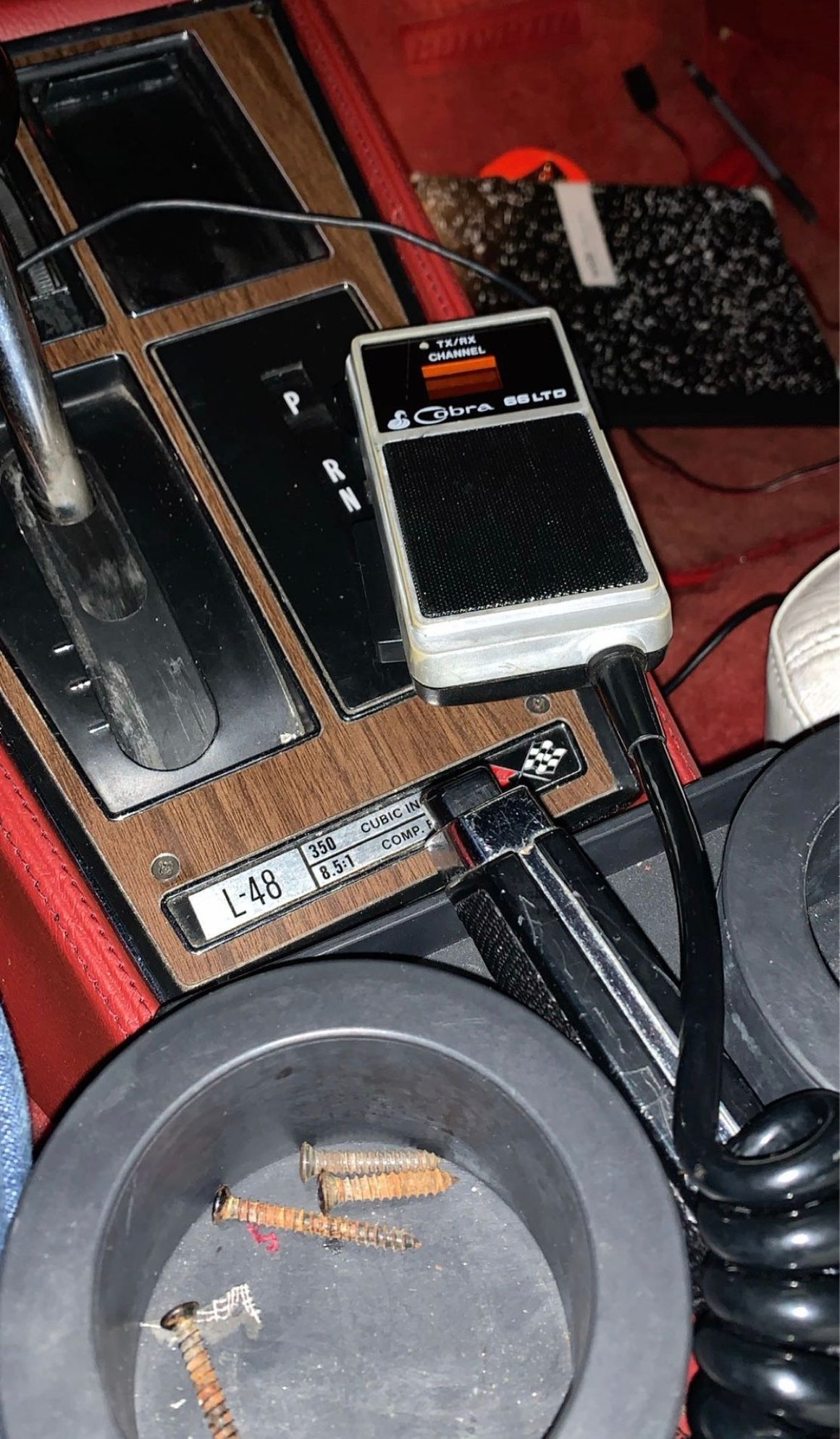

After that it was on to more mechanical things...
Period correct CB

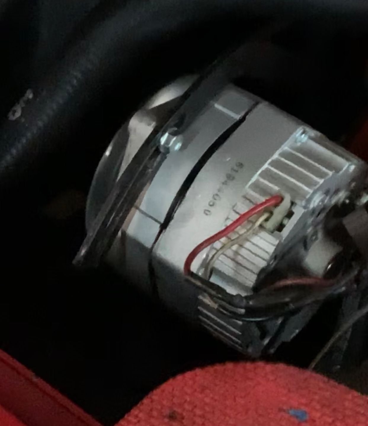

old alternator was shot, replaced that. (kept the old one)
Lots of uneven wear
changed the rear pads and bled the rear brakes, the rotors were OK.

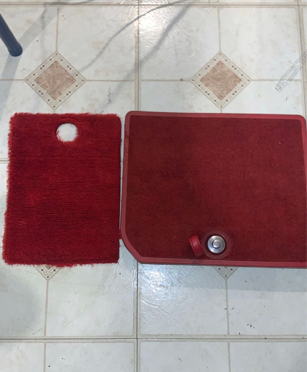

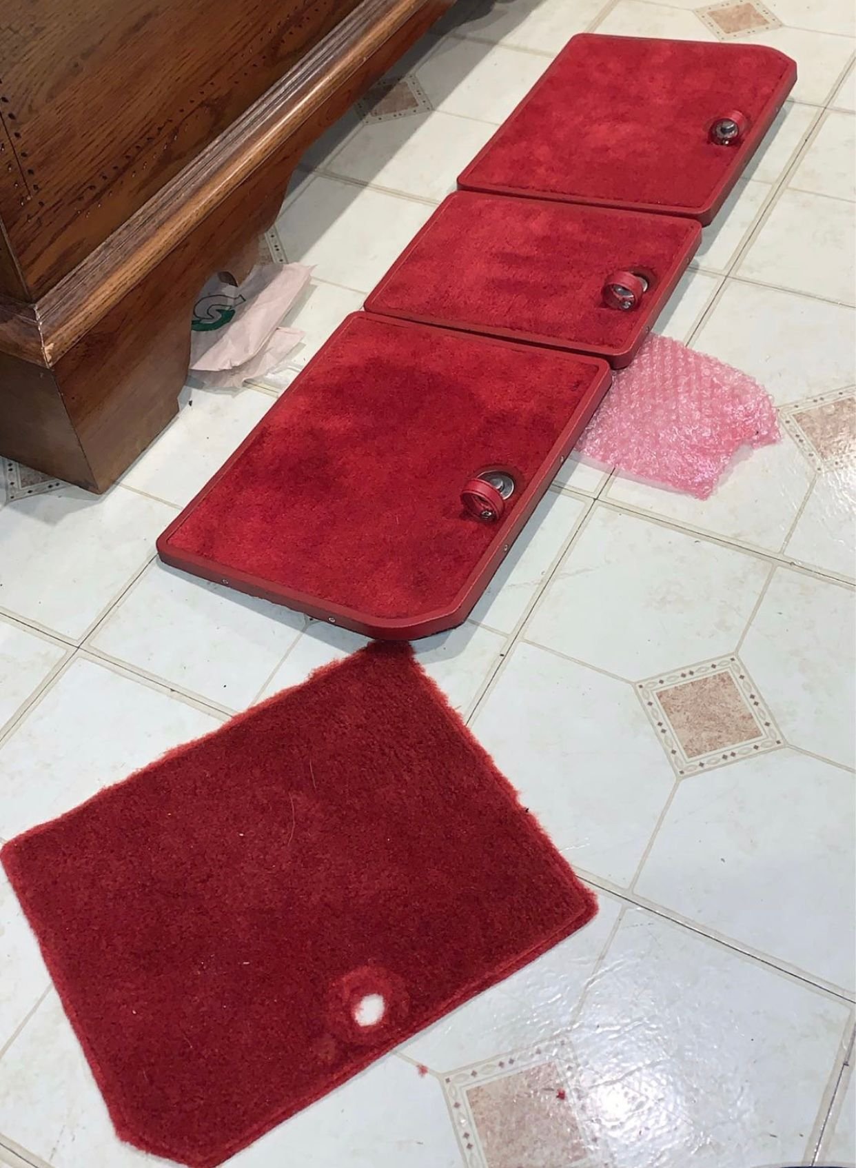

Since the dash was all fixed, and I was a little tired of doing brakes, I decided to fix all the hinges for the storage doors and clean all the carpet.
left is after
top is after. I replaced one piece of carpet.

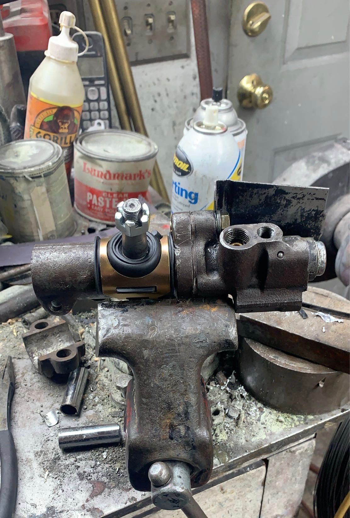

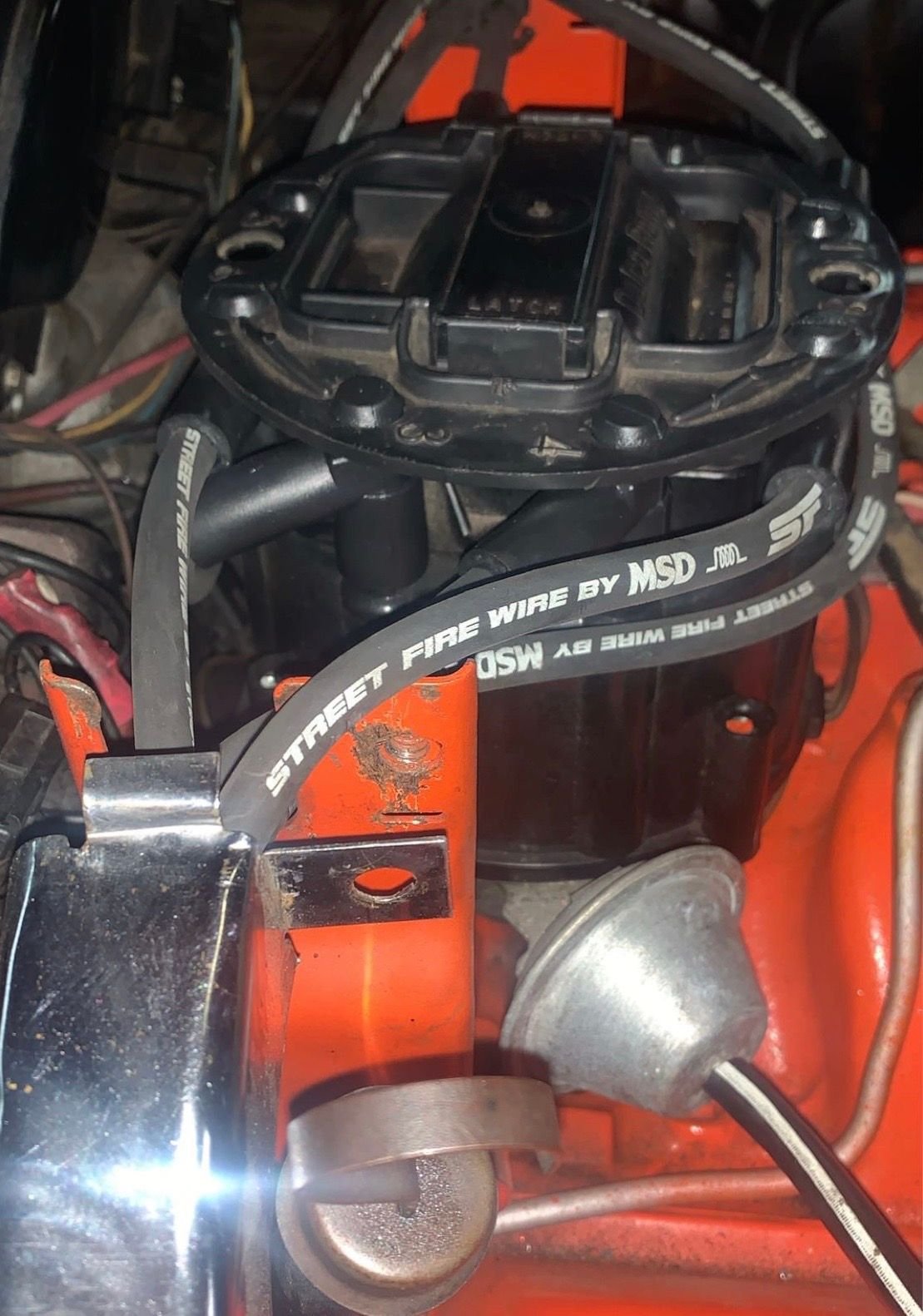

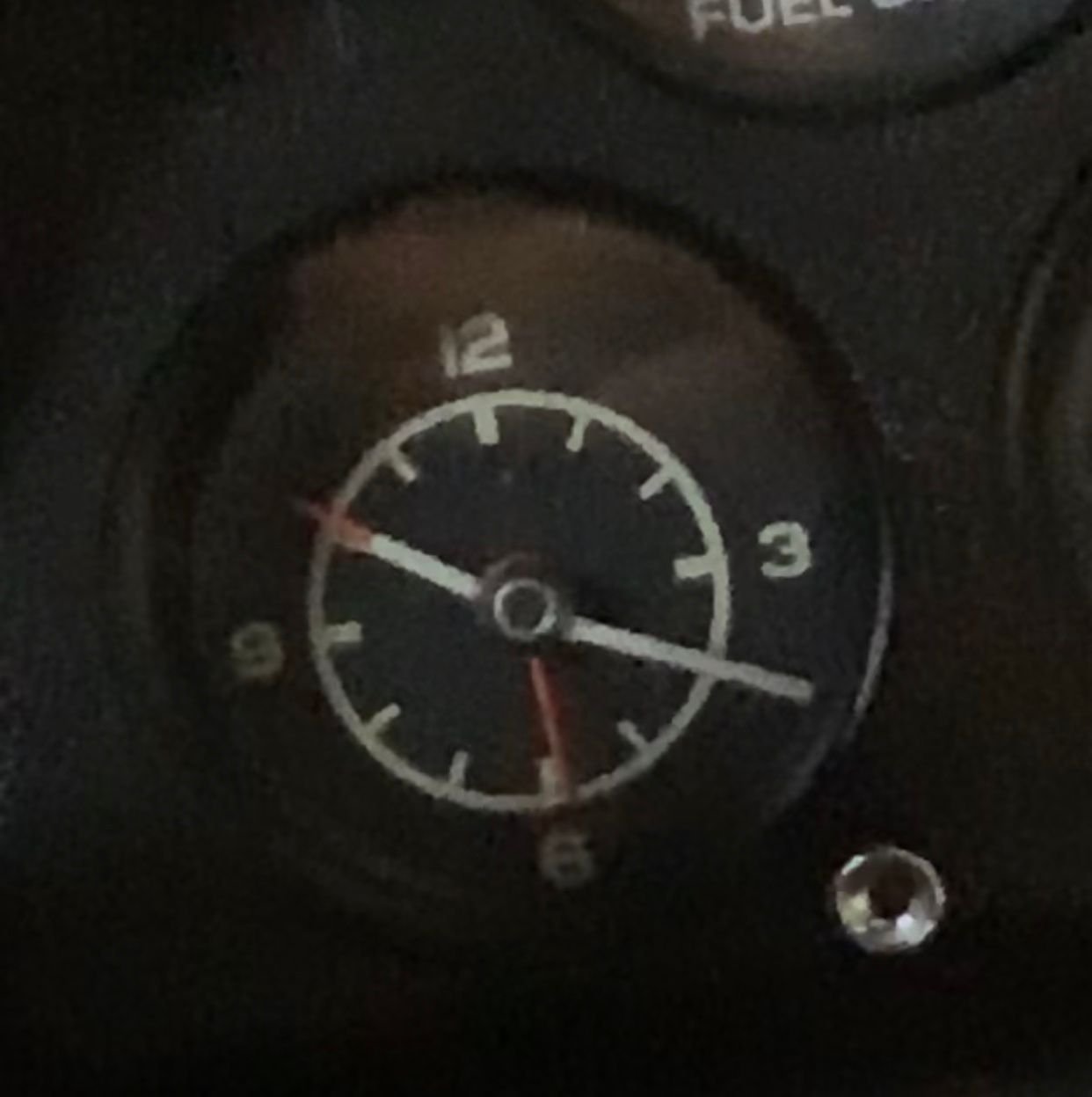

Another weekend or two, more little stuff. I replaced all the tranny cooler lines and rebuilt the power steering control valve. I greased the front suspension, and since it was beautiful up here I even washed it and drove it for a bit.
Freshly rebuilt
Installed and calibrated
New MSD wires and ACDelco spark plugs
Quartz clock movement with a custom 3D printed seconds hand that I made. (could've been glued on better)

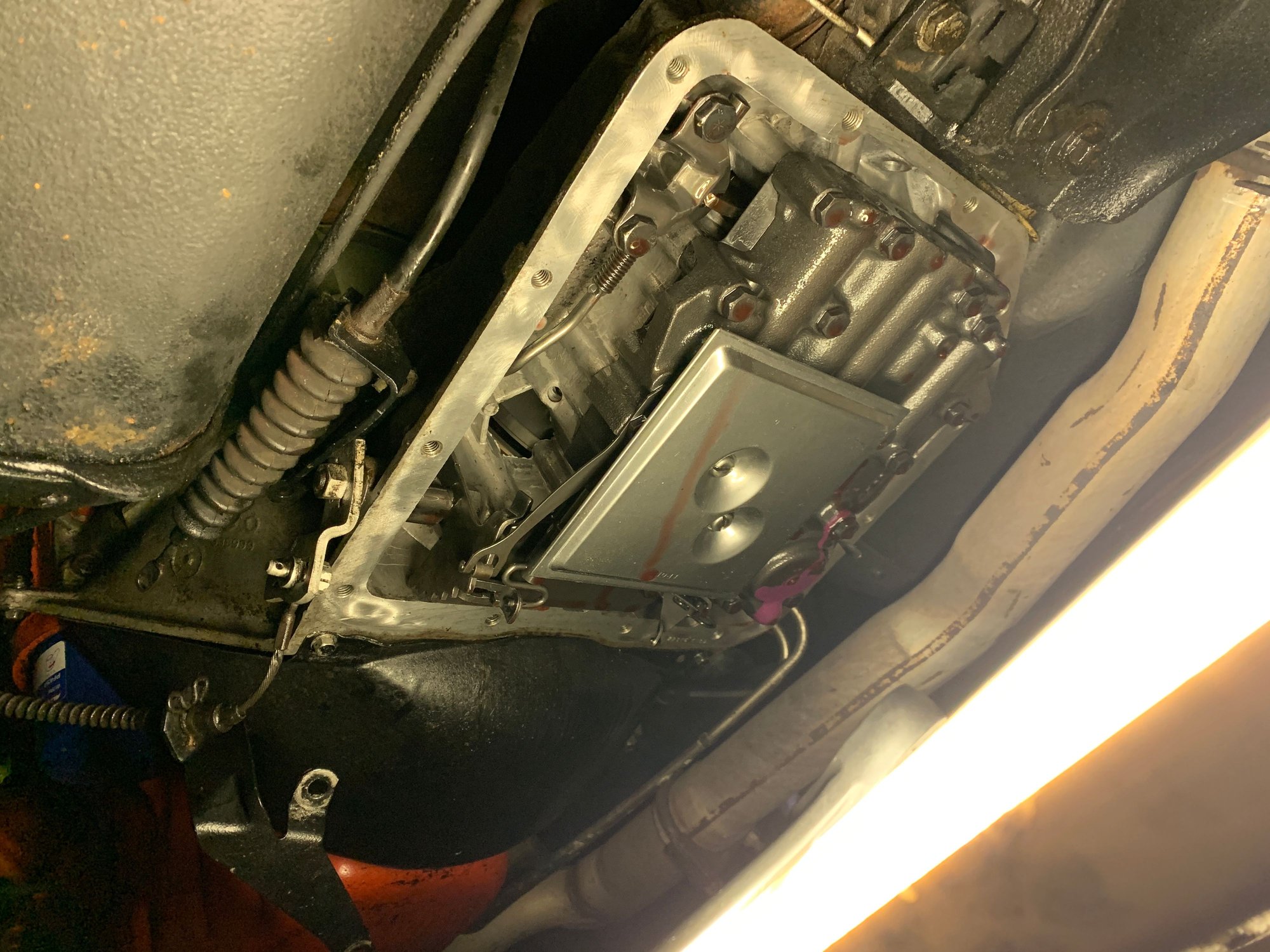

Valve body with new filter. Glad I changed 1/2 the fluid.
While I was backing into my garage after a test drive the shifter felt really loose. I could only feel the park detent and couldn't find any gears. I was able to find reverse and get it into the garage. after a quick google search I learned that the shift shaft nut can back off. the next day on my way home from school I located some ATF, a pan gasket and a filter. I was able to effect the repair and now the shifter is much tighter than before, even before it had backed off.

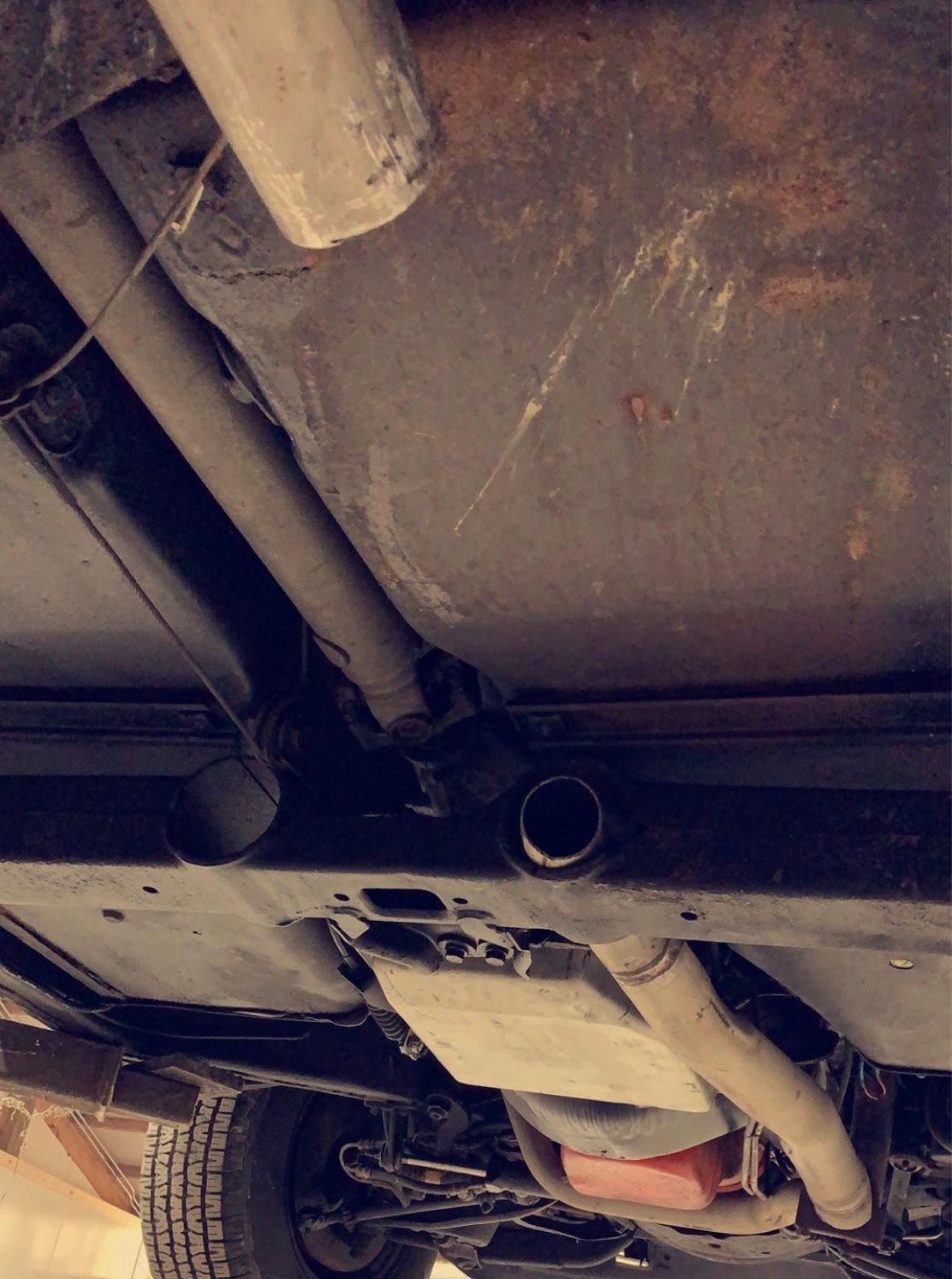

Here's the only picture of my car having its exhaust done, on a family members lift.
To My 76' Journey
Old Jun 19, 2020 | 01:43 AM
MGC/D_7601's Avatar
MGC/D_7601
Joined: Feb 2018
Posts: 254
Likes: 73
From: Chicago, Illinois
I decided to keep it as a 2-1-2 for simplicity although I am considering a set of duals in the future. Just not a right now problem.
