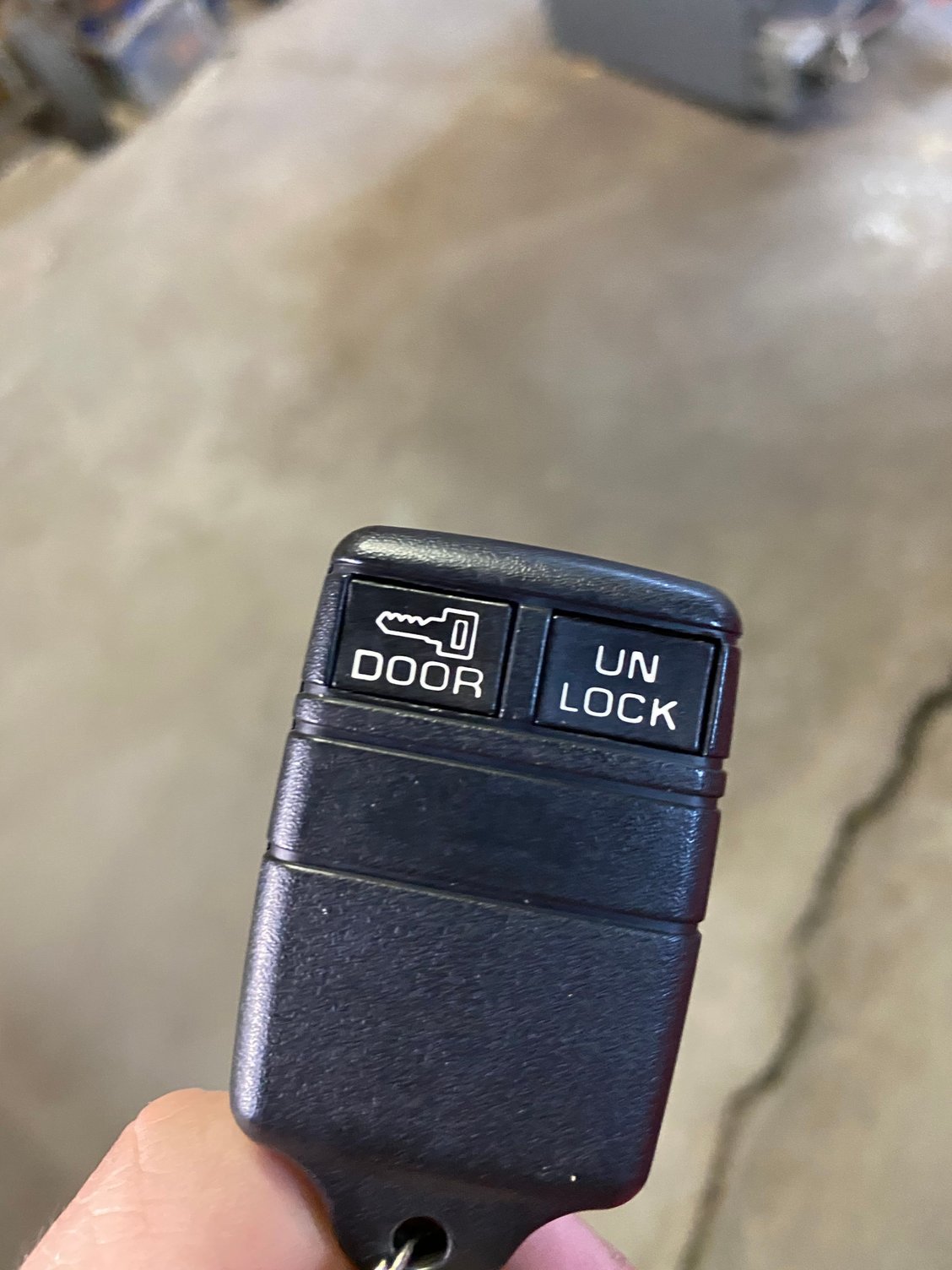

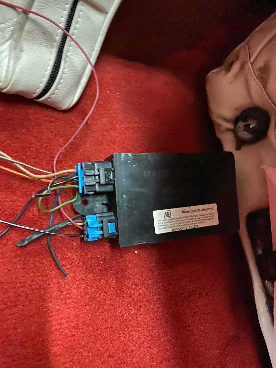

Keyless entry... a thing I always thought would be neat to have. Only 2 problems. I didn’t like any aftermarket solutions and my vette doesn’t have power locks. One night, while I was in the shop I had a breakthrough. In the 90s, when you ordered GM keyless entry, they just put a box in the lock wiring. I thought I could integrate this system into my stock C3 and I was correct, some other guys on the fiero and camaro forums have been taking the RKE boxes out of 93/95 F-bodies and putting them into their cars, but their cars also have the wiring and such. I went to the junkyard and bought a RKE from a 1996 lumina and integrated it into my corvette. I used universal lock actuators, designed some mounts for them and attached them to the lower lock rod with some clamps that I made. I wired it all up and boom! Factory 90s keyless entry with stock fobs. Looks like it came from GM cause at the end of the day, it kinda did. Here’s a video of them in action;
1993-1996 Silverado or Sierra FOB
1996 GM (Chevy Lumina) RKE
Old Nov 8, 2020 | 02:43 PM
  #43
MGC/D_7601's Avatar
MGC/D_7601
Joined: Feb 2018
Posts: 254
Likes: 73
From: Chicago, Illinois
I can go more into depth if anyone is interested on the exact circuit I used, how it works and how I got past all my headaches. Lot of information, figured I’d keep it simple for now.

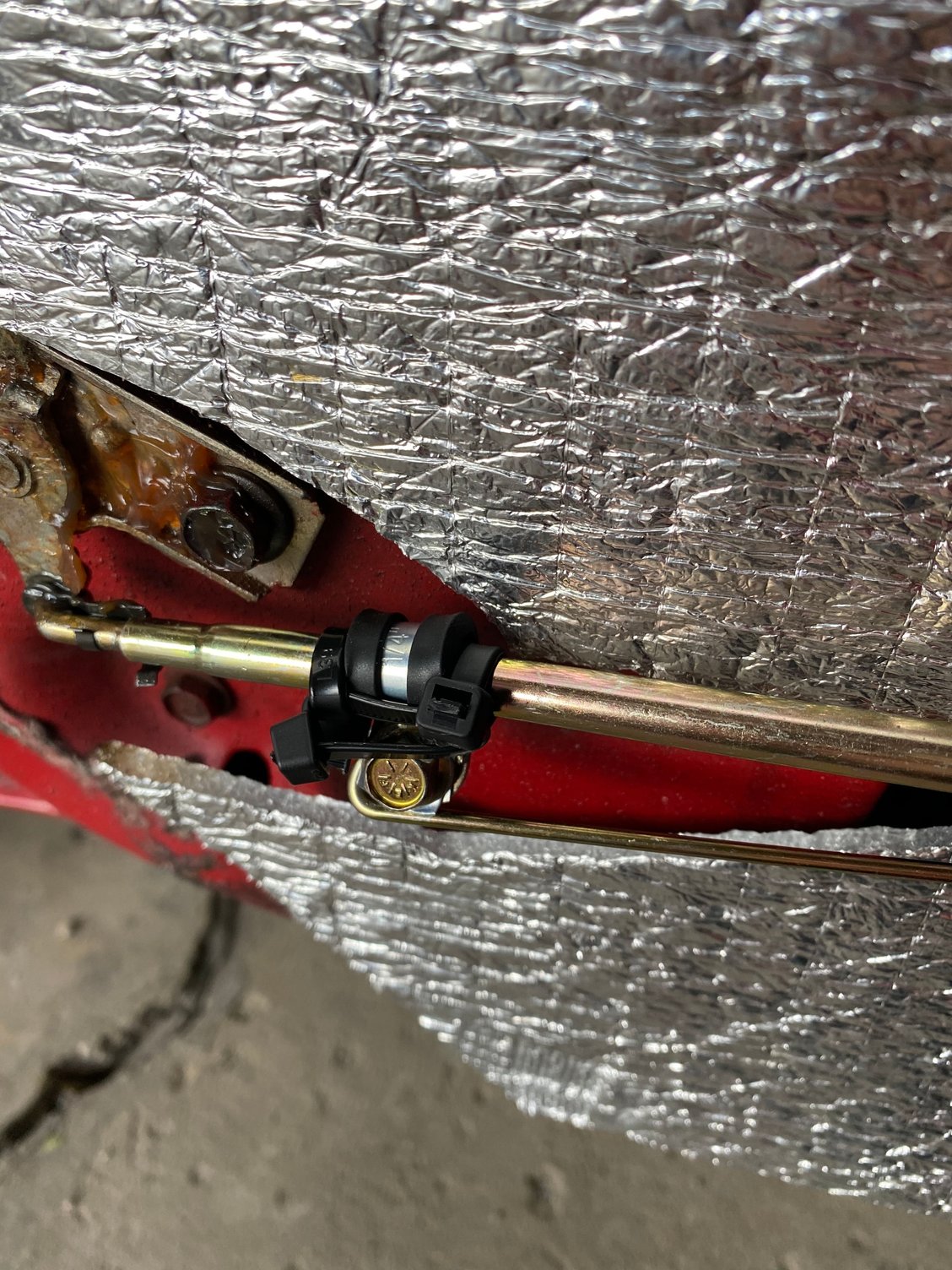

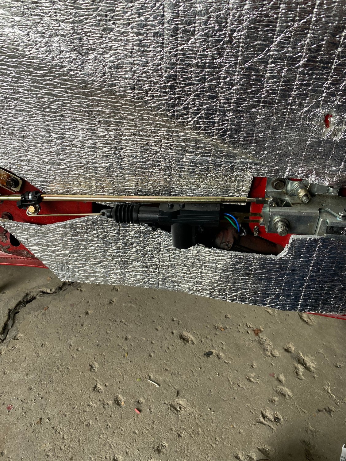

I like the keyless. Smart to use a GM dealer option. I did the same on a 67 Nova with an aftermarket receiver and homemade brackets. You should post some pictures of your brackets and the install in the door. Did you use the power window conduit to carry your wires?
Old Nov 8, 2020 | 04:18 PM
  #45
MGC/D_7601's Avatar
MGC/D_7601
Joined: Feb 2018
Posts: 254
Likes: 73
yes I did, on both sides. The wires come into the car behind the kick panels on both sides like a 78-82. I used the bracket provided with the actuators to mount them, using the bolt holes for the door handle box. The actuators are connected to the lower lock rods with a rubber harness clamp, and the harness clamp had a tendency to slide around just a little bit so I added some zip ties to keep it in line. I’m sure I’ll end up redoing it, but for a first revision, I think it’s alright. Works good and is all tucked away behind the door panel. No holes drilled

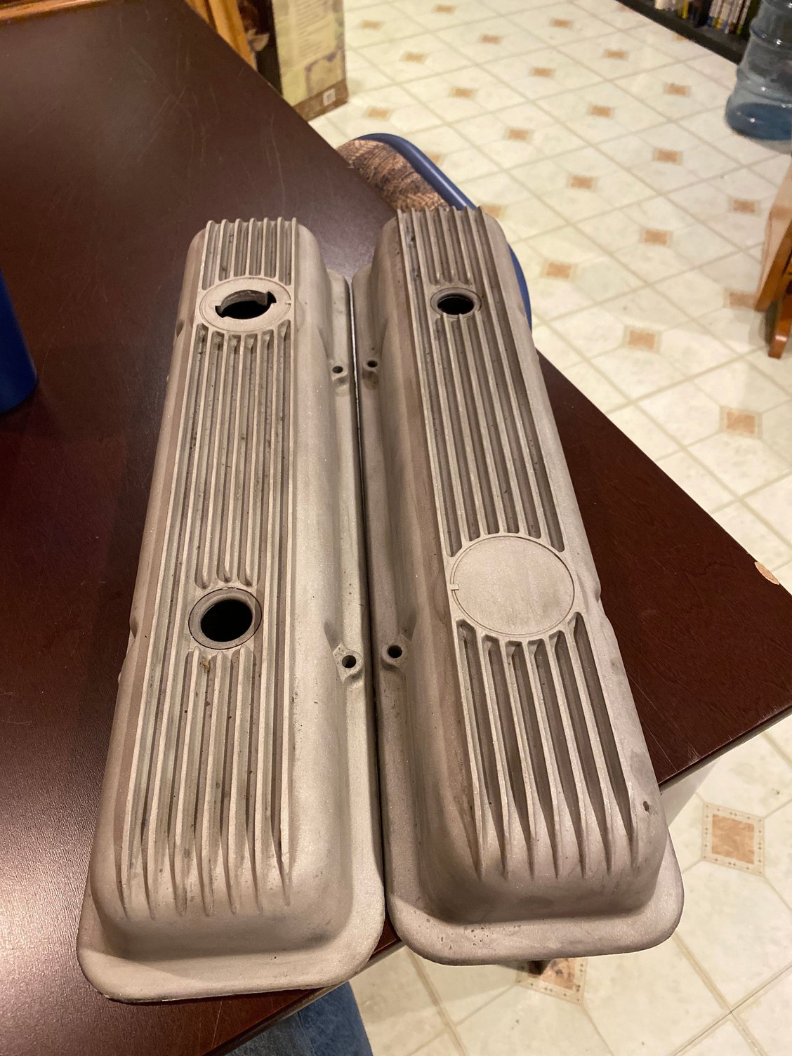

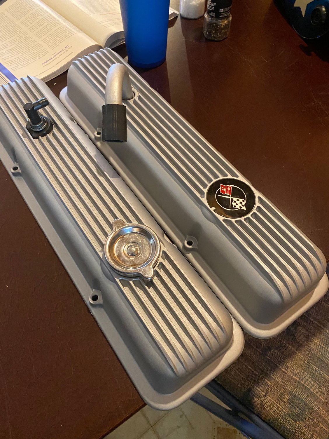

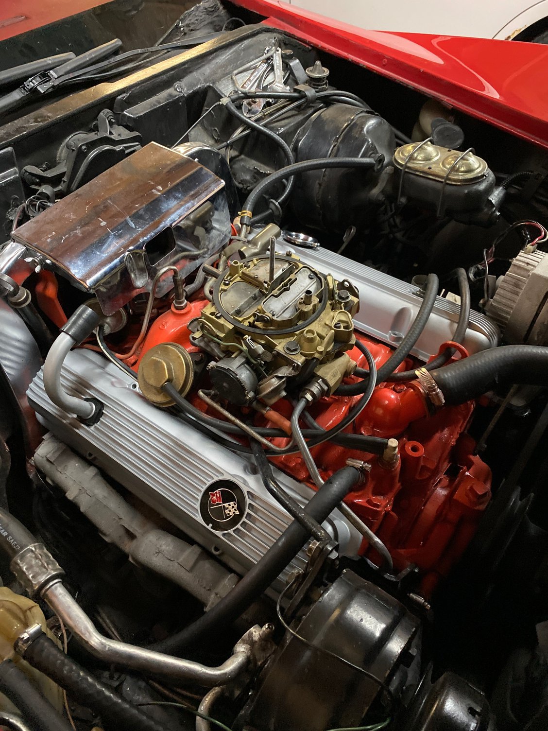

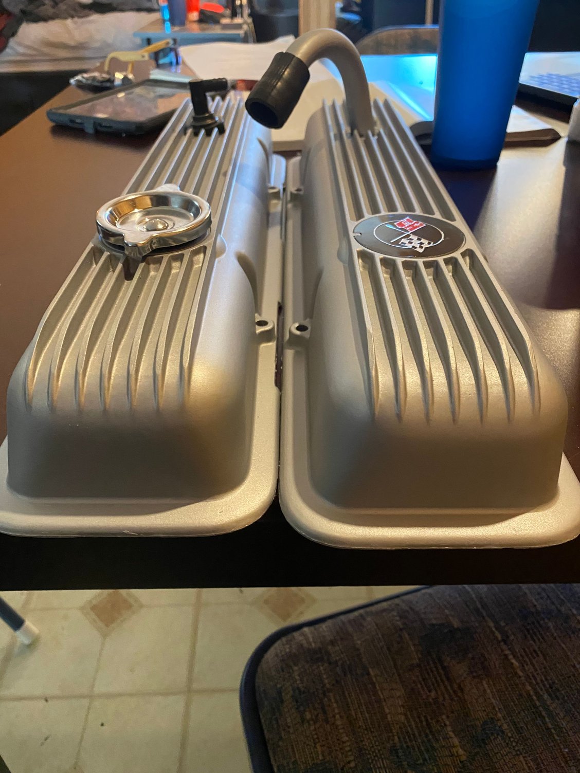

Ok, I had a little weekend project. I really like the L-82 valve covers. I think they look fantastic. I was hunting on and off for a good price on a set, but never really found much. A friend of mine's dad has a 79' L-82 4-speed that I did a tune up on and fixed a bunch of wiring issues on back in the summer. When I had worked on it, it had aftermarket Edelbrock valve covers on it, and I really didn't think too much of it because that is quite a common modification. While in my buddy's garage I spotted the original valve covers to his dad's vette, sitting on a shelf. They looked like they had seen better days but the castings were solid. I asked his dad if he was at all interested in selling them, and he kinda gave the "well... I don't know... I might put these back on someday" answer. Again, didn't think much of it, never hurts to ask. Two days later, he called me back and we worked out a trade. So, I ended up with a set of L-82 valve covers and it was time to clean them up. The paint on them was wearing away in some spots but on most of them, the paint was solid. black valve covers are correct for 78-82 but being this is a 76' it isn't. I know this is an L-48 and i'm not trying to pass it off as an L-82, but I ended up working with my AIM and figuring out exactly how everything would've been painted if this car was a real L-82. I tried some paint stripper to no avail, so I took them to work where I sand blasted them. I then primed them, finishing them off with metallic aluminum engine enamel. I painted the breather hose to silver which to my knowledge is correct for L-82 and I bought the correct longer, "M"- stamped bolts to hold them down. They are nowhere near perfect, but I think they are OK.
As received
As sandblasted
As painted
As painted (different view)

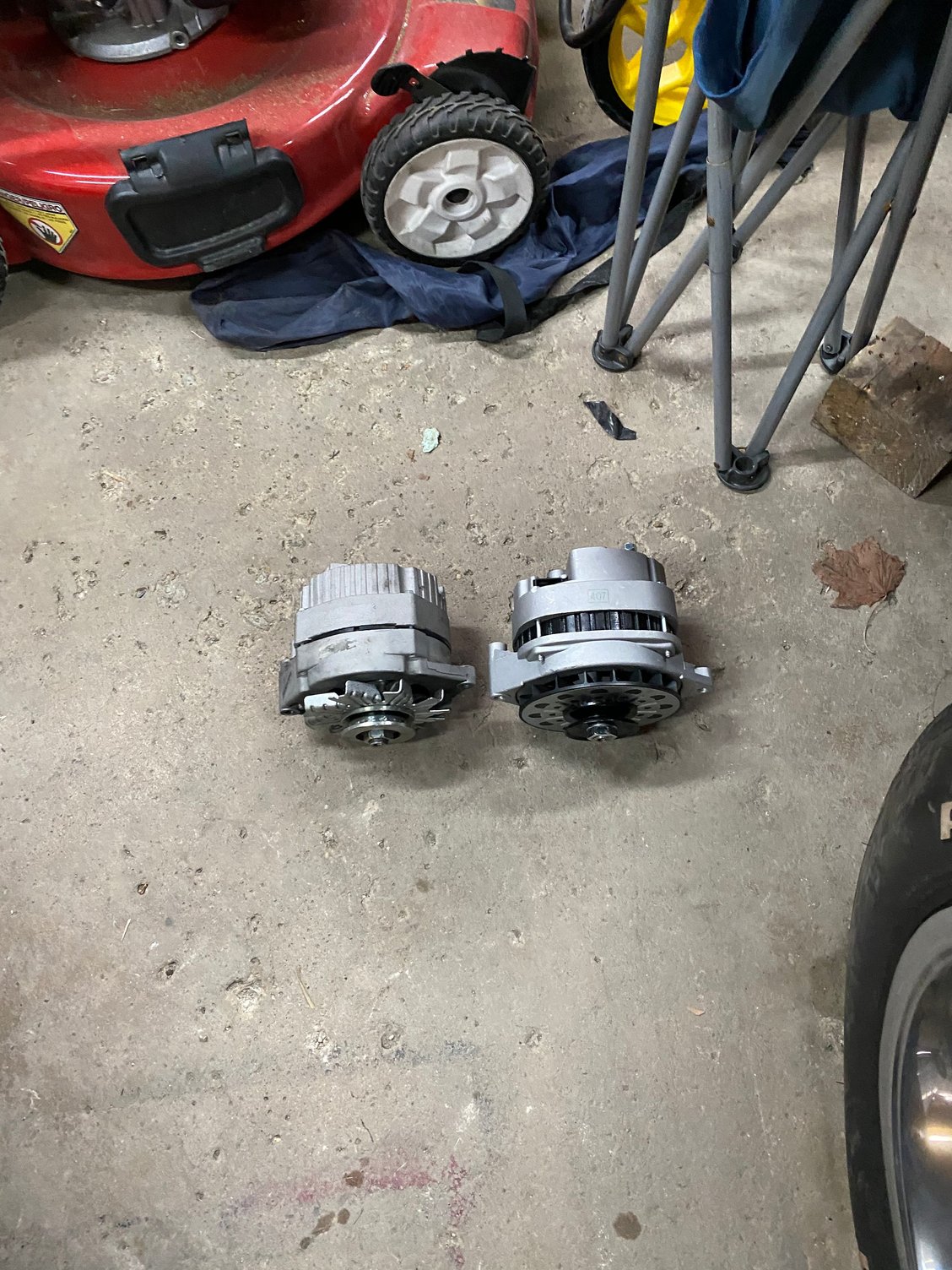

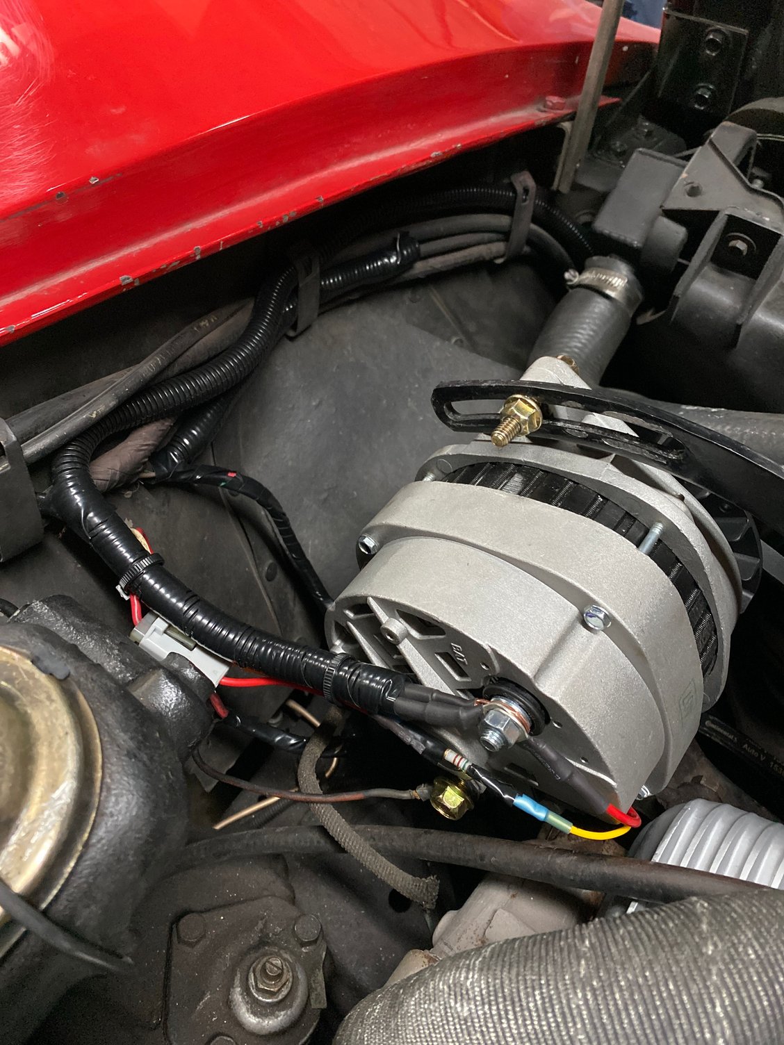

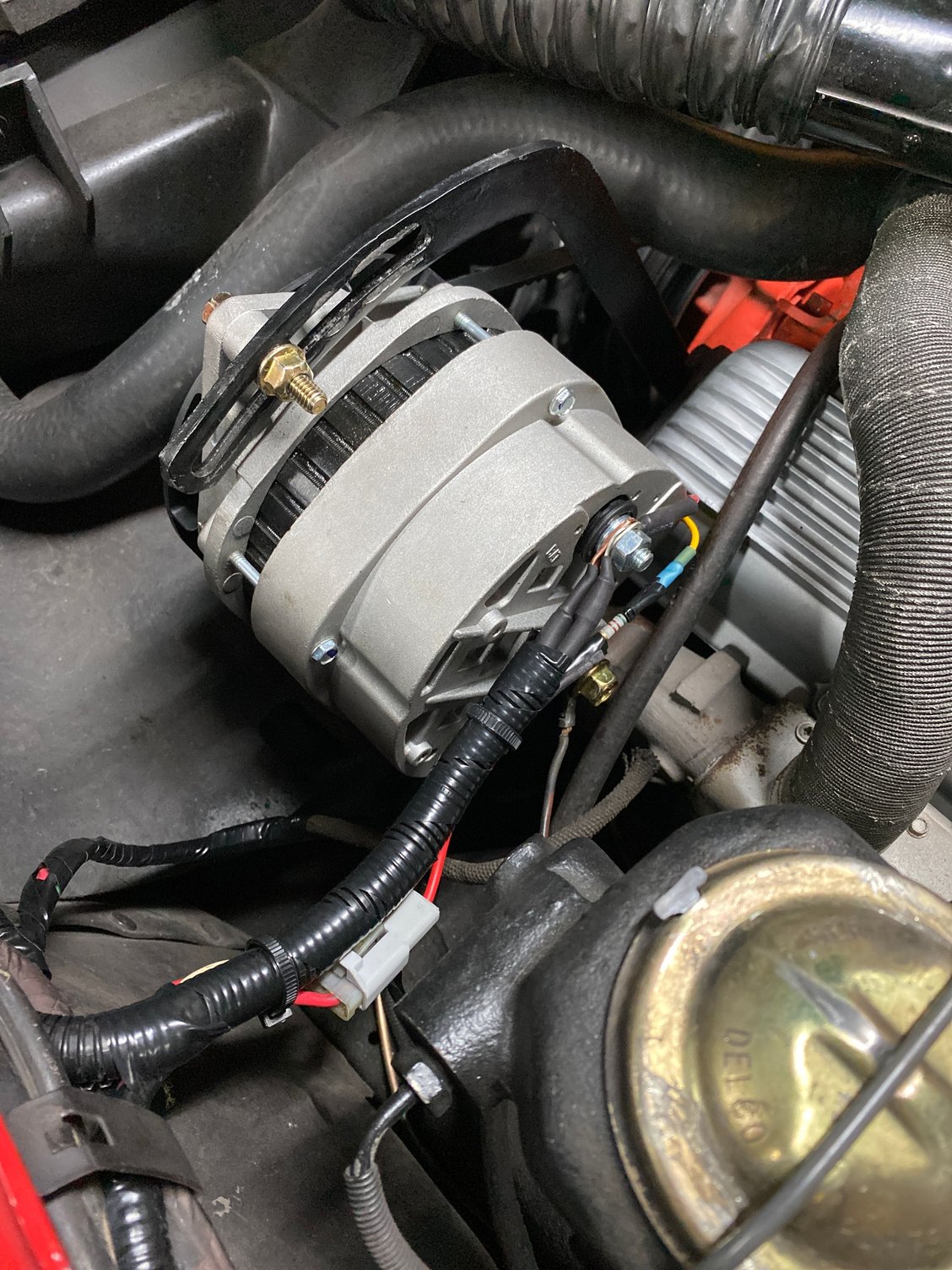

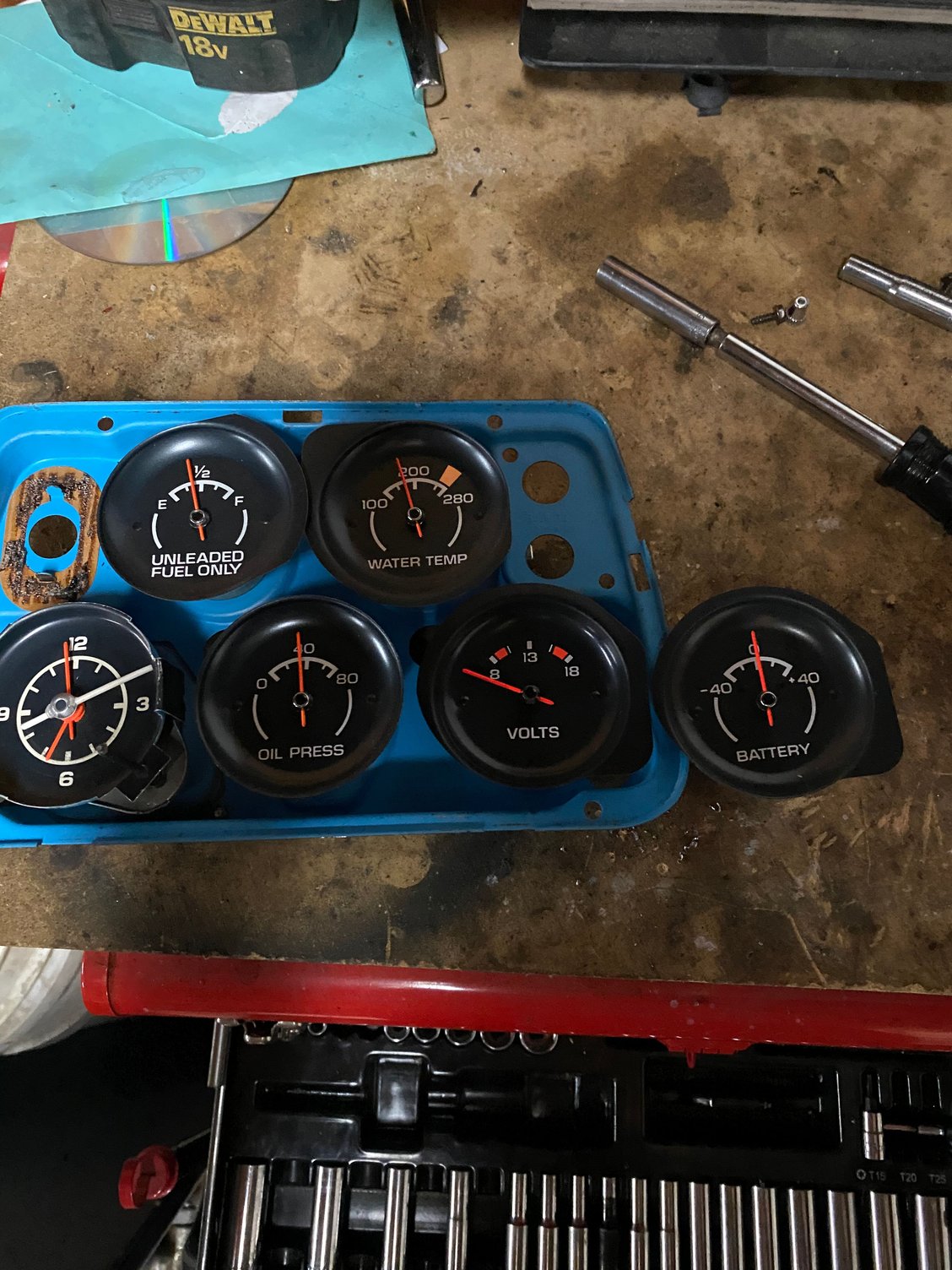

For my Christmas gift, I decided to treat myself to the glorious CS144 alternator. First, a little backstory. I have the original date stamped alternator that came on this car. It was making a whirring sound so I rebuilt it, drove maybe 500 miles and it started again so I threw the cheapest ACDelco 10SI I could find at it last year. I did that because I was not interested in modification yet. I really drive this car mostly at night. Not sure why, but I tend to just find myself driving it in the dark. The 63A alternator would barely keep up at all. When I added the C4 corvette blower motor, at a stop light in drive with my low beams and heater on, the ammeter would drop to -20. When this would happen, everything would dim, even my headlights which were on a relay setup. I was not a fan of that. I remembered that a bunch of guys on the fourm had done this swap so I went and bought an alternator. Boy was I met with a lot of issues. Differing years and wiring configurations, conflicting information, tons of different regulator and case clocking setups, you name it, I had an issue with it, except the belt. My CS144 is from a 1996 Impala SS, which most of my upgrade parts are from. I used all GM P/Ns so I could buy replacement parts for my car at any auto parts store. Anyways, when I got it all sorted out, I switched to a 1977 Voltmeter cause I deleted the ammeter with my new charging wire. There is a 6ga, 80A fused wire that will eventually have a block for my radiator fans and maybe MSD ignition. Very pleased, voltage stays rock solid at 14.7 no fuss.

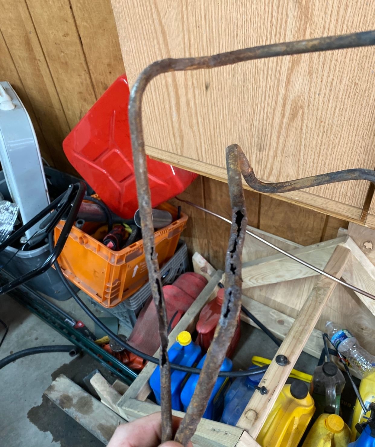

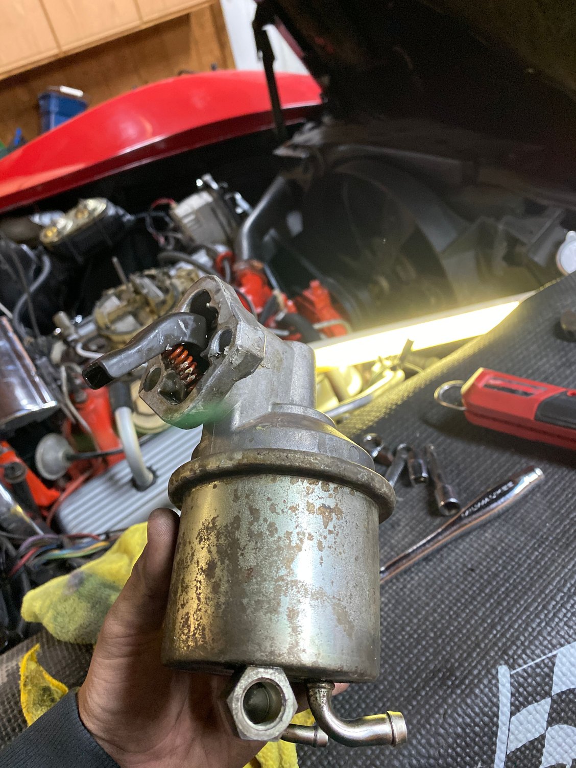

Should also mention that the vette left me stranded a few weeks ago. Was over at a buddy’s house, and on the way there the car was stumbling. My car has had a fuel starvation issue under load for a loooooong time, iirc it started in april? Doesnt matter. I thought it was the fuel lines letting air in. The lines were shot so I replaced those with all new nicopp and fuel rated hose. The stuff that was in the car was an absolute nightmare. Non-fuel rated hose jammed onto rusty lines, terrible. I finally replaced them in November, so I thought the starving was fixed. Turns out, I was wrong. It had been stumbling worse than usual, but I kinda chocked it up to the low ambient temps and did my best to take it easy. Should probably mention that I was forced to drive the vette cause I broke a wheel on my truck. Anywho, I was driving home, accelerated from a stop sign, and the car died. My first reaction was that it flooded, so I cranked it, nothing. I coasted to a side street where I pulled the air cleaner off, no gas. It was about 1 am at this point. luckily, I wasnt far from home, so I called a close friend and we pushed the vette in front of a relative’s house for the night. I hitched a ride home, and the next thing I knew it was 6:30 and I was buying a fuel pump. I put an electric pump on the car in the middle of the street, drove the car home to my shop, jacked it up and swapped out the fuel pump. The previous pump was four years old, and I know that because I was the one who put it in. Kinda funny, I put it in around december of 16’ so it lasted four years on the dot. Whatever, pump is replaced and the stumble is gone! Guess it was going out for a long time. Only made it 3 1/2 years reliably​​​​​​​

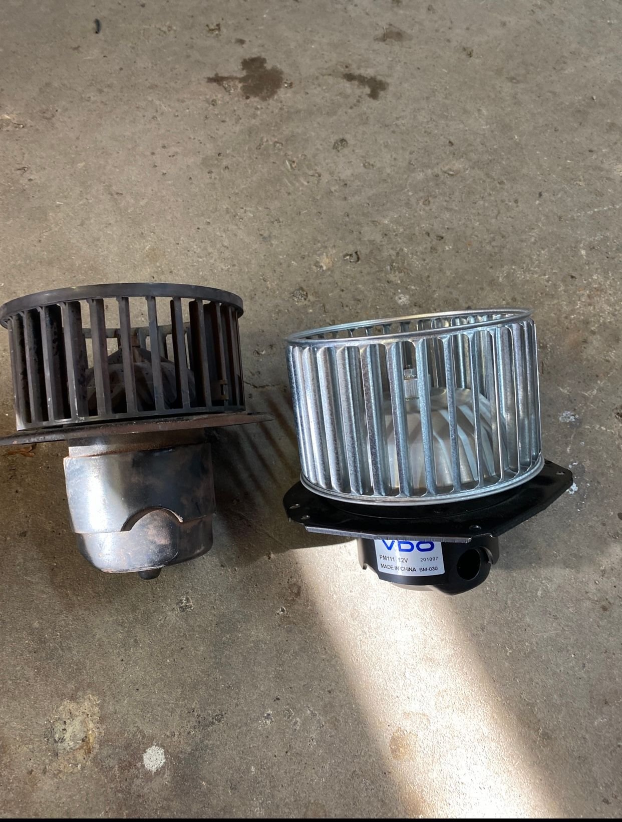

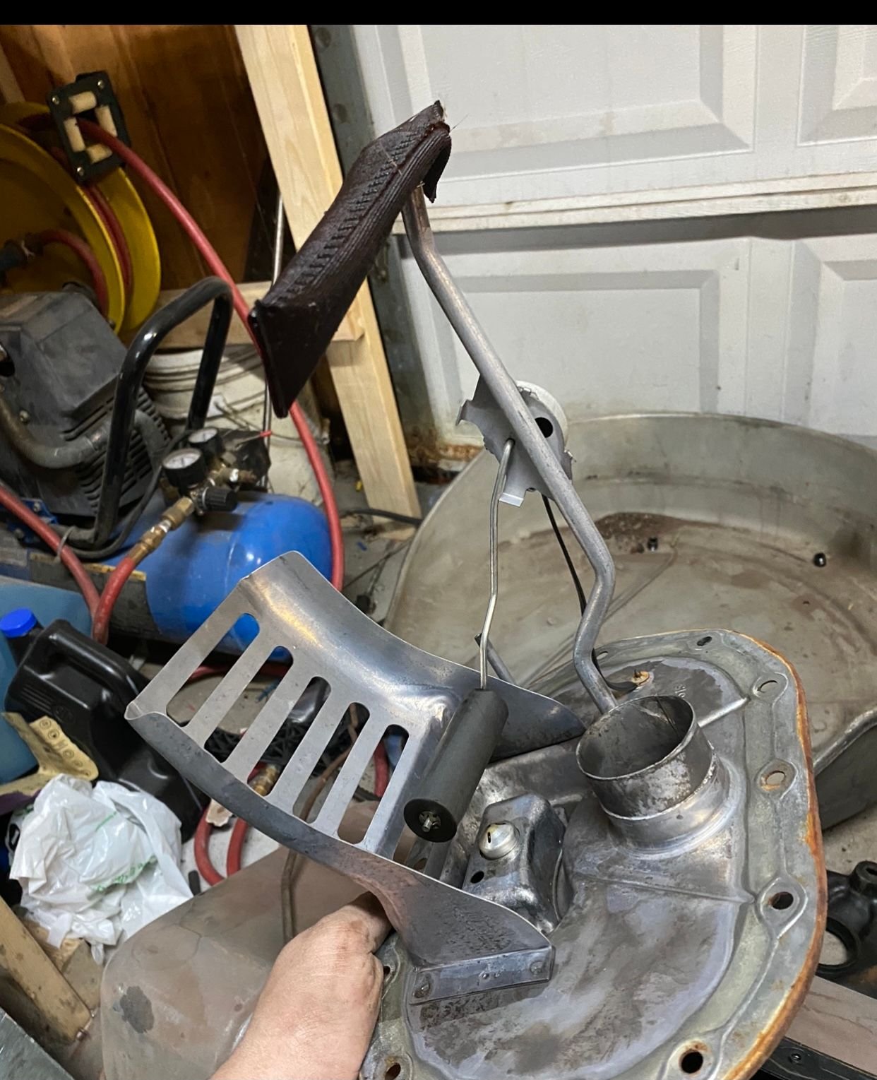

Back in november, I decided I wanted the C4 blower motor and cage cause I just wasn't happy with the C3’s output. I was surfing rock auto one night and stumbled upon a wholesale close out, and they were selling 85’ corvette blower motors for 3$ flat. I bought one cause I figured the C3 one would burn out, and then I’d have the C4 as a replacement. Well, wouldn't you know it, exactly 4 days later the cabin of my car smelled like burning crayons and my blower motor quit. I 3D modeled and printed a spacer on my 3D printer for the longer C4 blower motor but when I tried to install it, I realized that you actually need the 86-96 blower motor not the 84-85. Turns out, the right part was also on sale, so no big loss. Added a 10ga ground wire as recommended here on the CF. Very very pleased.
