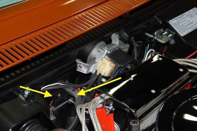

I haven't used the wipers on my '71 since the early 80's. A couple of years ago I checked to see if they worked and nothing. The wiper door opened but no wiper operation. I got out the volt meter and checked for power at the wiper limit switch and nothing was present. I checked the override switch under the dash, 12V was there but not on the other side. It turned out that the contacts inside the switch were dirty. Cleaned the contacts and the wipers worked.
I would start at the wiper limit switch to see if it is closing when the wiper door opens and also check for 12v.

Look at your wiper limit switch with the wiper door raised. Is the switch button getting pushed in when the wiper door raises up?
Set up your volt meter to read 12 or more dc volts. If you unplug the connector at the wiper limit switch, you can check for battery voltage coming from the wiper override switch. That's how I determined that my override switch was defective. If you have battery voltage, then your supply voltage at the override switch is good. If you turn the override switch counter clockwise you should lose voltage at the wiper limit switch.

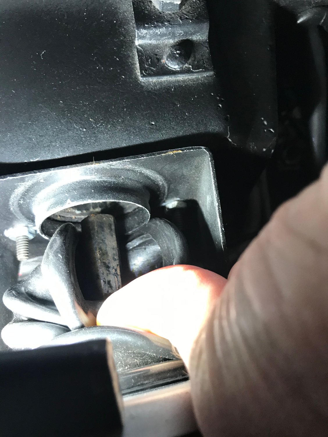

I did notice the rubber plug that goes in the actuator is very loose and comes out super easy. would this possibly be causing a vacuum leak by not sealing tight?

yes it could be. YOu could coat the sealing edge with a thin coat of vaseline or plumbers silicone to help it seal and see if that solves it. You could also check the plunger length setting to see if it vibrated loose and just isnt getting the same throw

is this the adjustment you see when you pull back the rubber on the actuator? if so mine turns freely with my fingers. should there be a lock nut? would this give more movement where the plunger hits the wiper limit switch?

yes there should be a locking nut. On there and on the little leg that is moved by the wiper door that touches the switch. You should adjust the wiper door actuator so that when closed, the actuator arm has traveled its entire length to the closed position. Then tighten and lock it. When openned it should push the door open as far as it will travel, then adjust the foot that actually touches the switch so the switch is all the way in and lock that in place. You should be good to go

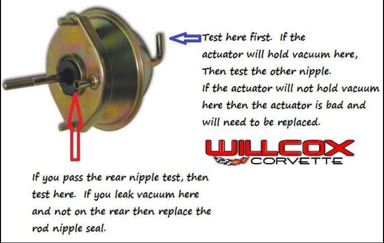

Here's a link to Willcox's actuator adjustment:
http://repairs.willcoxcorvette.com/1...-instructions/

Test your vacuum actuator. I was able to test mine with a short piece of hose connected to the front and rear nipples. Sucking on the hose on the rear nipple will open the wiper door and operate the wiper limit switch. I could hear the switch click and the rod was fully against it.
Vacuum on the front nipple closes the wiper door.

When you re-installed the adjustment nut, did you start from scratch and screw it on at both ends. How does the adjustment compare to the Willcox diagram? I would check the actuator to see if it is leaking, or a vacuum leak somewhere in the circuit.
You need to verify that the actuator is working correctly and not leaking at the rod seal or diaphragm. Vacuum on the green striped hose opens the wiper door, vacuum on the red striped hose closes the wiper door.
