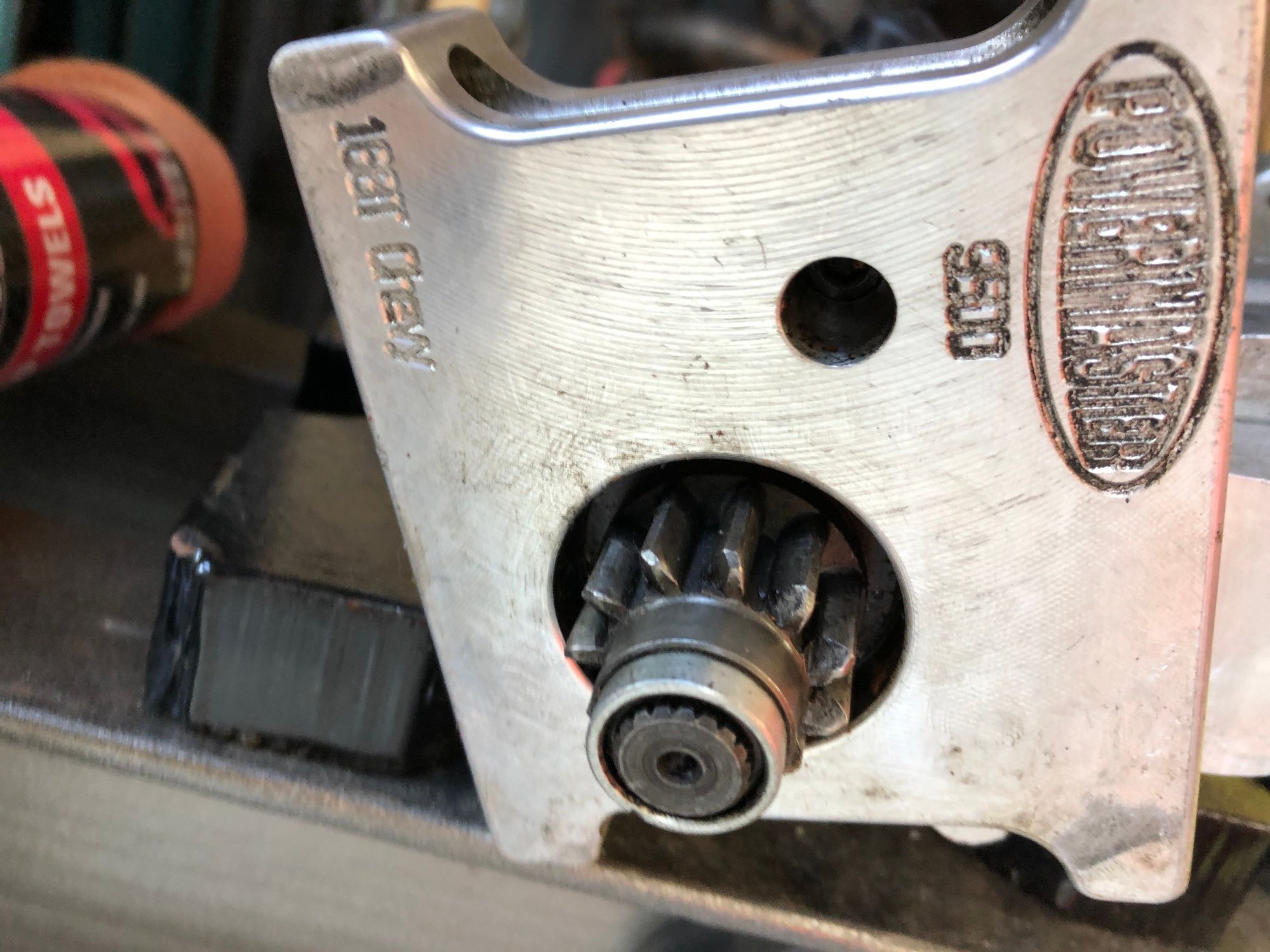

I’ve heard people say that a 90’s something model Chevy truck has a small hi torque starter. Can anyone shed some light on this. I have a PM high torque now and it is suspect to a intermittent problem I’m having.

Your 75 has HEI dist, right ?
What size flywheel/flexplate? 153T or 168T
is your current hiT one of those that is clockable and has a rectangular end block with a gear sticking out the end of block?
-add- Yes, they're right about PU starter ... answer the Qs and I give correct pn & source ... cheeep.
HEI and everything else in pic’s 168T

Originally Posted by Gold Dragon
I referenced a 98 Chevy Silverado and got the correct GM mini starter for my Big Block. Will work for a SB as well. Make sure you get the correct GM starter Bolts. They are available at any GM parts house for about 10 bucks. Dont skip the new bolts or the starter nose may crack.
HEI, 168T
this one https://www.dbelectrical.com/product...sdr0019-l.html
just so happens dragon's right ... but if yours had 153T it's a different pn
rather than the starter (?powermaster) you have, I prefer minis that have a "Nose" that supports end of gearshaft,

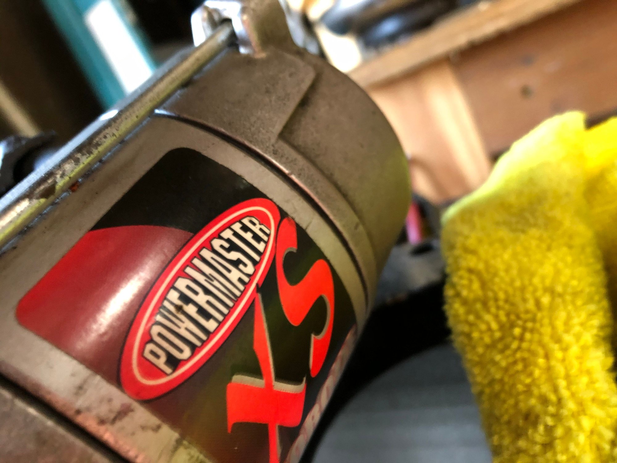

Sometimes won’t start Looks to be getting power just kinda locks. Pull the wires off reattach it starts. I’ve cleaned all connections and dielectric greased. Also cleaned up main ground for battery.

Perhaps you take starter to a local, reputable, experience auto electric shop which rebuilds starters & alternators. A good shop can test bench test it and quickly diagnose problem. May be as simple as a bad connection inside solenoid to a lug?
Good likelihood they can fix it for small money. If so, you can run it or keep it as a spare. Either way, a starter like I recommend above should do you proud.
FWIW, perhaps your Powermaster 9500 is based on a Denso brand ? If so, you might mention that if you call around different shops.

I called and he said he wasn’t familiar with that brand but he would look at it. For 50 bucks I’ll probably buy and then see about having it checked. Powermaster offers a rebuild service but I don’t want the car down for that long right now.
